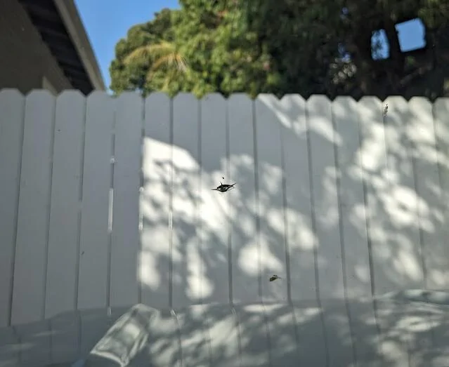

Survived 6,800 miles until this trip down I-5. PING. Wonder if the windshield crack resin will help seal and stop it from growing.
No change driving back through 108 degree heat.

Many have reported glass dings rapidly develop into cracks. It's not necessarily the heat that drives crack propagation, but more likely rapid temperature change.
Most insurance companies will pay for a repair outright--no deductible. I would advise getting it repaired sooner rather than later.

Yes. Call your insurance company.

As Mark says, get it filled. Normally free with no deductible. Reduces the risk of the Chico turning into a crack and then spreading.

A good friend of mine owns a windshield repair and replacement business. His advice to me was to get any chips repaired ASAP to keep dirt and other contaminants out of the crevices. The dirt makes it more likely that the repair will be less noticeable after it’s done. He says to especially avoid running the wiper’s across the chip because that presses the junk right into the chip. In my experience with several vehicles, he’s correct.

I had a big bullseye in the center of the windshield on my RAM 2500. I went to AutoZone and bought a windshield repair kit. It cost about 15 dollars and worked perfectly.

yes, I paid about $19 at O'Reilly's. Unfortunately, when "pressurizing" the sealant, it sprung a leak, so the best I could do was to seal the chip; it did not flow fully into it, but it's sealed.
