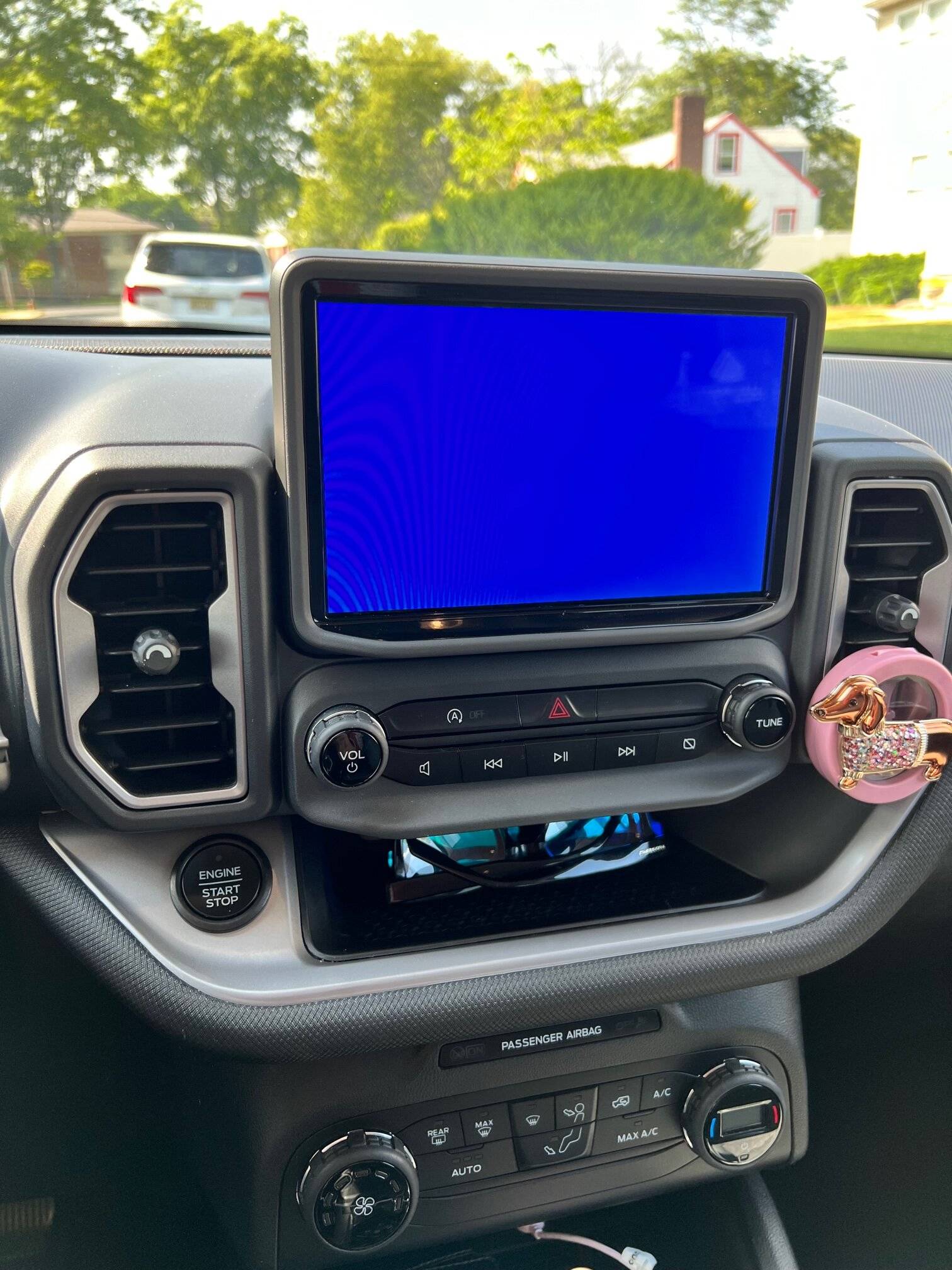

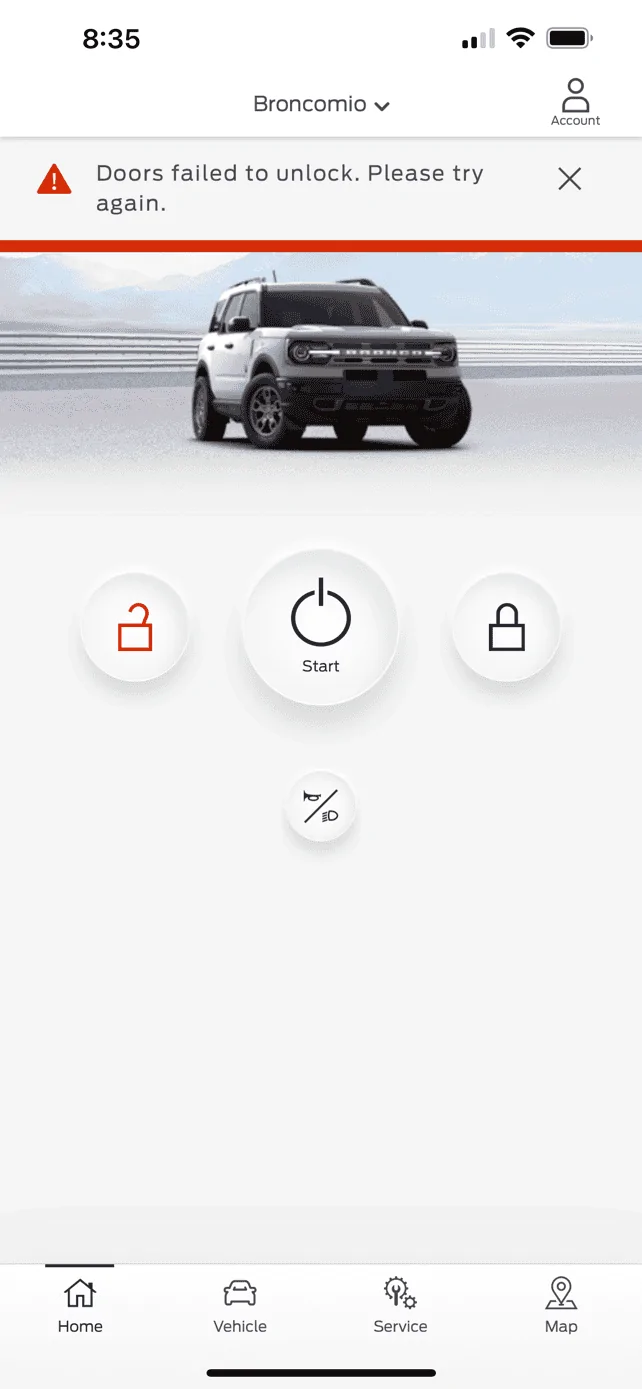

Everytime my Ford Bronco comes back from a Ford Services recall it comes with issues it didn't have before it went.
First recall - brake:
It came with a loud noise when braking in reverse. I went to Ford again and they just lubricated it, the noise still there but a little lower.
Second recall - fuel injector:
It came back with the display screen system turning off during the trip, everytime that I need to drive long distance.
No access to remotely start the car, lock or unlock it through the app.
Anyone else with the same problem that could let me know what to do?
Ford on call just tells me to get service done at another Ford Services, BAD after sales and troubleshooting for a 2021 car, brand new and extended warranty.

Many owners report strange behavior that is ultimately traced to a bad battery. These vehicles seem to be very sensitive to battery health. I suggest you take your car to the dealer and ask them to perform a battery load test. This is not a simple voltage check; it requires placing a specified load on the battery while monitoring voltage.

You can get a battery load test at almost any auto parts store. Then you'll be going to Ford with facts. The first sign of a low battery is the Auto Stop/Start quits working. In the winter, making short drives, I'd have to charge my battery every couple of weeks.
