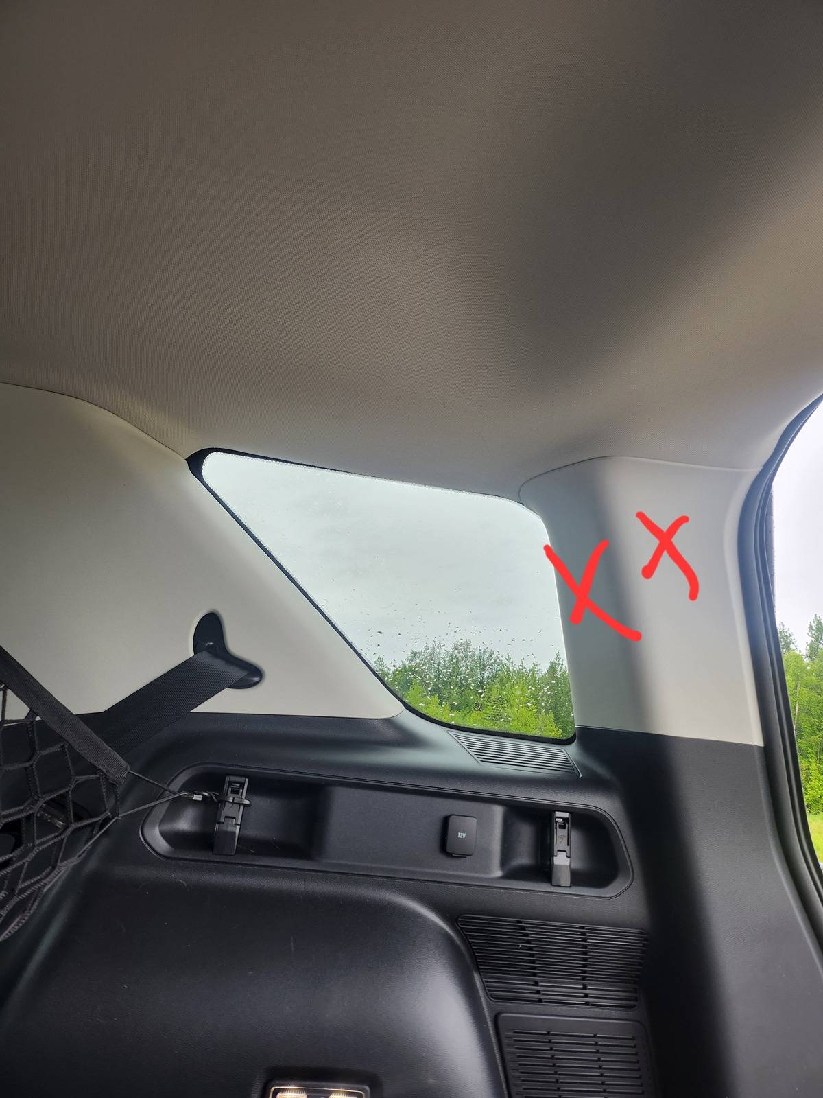

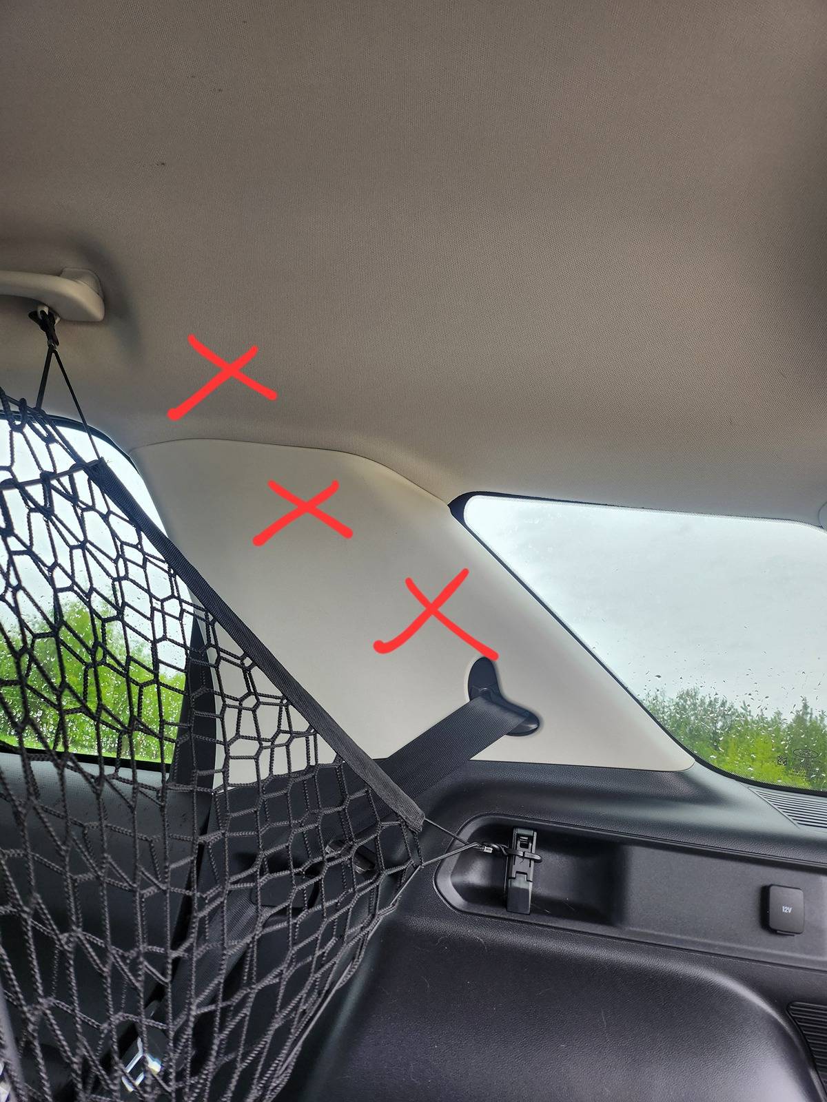

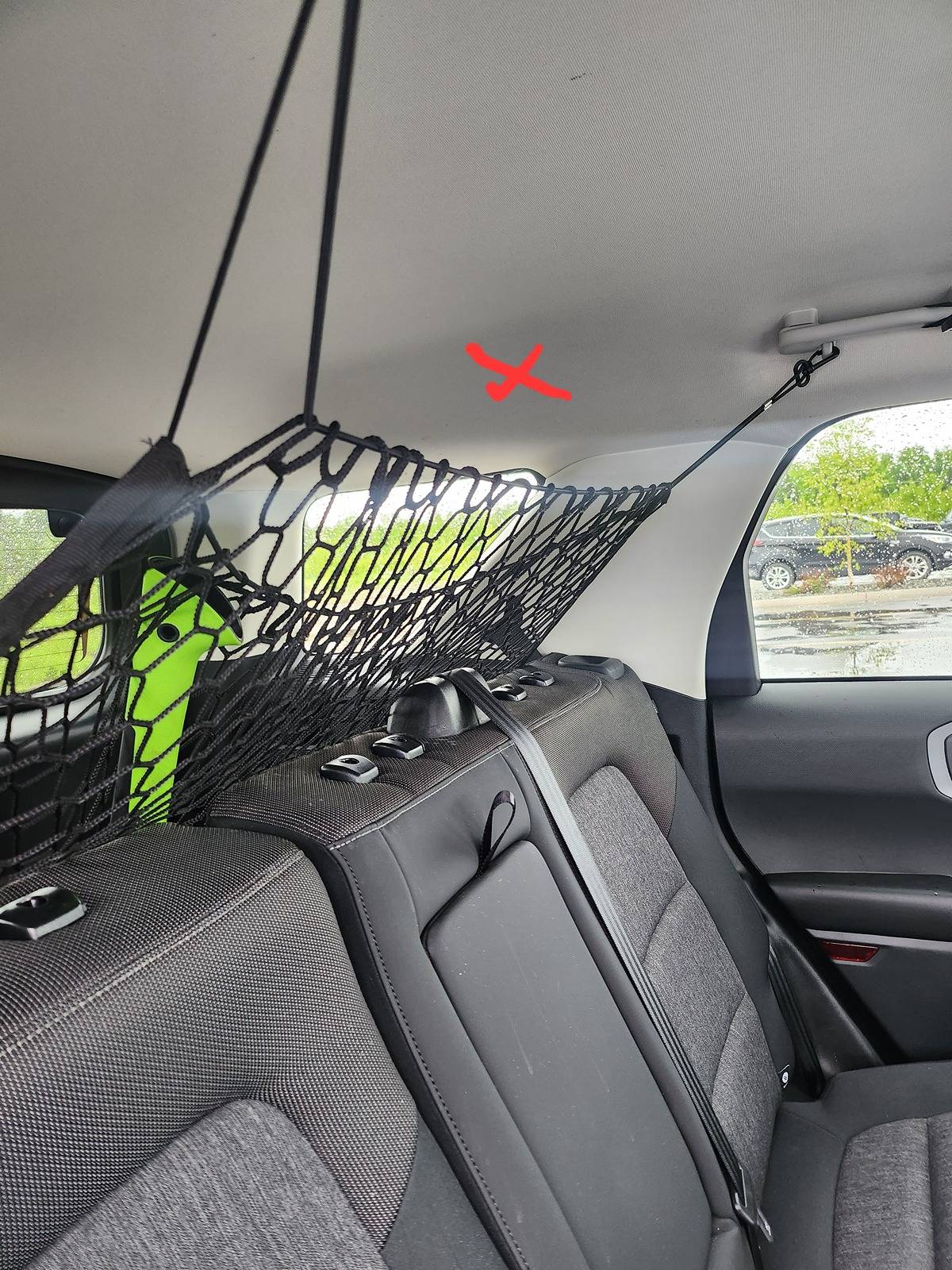

  • I have a net in the back to prevent the dogs from licking people and drooling on the seats. I have it attached to the lasso hook in the back and to the grab handle in the front. My friends let me know that it awkwardly touches their head when they sit in the back because of the angle (even with the headrests on). I have seen the metal cage-material barriers for keeping the dogs in the back but I wanted something more flexible since I change who/what im transporting frequently. (Pictured below, red X will be made clear later)

  • The trunk area has a vaulted ceiling and I was wondering if anyone has tried to install cargo hooks / anchor points to take advantage of that area. I have seen the cheap plastic ones on amazon that just screw into the trim but I dont think they will be able to hold up tents, cots, chairs, etc.
  • I was wondering if I can take off the trim and find some points in the frame to drill into or possibly put something back there for the screws to bite into.
  • I am concerned about hitting wiring, airbags or just drilling into the body itself by accident.

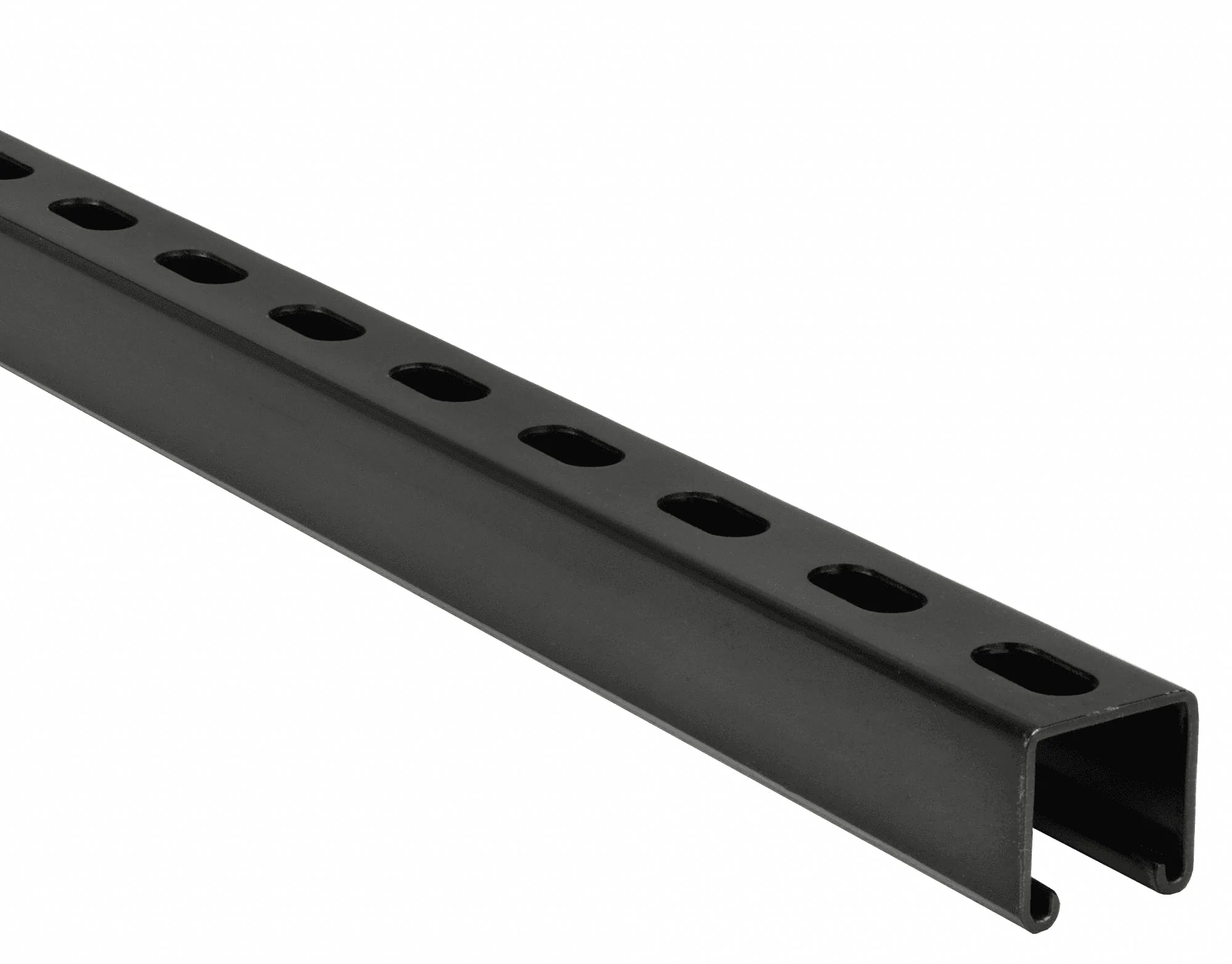

  2. Bolting some struts to the side to either hold up oddly shaped items or to attach a MOLLE panel

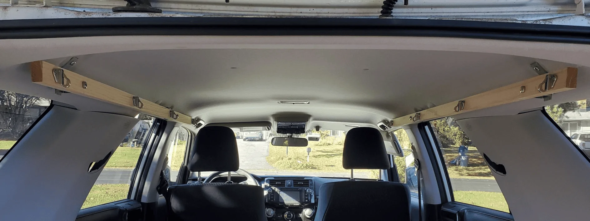

I'm thinking of something like this but with metal strut (this was taken from a 4runner forum, I believe he used the grab handle screw holes)

It's definitley close to what i'm looking for, I might give this a shot and see if I can make some good anchor points with it. I saw this previously but didnt think about using it as an anchor point for a larger panel

As far as creating a barrier for the pups. Maybe something like this would work? I used pvc but you could use actual gate/kennel material so they couldnt lick/drool past it and use the bungee cord or whatever you choose hooked the headrests as mounts like I did for the pvc? Completely disregard this if I’m completely off what your thinking haha.
https://www.broncosportforum.com/forum/threads/diy-front-seat-pet-barrier-under-20.9912/
