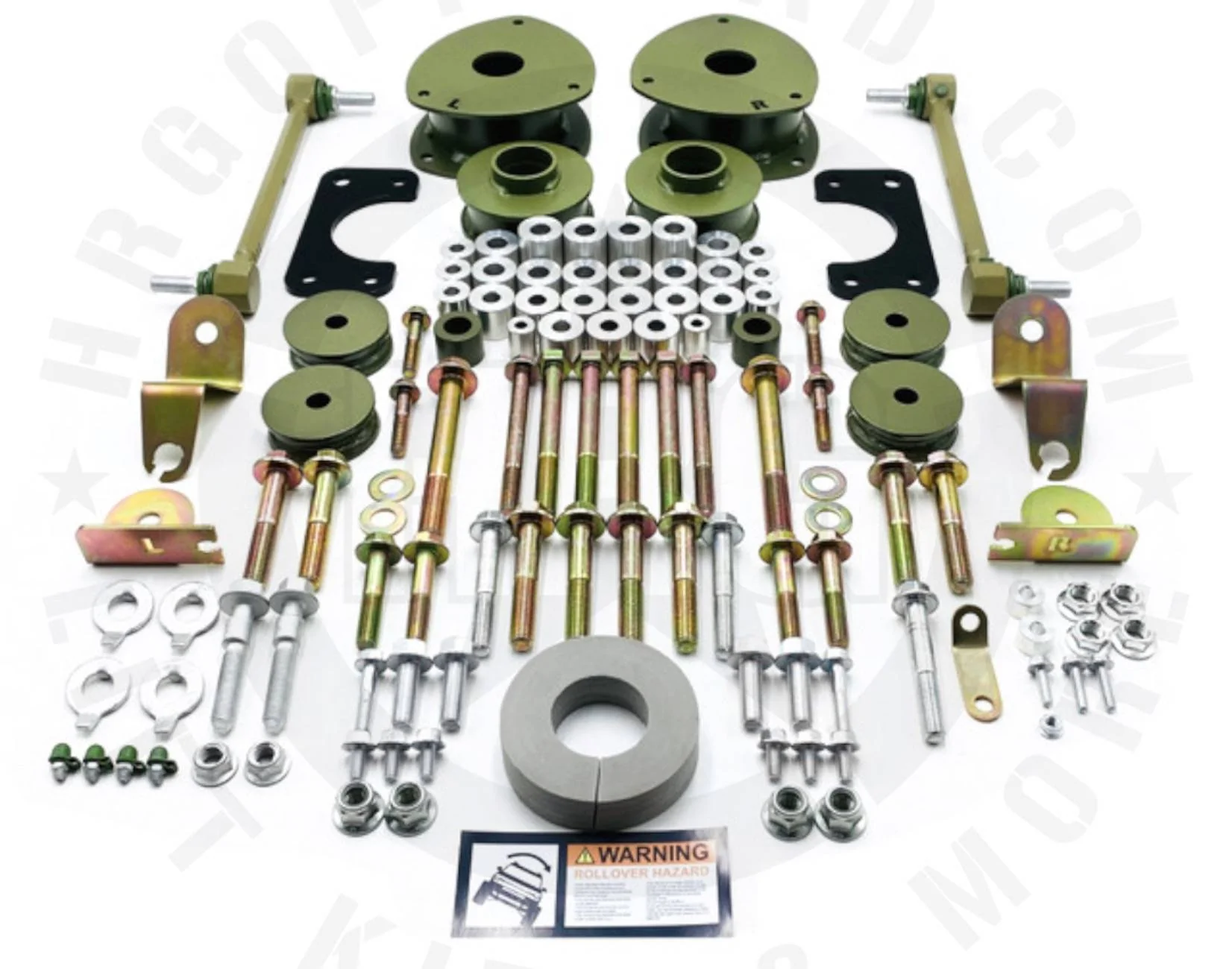

Has anyone out there installed the 2.5 inch version of this kit on a Badlands? Skid Plates? The front bumper skid plate would have saved me thousands already. I’ve been considering this kit but wanted input first before purchasing it.
I currently run 245/65 R17 Mickey Thompson Baja Boss AT on OE wheels.
https://hrgoffroad.com/product/2-5-inch-64mm-ultimate-lift-kit-for-2021-2025-ford-bronco-sport/
https://hrgoffroad.com/product/front-skid-plate-for-2021-2024-bronco-sport-badlands-first-edition/
https://hrgoffroad.com/product/mid-skid-plate-for-2021-2024-bronco-sport/

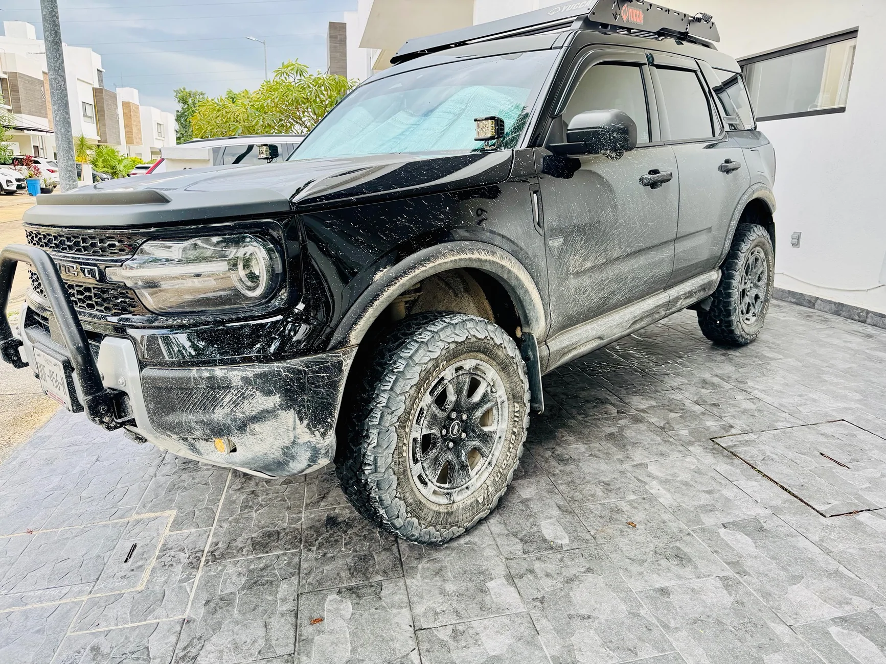

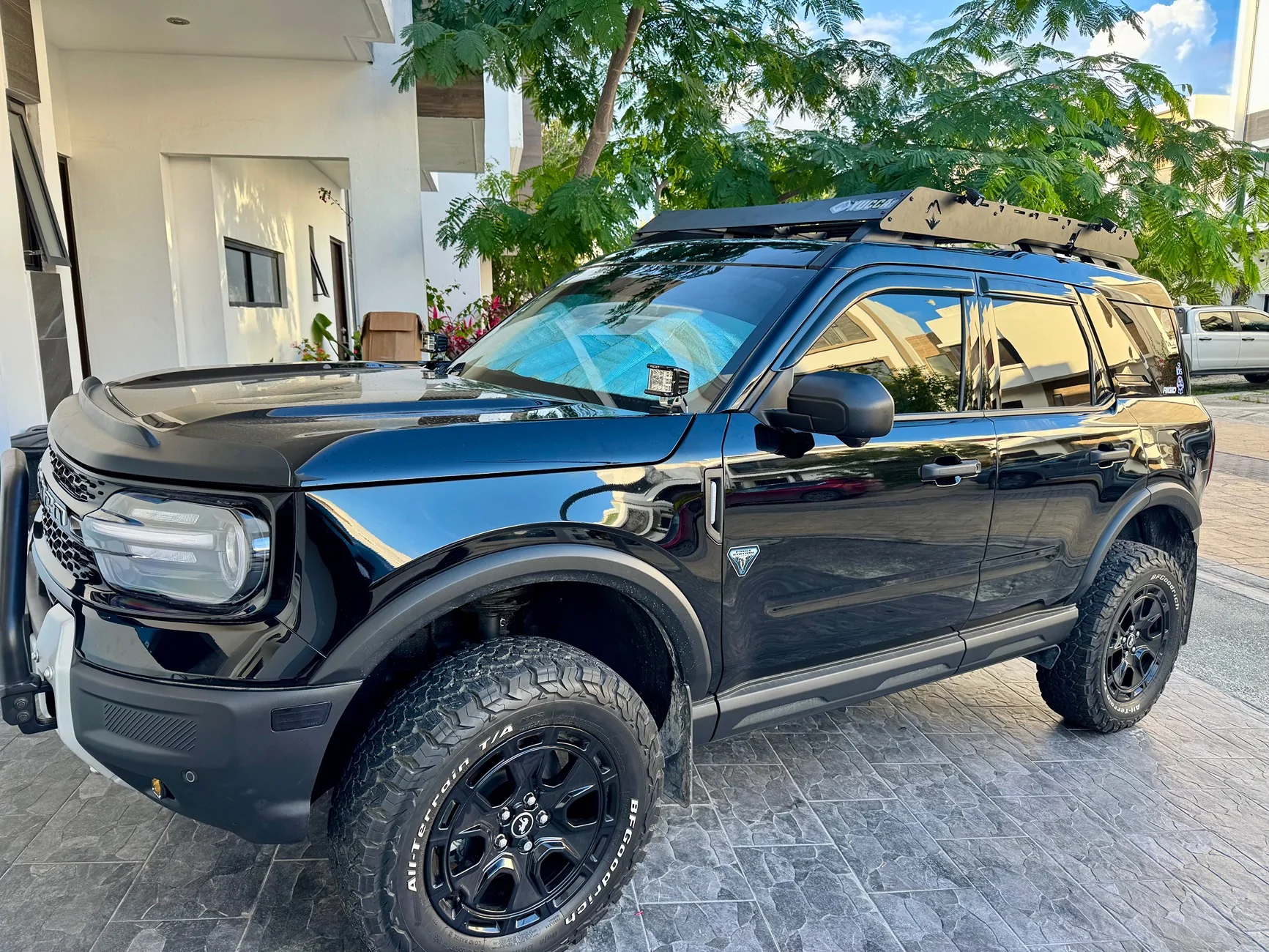

Did you have an alignment done post lift? Maybe its the photos but it looks like you have a lot of positive camber (top of the wheel tilting out) which will happen with a taller lift, did you install the replacement chamber bolts?
Nicktacular06
Nicholas
Dec 11, 2025
Cancún Mexico
Sport Sasquatch
Took it for alignment as the steering wheel was off by maybe half an inch and did not need the camber bolts.
