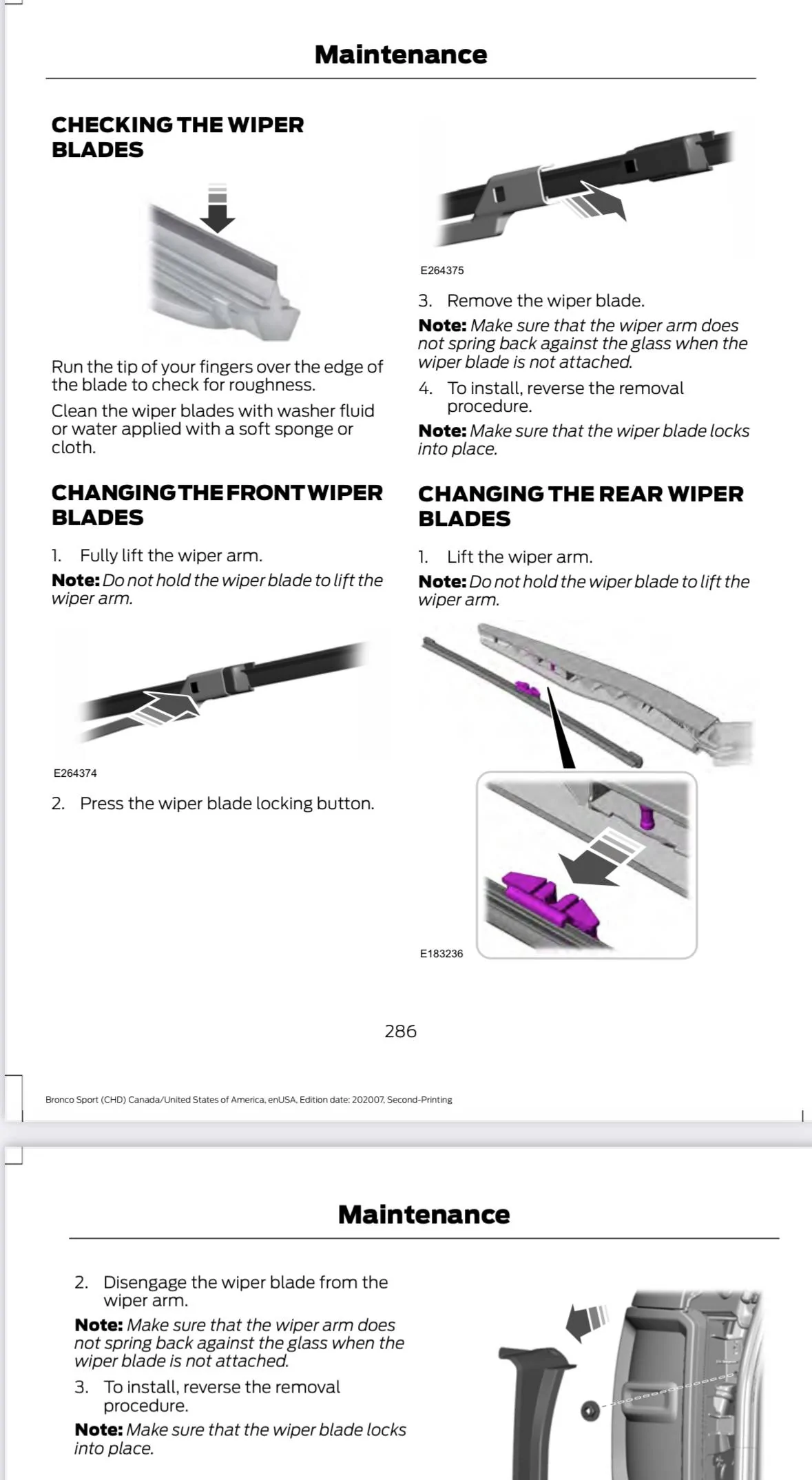

Hello all,
I have not been able to find anything on this forum, owners manual or the web. I don’t want to break anything and I’m having trouble seeing how it is connected to the arm, thanks in advance.

Thank you, I guess I missed that.

Try to place a cushion of something soft where the arm could hit the glass without the wiper. If the arm slips out of your hand when the wiper blade is off it could break the glass.
