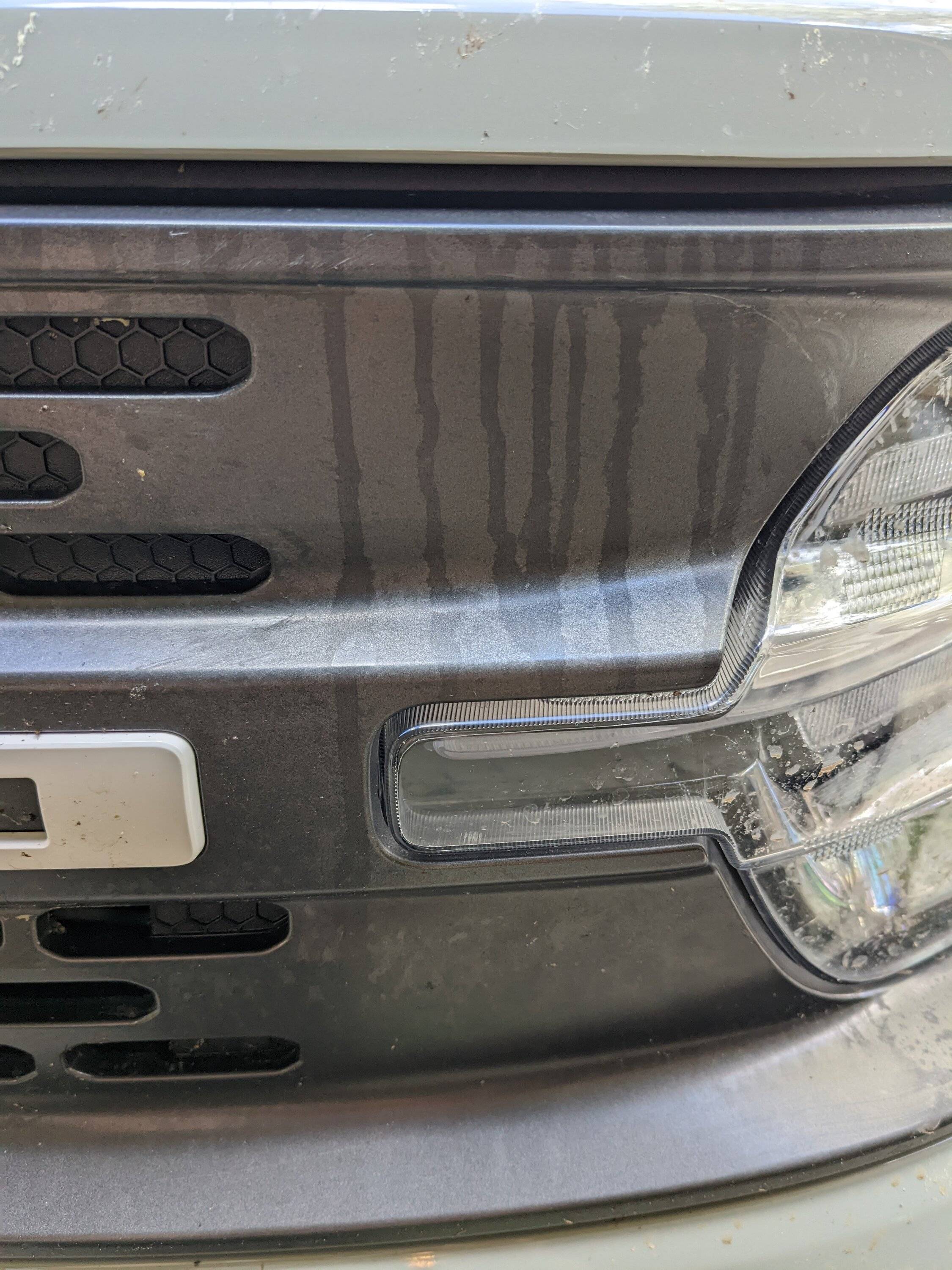

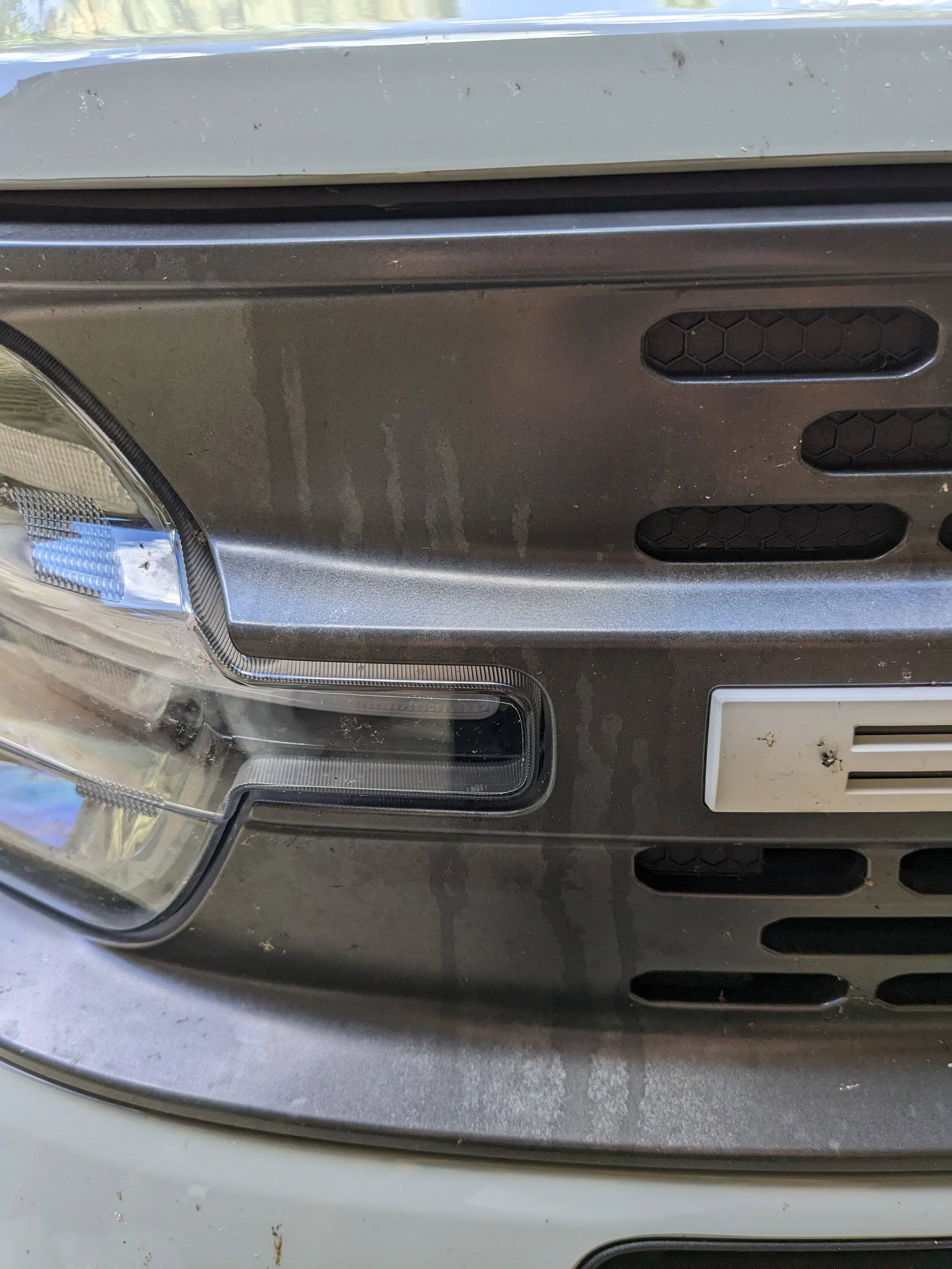

Was trying to get a nice clean up job while on a vacation in Mesa, AZ. Took it to Five Star Car Wash. Noticed later these drip marks on my grill that do NOT come off. It looks like they used a chemical that destroyed the finish. I am so so sad and mad! Any suggestions?

I'd go to Walmart, get some turtle wax bug and tar remover and some microfiber cloths and try that out.

Goo gone is also an alternative

I'll take a guess at it
what it does not look like
uniform
seems to have dribbled downward across grill work
looks like some of the soap or wax was left under lip of hood
rinse did not catch this soap/wax
after completion residual soap/wax dripped down face of grill
it might just be a heavy layer of product left behind post wash

I suspect so as well, but no matter how hard I scrub it's not coming off, so it makes me wonder if the finish is permanently damaged.

i own a detailing shop and this is indeed a chemical stain, it is sprayed just before the first rinse usually to assist detailers in softening up the bugs off the grills/front bumper, mirrors and windshield. it appears it was left for too long, i would try checking out local detailing shops to see if anyone has a trick or special chemical. if you cant find anyways to get it off, which truthfully in my opinion i don't believe you can, here are some high end dressings for the best result that can blend the grill colour all back to its original finish. "quickshot by hightech" or "fadeaway by bocar"

Call up the car wash. You got the pics and ticket.
finish is not destroyed
