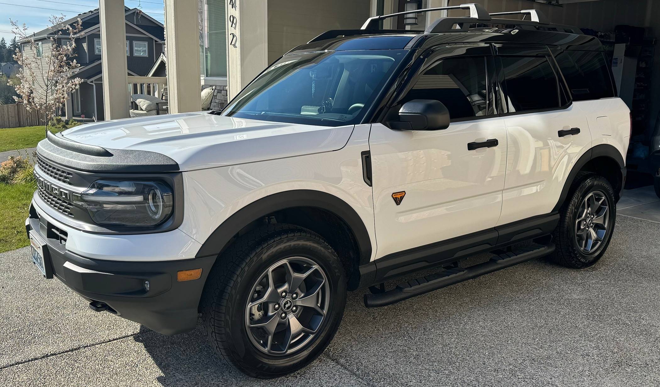

Just bought a 23 badlands. There is a creaking noise on my dashboard just behind the screen that is driving me crazy! Is this common? What have you done to get rid of this? Please help before I go crazy! ?

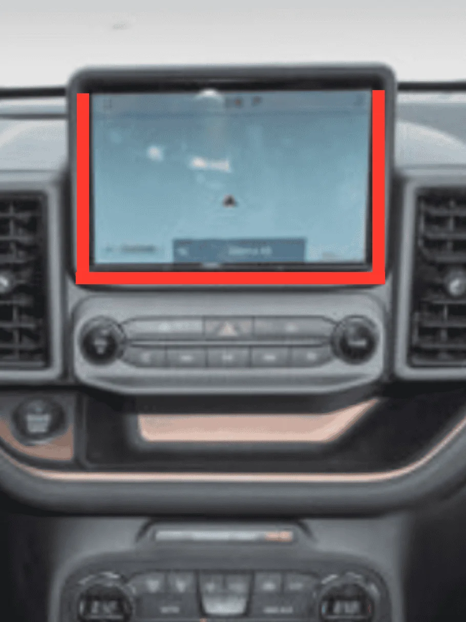

Do you think the creaking noise is coming from the space marked in red around the 8” screen? Don’t remember if the space includes the top portion.
When you are driving and you get the creaking noise, press gently on the 8” Display screen. If pressing stops the noise, you can obtain thin dense foam (in gray or black) and using a credit card or a plastic trim tool, force in the foam just until it’s no longer visible. Others posted that worked for them.
Ford Bronco Sport Creaking noise on dashboard 1712608342717-dm
It’s actually behind the screen where I’m hearing squeaky noises. Thank you!
