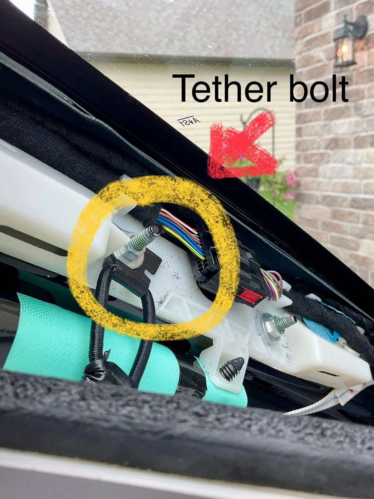

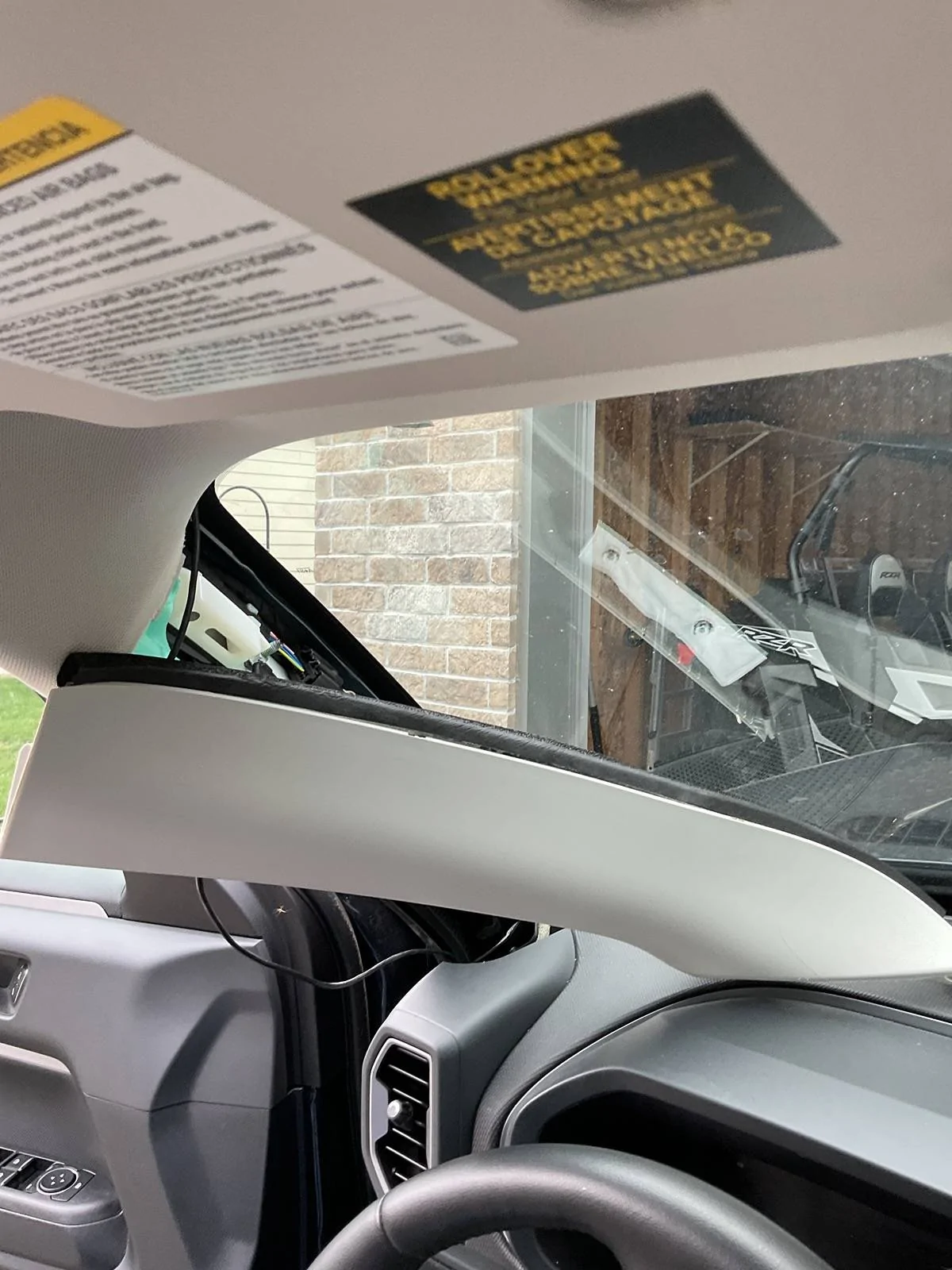

2. Remove the driver side A pillar trim by pulling it straight towards you. A pair of latex gloves helps with the grip. The Pilar trim is secured loosely to the frame with a short tether (10mm bolt) which optionally can be removed for better access to route the power wire. I left the tether in place and just worked around the dangling A pillar cover.
Ford Bronco Sport Installed Ford accessory dashcam VHL3Z-19G490-C IMG_4621
Ford Bronco Sport Installed Ford accessory dashcam VHL3Z-19G490-C IMG_4620
3. Tuck the power wire along the front of the pillar , away from the airbag and use some soft foam to keep it in place. Reinstall The pillar
Ford Bronco Sport Installed Ford accessory dashcam VHL3Z-19G490-C IMG_4622

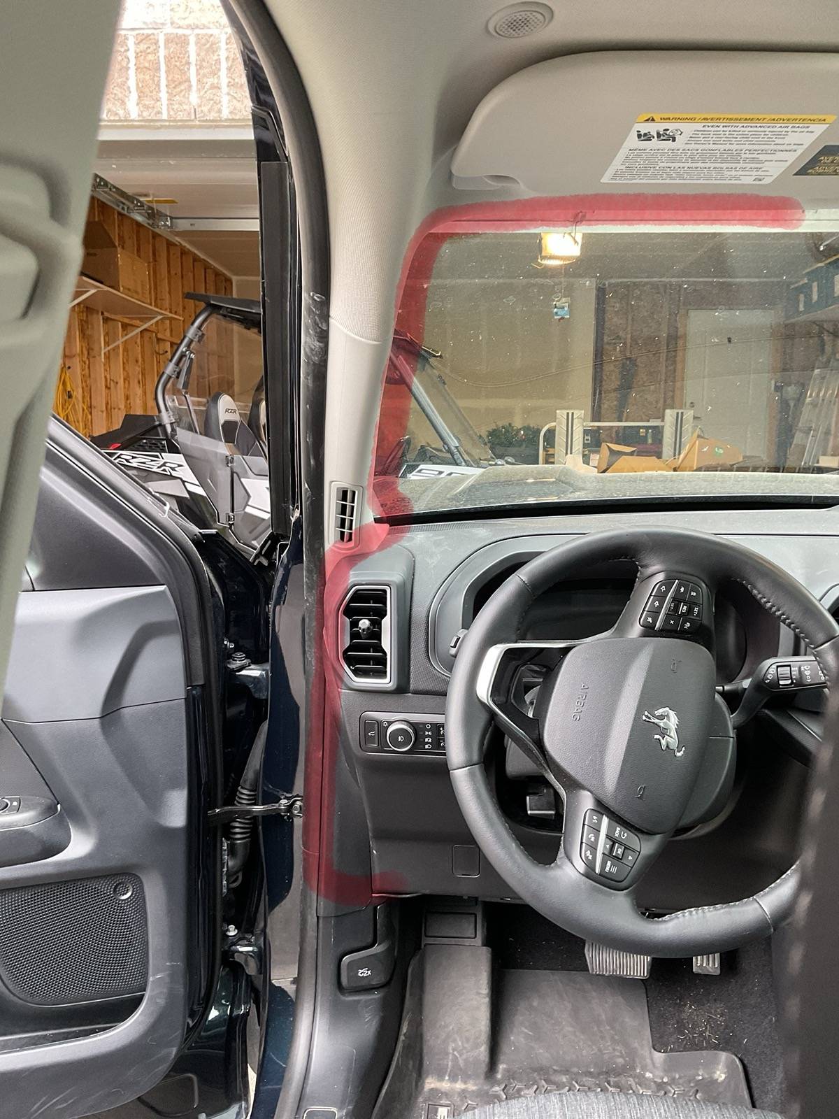

4. Run the wire the side of the inside doorframe and tuck under the trim.
Ford Bronco Sport Installed Ford accessory dashcam VHL3Z-19G490-C IMG_4623
