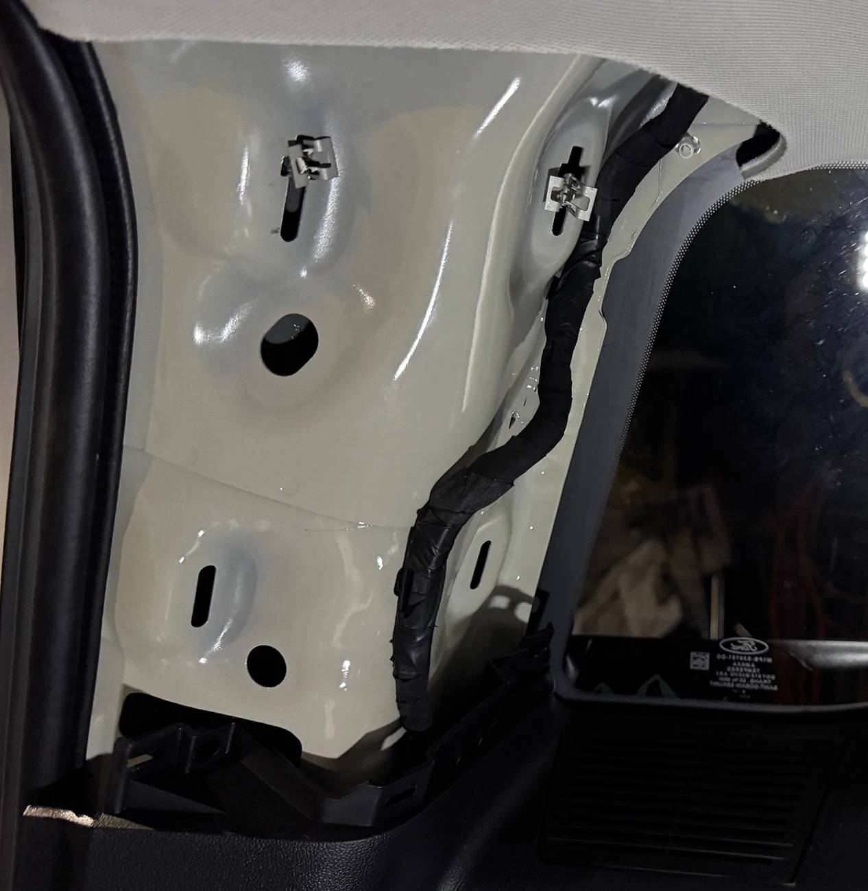

I took a look under the headliner last night. Generally, finding an accessible anchor point looks more involved than I was hoping, but I think I found a way that will work for me.
To get under the liner, I first had to remove the D pillar trim following these instructions kindly linked by @ChefDank. The U-haul guy doesn’t mention an important point that is highlighted in Ford’s 37-page light bar installation instructions.. after popping the lower trim clip toward the bottom of the D pillar interior trim, you have to lift up on the piece to release the upper two clips, otherwise you’ll probably break off the clip tabs on the trim piece. Here’s a look at the D pillar with the inside trim removed, showing the upper clips at the top of the slots they sit in.
Ford Bronco Sport Grab handles IMG_2307
After that, you can easily find and release 2 clips along the upper edge of the cargo hatch, then you can fold the headliner down just enough to get a look at the roof structure above the driver’s side cargo window and below the hatch hinges.
As you can tell by generally pressing against the headliner anywhere in this area without removing any trim, the headliner basically floats a few inches away from the superstructure, aside from a few clip points. Unfortunately, though not surprisingly, there are no obvious spots where you can expect to just punch through the headliner and find an easy anchor point. We’ll have to do a bit more work..

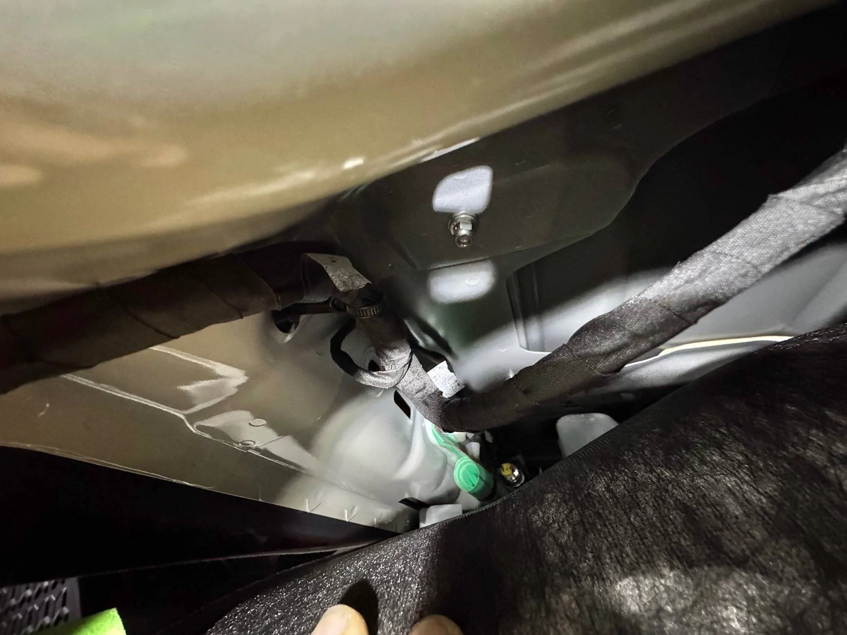

Here’s a view looking forward and up on the driver’s side. You can see the driver’s side cargo area window on the left, D-pillar upper left, reinforced body frame above the window, reinforcement for the left hatch hinge, and the rear roof rack mounting bolts.
Ford Bronco Sport Grab handles IMG_2310
Not sure if the green foam pieces are new to ā€˜25 model year and/or Badlands trim. I read that Ford put some work into dampening road noises in the latest edition.

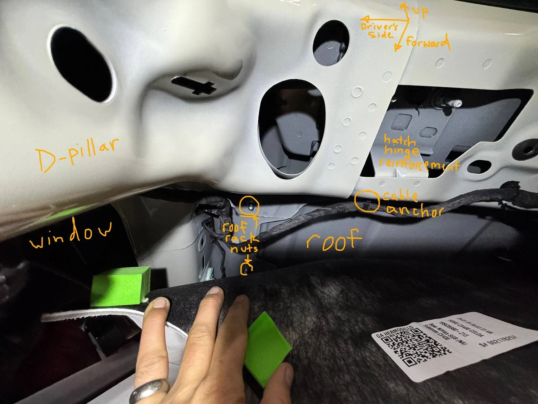

You can also see above my pinky a little bit of the rounded reinforced frame above (to the right of in this view) the window. In theory we could mount something there, e.g. 2ā€ aluminum square tube extrusion to span from the frame to the headliner (~2ā€ gap) to make our own anchor points. Drilling into that cold-rolled steel in this area would be a royal PITA, but it could be done. Here’s a better look at that frame ledge above the driver’s side cargo window:
Ford Bronco Sport Grab handles IMG_2308
Anyone wanting to rigidly mount something (e.g. Molle panel) over the cargo windows will probably need to do something along those lines, building off the frame.

In my second photo I highlighted a cable anchor near the left hatch hinge reinforcement. The hole for that cable anchor looks to be in a decent (not perfect, but probably good enough) spot for what I’m trying to do. Again, it’s about 2ā€ gap from there to the headliner, so I’ll have to build out, but at least I won’t have to drill. This is roughly what I’m envisioning (looking leftward toward the cargo window and up; vehicle forward is toward the right in this view):

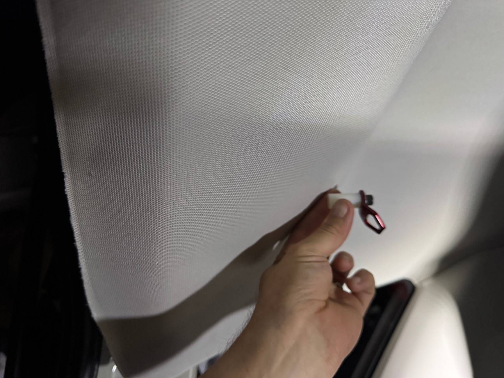

I ordered one and will see how it fits tomorrow.
More soon. I hope someone finds this useful.

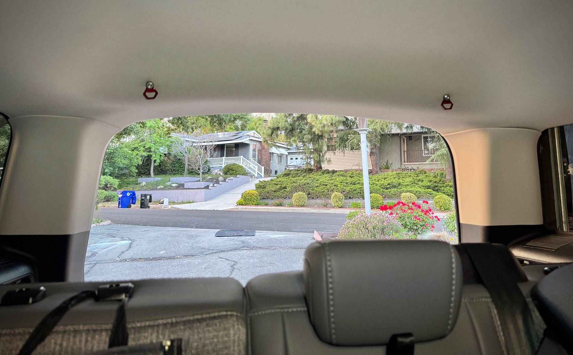

Job done.
Ford Bronco Sport Grab handles IMG_2324
Ford Bronco Sport Grab handles IMG_2325

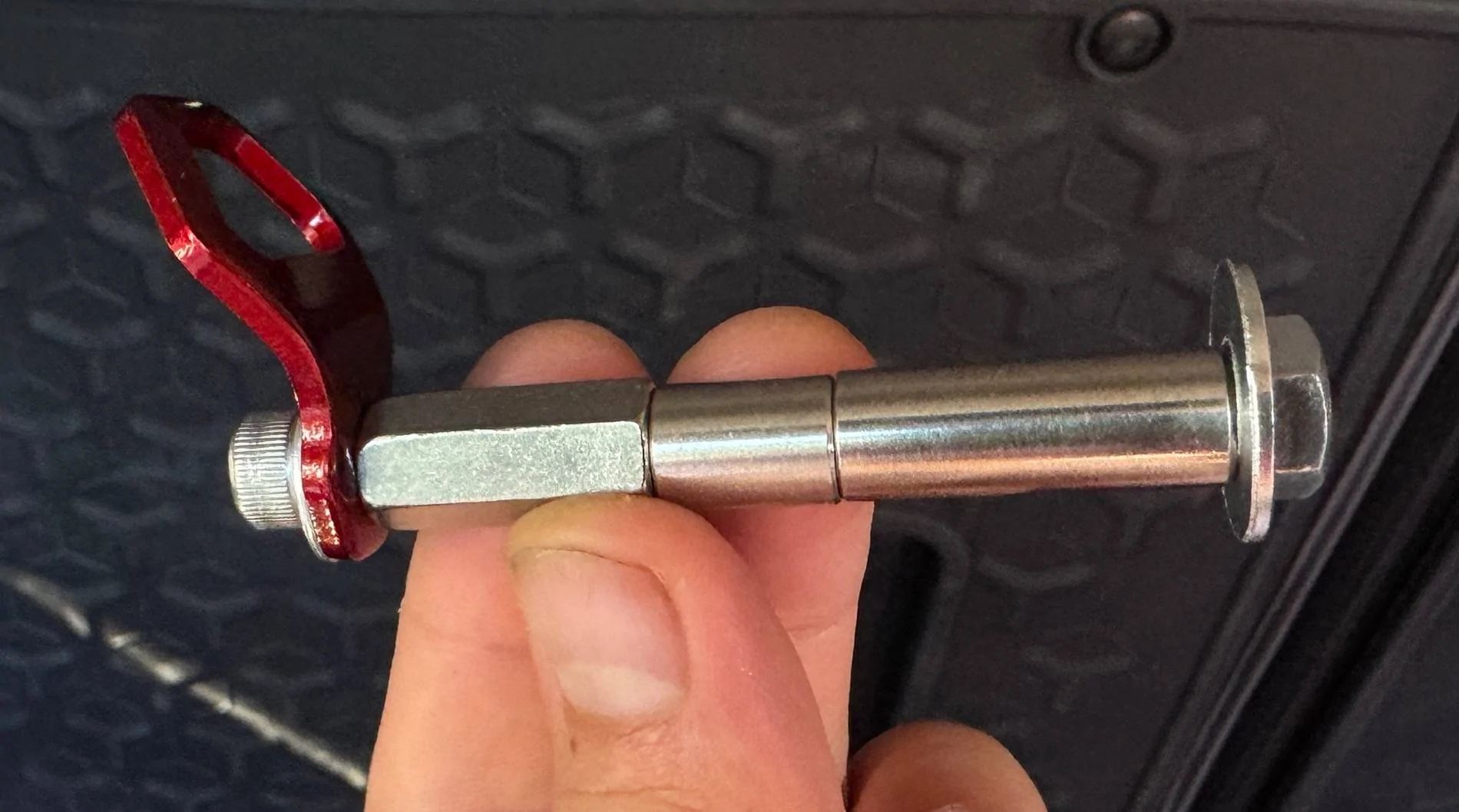

I stuck with 2ā€ 1/4-20 bolts but picked up some stainless spacers and coupling nuts, extending the total standoff length to 2.5ā€ with a nice threaded interface at the end to bolt clips into.
Ford Bronco Sport Grab handles IMG_2322
It wasn’t too hard to locate the offset anchors, punch through the headliner, and bolt in the tie-down rings.
I wouldn’t try hanging my own weight off these rings, cantilevered out that far, but they’re easily strong enough for a cargo net in tension or to clip a bungee to, or string a paper towel roll holder or maybe a swimsuit drying line. They’re rounded enough that it shouldn’t hurt too bad if I bump my head on one, and also I can rotate them 180 out of the way where they’re still good anchors for a net.
Source for the motorcycle tie down rings: https://a.co/d/fnjWyo3

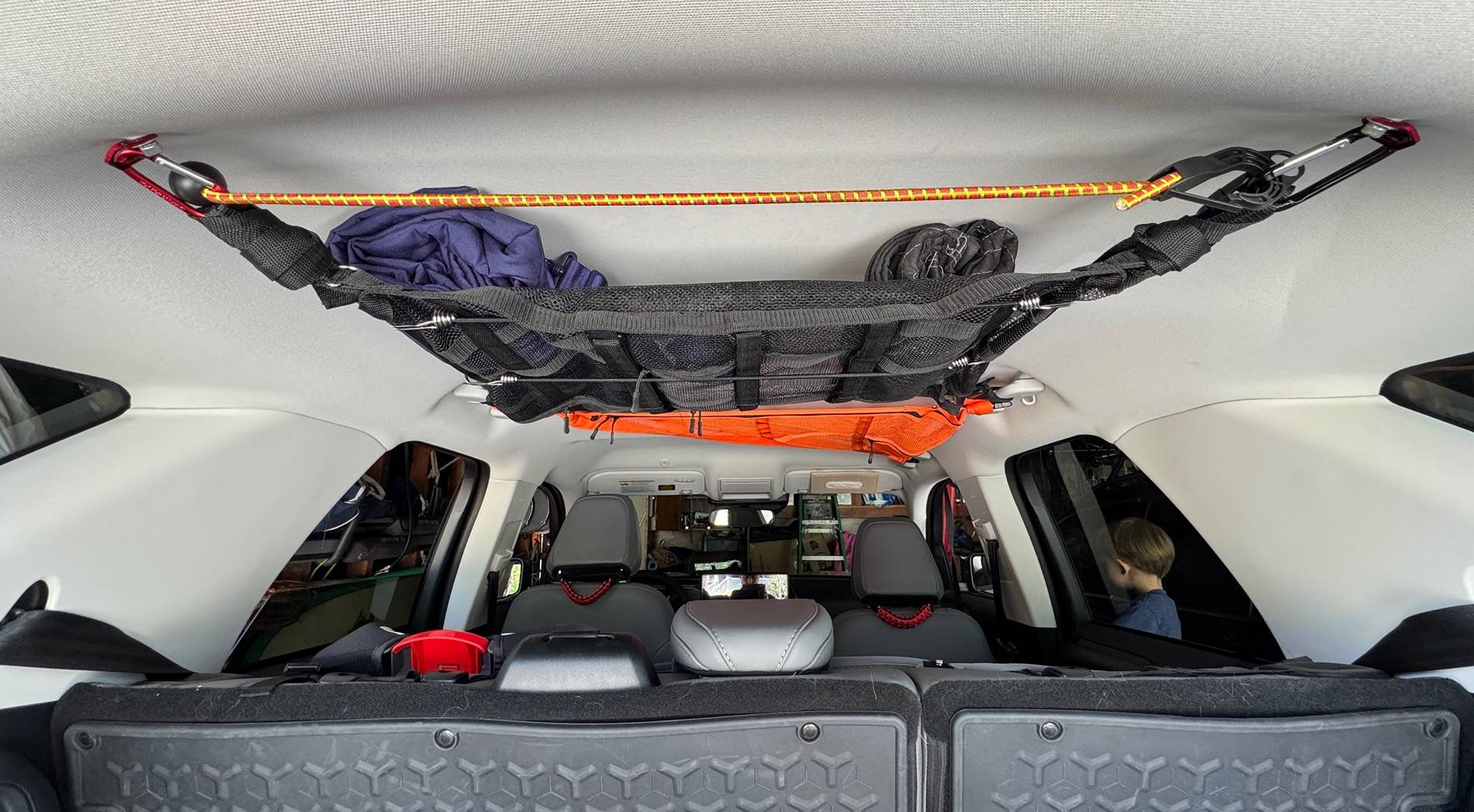

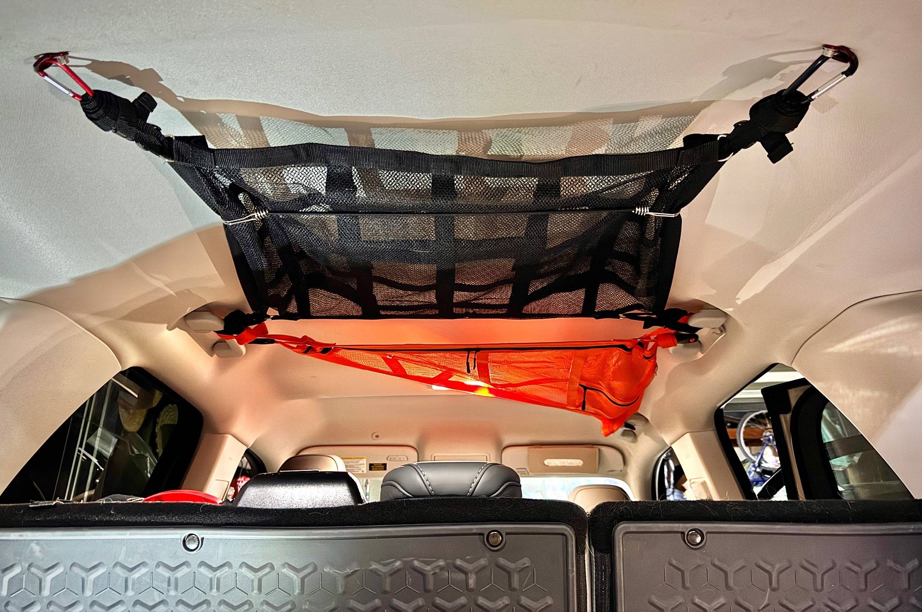

3-point net up front between the grab handles, and a 4-point net between the rear seat handles and the new anchors over the cargo area. These don’t impede rear view at all, even loaded with lightweight stuff. I highly recommend adding these anchors and nets.
Ford Bronco Sport Grab handles IMG_2397
The nets stay well clear of the view through the rear view mirror to the rear window.
