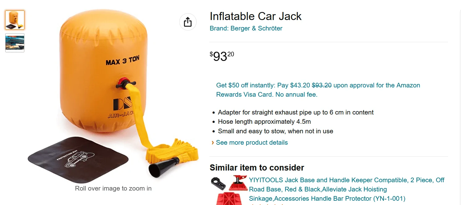

If you can manage to get one wheel in the air
Shovel gravel into rut
Move on to wheel No. 2
Repeat process

Great Idea!! (why didn't I think of that??? :-()
I might be able to use the jack that came with the BB.
Thanks, I'll try

So, I used the supplied jack, which works btw great, and lifted one tire after other up, put some gravel in the rut ... and out she rolled!! Thanks for the tip!!!!
Btw - if ever in a situation where stuck ... turn OFF the traction control ... will give you the real 4-wheel drive.

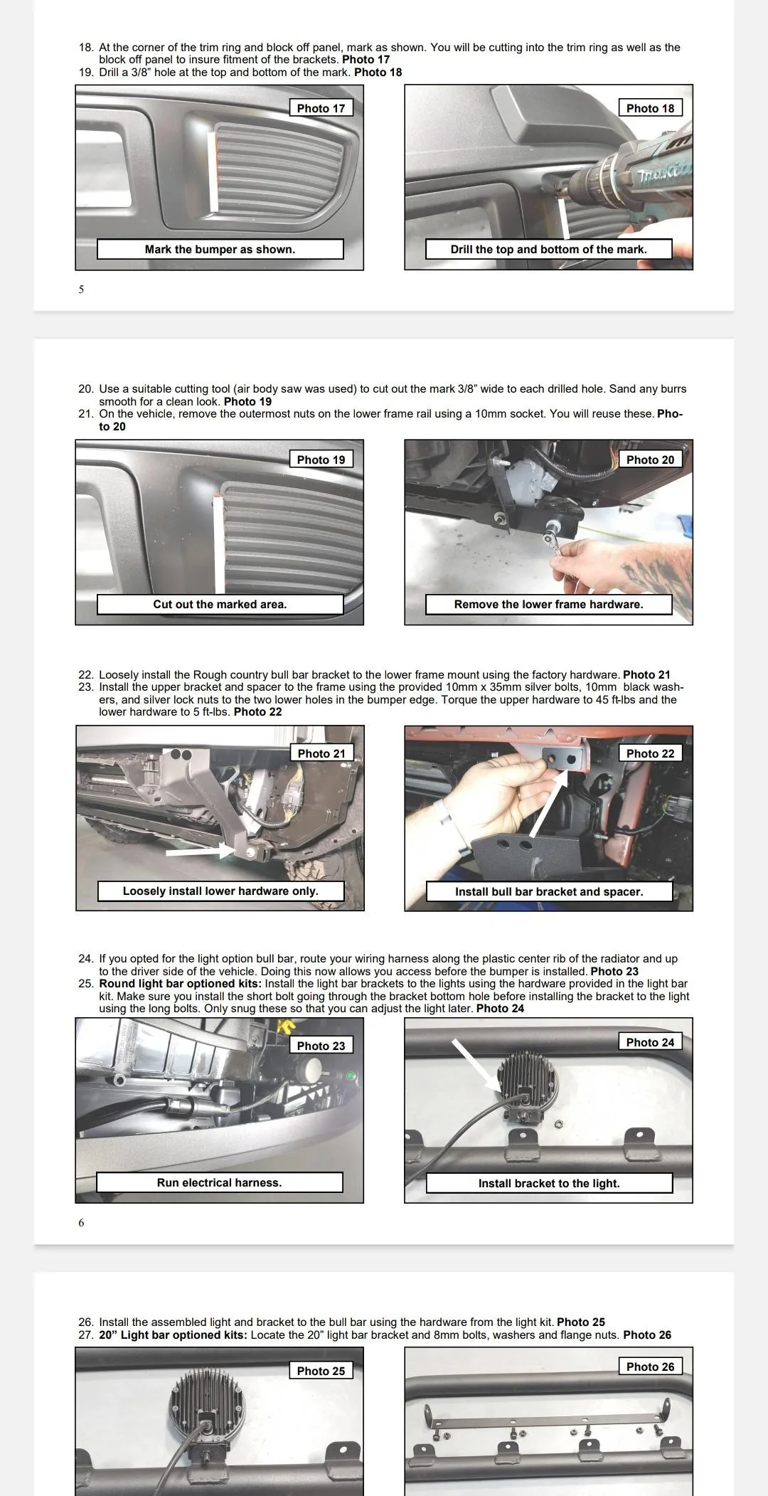

Here's possibly a solution.
A nudge bar install can be a tow point since it's bolted to the frame ?.
Ford Bronco Sport Front Towing / Attachment Location Screenshot_20230608-081510_Driv
Just a thought?.
