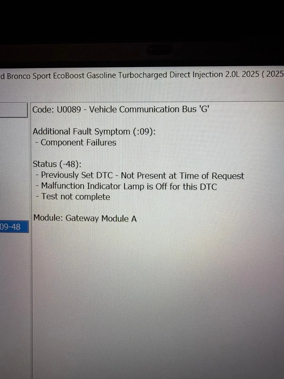

I did encounter this, though:
Ford Bronco Sport FORScan: Accessory Power Delay? IMG_0191
No warnings or observable symptoms. I only noticed it when running FORScan to check on the delay timer.

When the stauts ends with the number 8 (status -48), it is a stored code and not an active fault that you need to be worried about.

So I got a 12V to USB adapter with the voltage display (https://www.amazon.com/dp/B07K2XL6VX?ref=ppx_yo2ov_dt_b_fed_asin_title&th=1), and everything seems copacetic so far. ~12.2V engine off/accessory on, 14.2V+ engine on, so the U0089 was likely transitory. I'ma check the negative to ground and make sure it's good'n'tight.
Or, just give it a shake, put my hands on my hips, and say the magic words: "That's not going anywhere."
