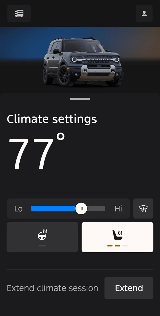

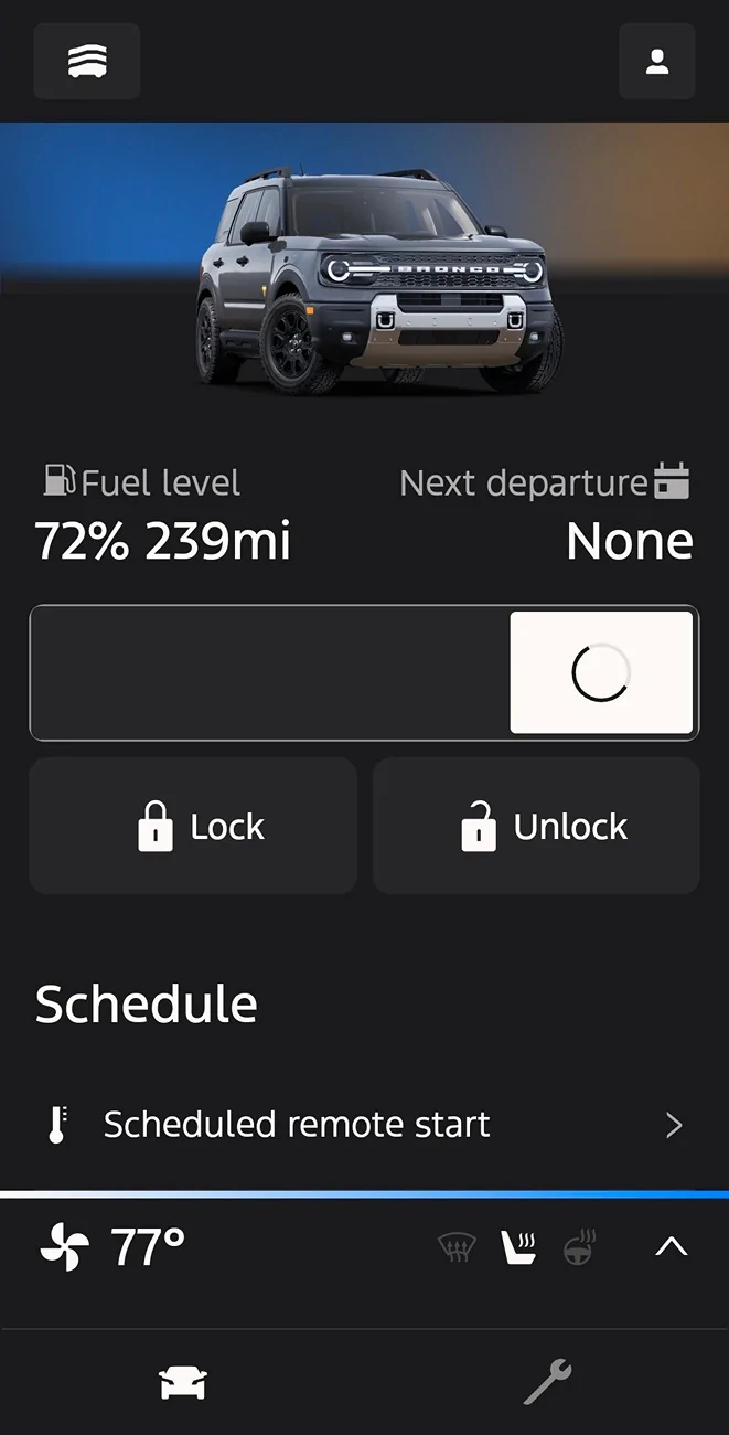

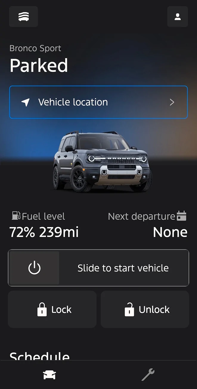

If I’m not mistaken you need remote start from the key fob to activate heated seats and steering wheel. When I do remote start from the app, I only get my vehicle turned on and nothing else.
No, starting the vehicle with the App WILL activate the heating and heated seats. Living in Canada, we use it all the time. :) I have a 2024 BS BigBend.
