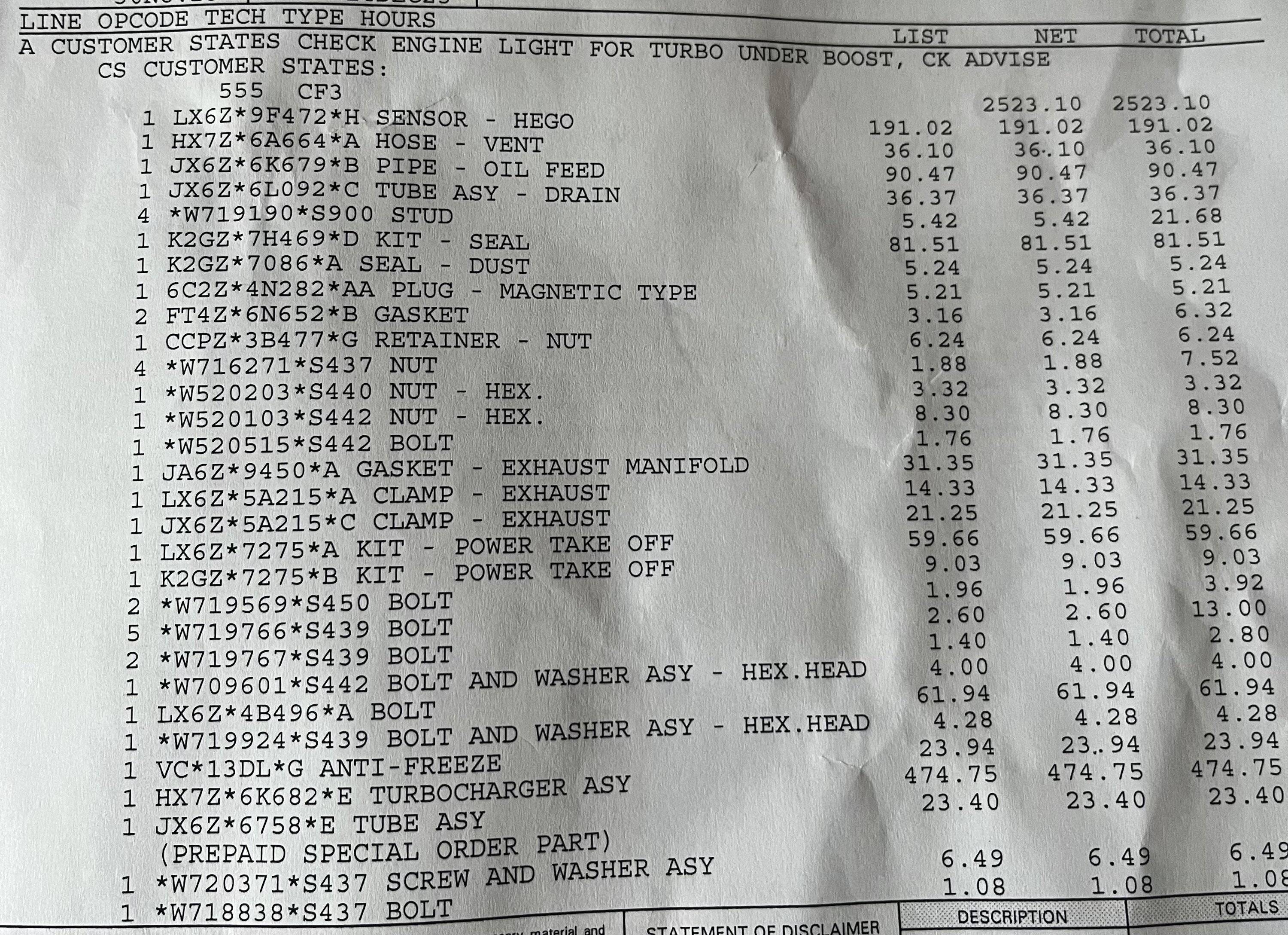

Yeah it was crazy $2,536 in labor.
I’ll post it when I get back home.
Turbo Charger assembly out the gate was around $475. Hoses, oil feed , clamps, etc added up
At the current rates, that's about 18 hours of labor.

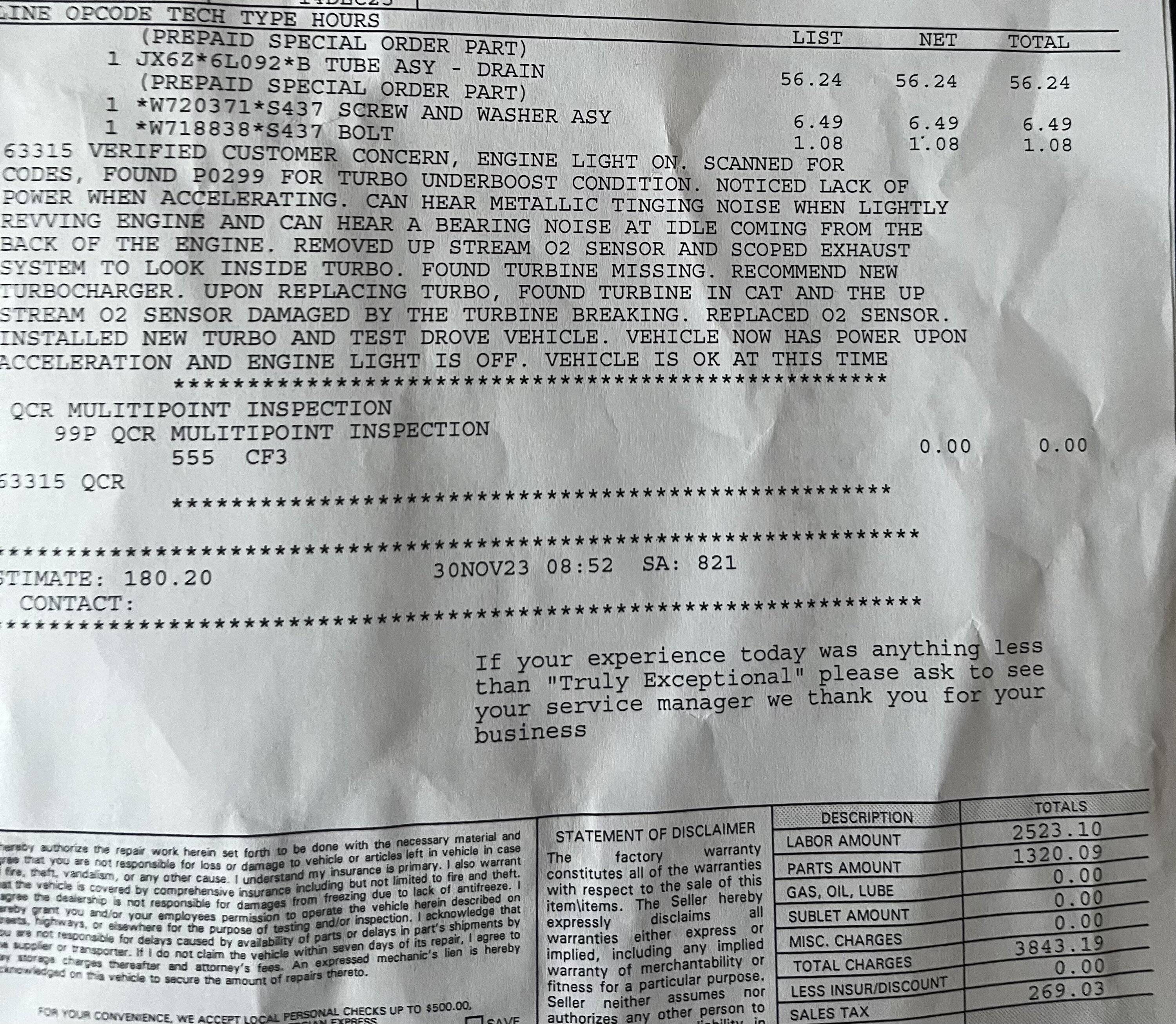

The day before thanksgiving my Bronco sport went into limp mode and dropped a p0299 code. Pulled over and got the car home. They started working on it Dec2nd,It was determined to have a blown turbo, turbo turbine was found inside my catalytic converter. Car got a brand new turbo assembly, all new hoses clamps, etc. picked it up back up on Thursday, they had driven it four miles and the check engine light was off and it was all good to go $4100 later.
I picked the car up, drove it home 10 miles and parked it without an issue. Didn’t drive it again until yesterday when my daughter had an urgent care visit need. Started up, got about 10-15 miles down and the same P0299 code popped, car went limp and my oil pressure light lit up temporarily. Service engine then immediately popped up as well. Turned back around and parked it again.

I took it to an authorized ford service center, they diagnosed it as a blown turbo. They replaced my turbo, they did not check the oil etc even though it's marked they did a full 55 point inspection. I paid $4200 to replace said turbo for labor, parts, etc. they said and is documented that the vehicle drove perfectly fine.
I then drove the vehicle home 10 miles had no issues. Parked the car, and didn't drive it for a day. Came out to the car 2 days later to take my daughter to urgent care, 15 miles down the road max. The turbo went again and a low oil pressure light popped up.
I then got the vehicle home, called my service center who stated they could get it in after the new year. Went to start the car the day of it going to the service center, and it was completely dead, unjumpable etc.
Had it towed to the service center who told me it now needed the turbo replaced again and the engine replaced as metal was discovered in my oil filter. I was quoted $8,000 which included a new turbo cost and an engine. They were unable to tell me if the metal came from the turbo being damaged or not. The vehicle was then taken home after I had them replace the battery. The brakes are now locked up etc meaning the brake booster was most likely damaged during the battery replacement since it sits right behind the battery.
