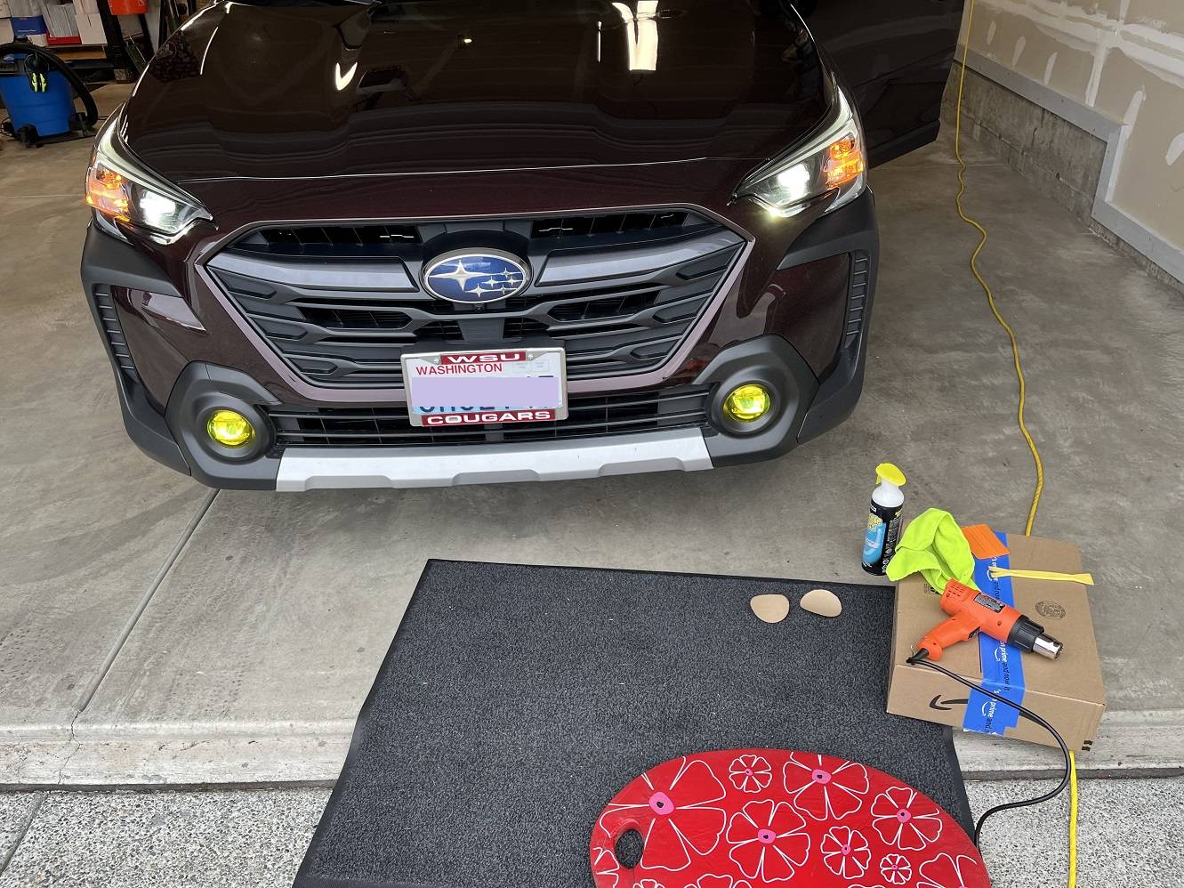

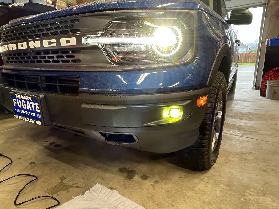

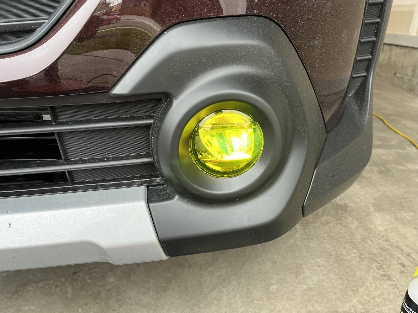

Bought their 8x8 sheet enough for 2 cars and cut my own circles. The BS is still in the shipping stage BS but practiced on the wife's Outback. Just have to go easy and work from the center round and round to avoid wrinkles, & bubbles. Worked best dry for me on the convex curved lenses - wet was too slippery.

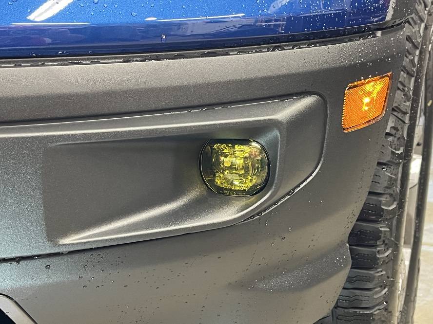

I put these on my BS a while ago but fitment was meh. Probably rushed it as the marker light film is very nice. Hard with that curve and easier to just purchase BD S1 fogs.
