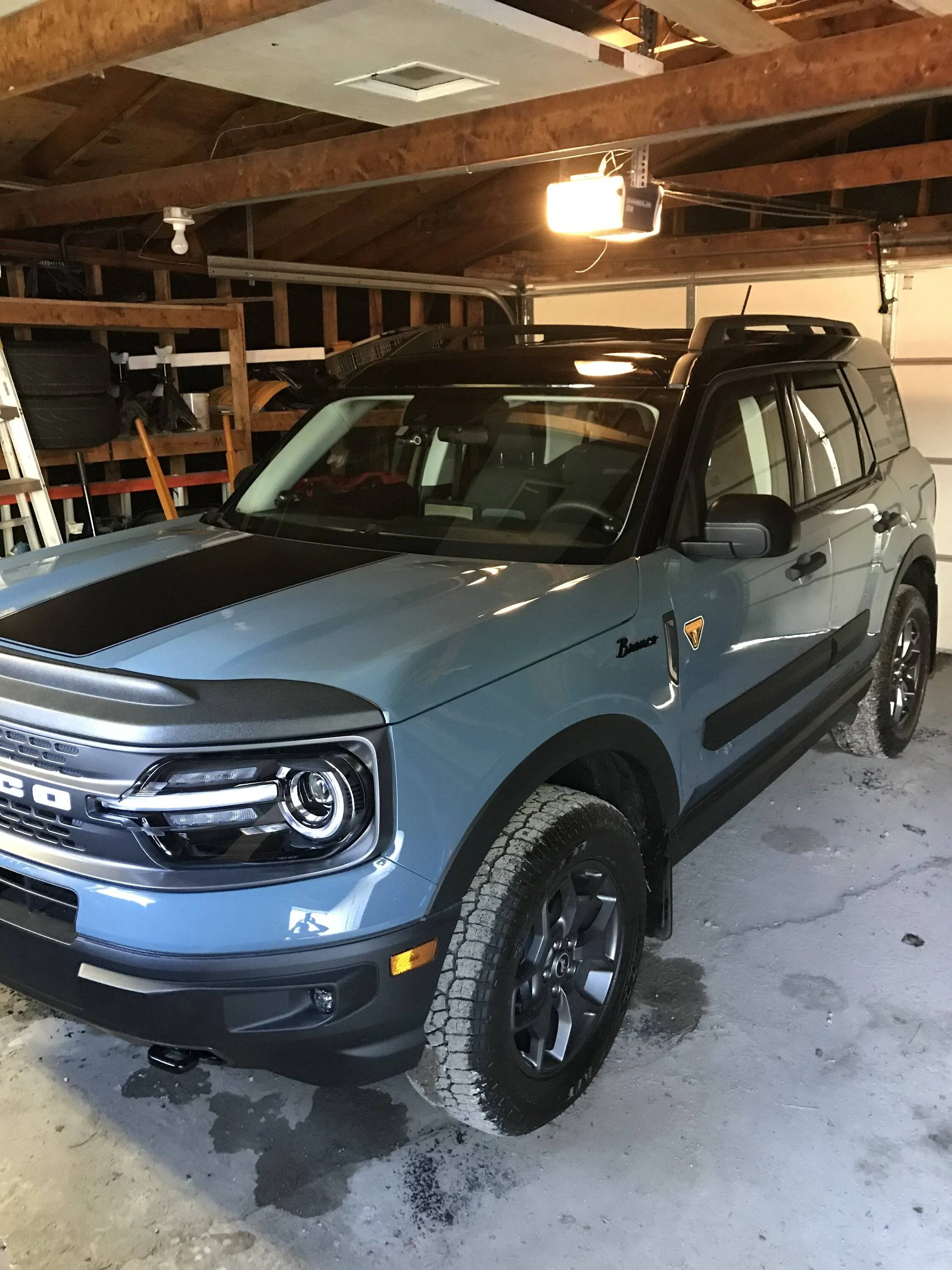

Just frustrated. It's obviously a new vehicle. I park in the dead center of the parking space, leaving plenty of room on both sides. I always park at the very end of the lot, but it fills up quickly on the daily since my Forest is one of the most visited in the country. To make matters worse, the repair needs to be immaculate so my dealer doesn't decrease the trade in offer.
I usually wouldn't let something like this ruin my day. It's just stuff, after all. But I've made it such a point to keep it perfect.
I hate people and their laziness and asshole tendencies. I park out as far as I possibly can, on an end space hugging the wide line if possible. If I see two really nice cars and I have to take my chances that's the best I can hope for. Vans..NO. old pickups...NO...anything pre-2020 NO...and shit still happens.
