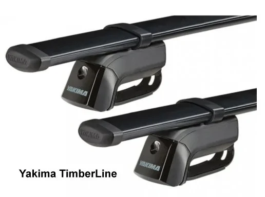

Can these be installed at any point along the rails? I'm considering getting a smaller rack but I'd like to keep it towards the rear so nothing is above the moonroof.
You'd have to go with something like the Yakima Timberline rack towers. They can be mounted anywhere along the open bars on the side rails. That's what I use now on my Escape to carry the canoes and will be transferring them to the Sport. I just have to wait and see where I can place them without interfering with the moonroof.

Should be a minimum of 36 inches apart for carrying canoes and kayaks so the factory bars look pretty much worthless for boats and they don't look all that sturdy. I'm hoping I can attach my Yakima front towers in the first gap on the front and the moonroof won't hit them but it will be close.

If I can find someone locally with type of towers you have, I can ask them if I can throw them on. Send me a pic what kind they are and I'll keep my eyes open :)
Yakima TimberLine Towers:
Ford Bronco Sport Factory (Yakima) Crossbar installed Yakima TimberLin

With the added height from the mounting towers, I just don't see how anything at the crossbar level or above could interfere with the moonroof (except visibility). The moonroof only raises a fraction of an inch above the rails, even fully opened.
Except that the glass is within a half inch of the side rails so the clamps on the towers that go around the side rails might be a problem and when you clamp anything on the cross bars the clearance will be lower. The towers need a couple of inches on the inside toward the glass and the clamps for my canoe brackets hang down another inch below the crossbars. I'm hoping that when the glass first pops up it leaves enough clearance for the front towers on the side rails.
I would love to see a side shot of the glass and the side rails when the glass is first popped up. The dealers here don't have any with sunroofs I can check.
