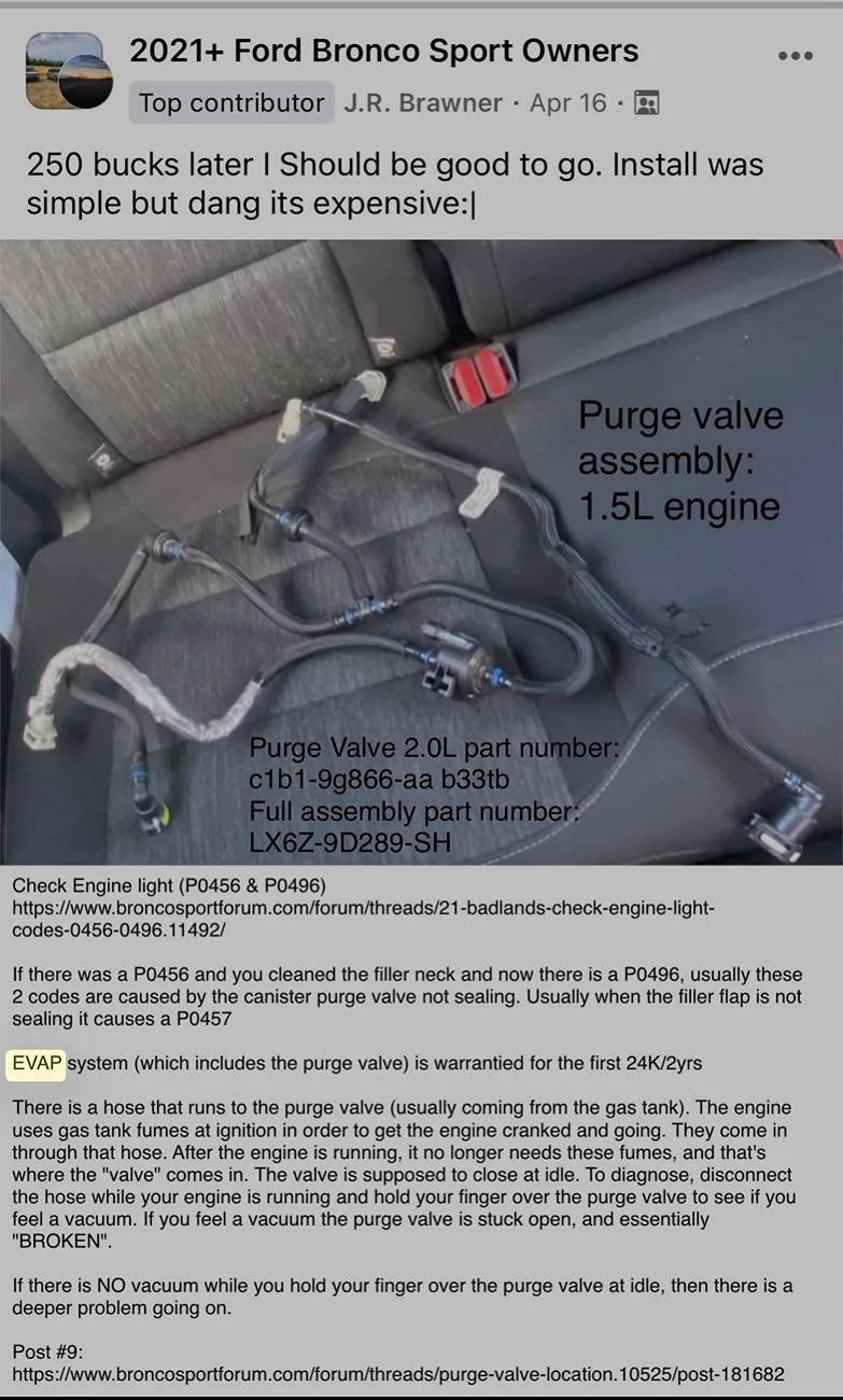

The EVAP purge valve is not covered under the emissions warranty.
This is real easy to replace.

P0456 code may indicate the fuel door is not sealing properly. You may need to clean the area around the fuel filler.
Some people have used WD-40 to clean the filler area. You can also use the white fuel filler funnel located in the spare tire storage area. Spray WD-40 into the fuel filler and insert the fuel filler funnel in and out to clean and lubricate the spring loaded seal.

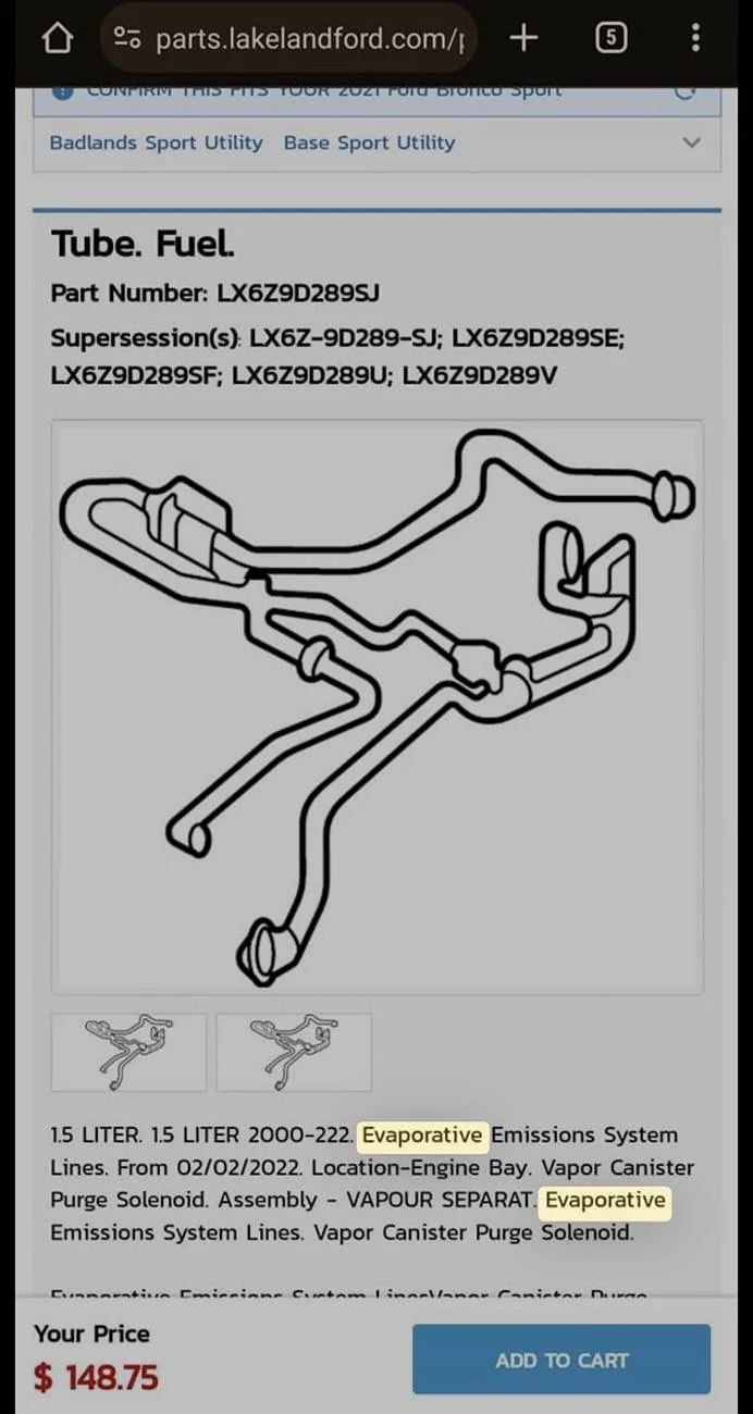

I'll try the fuel filler first. The printout from my local shop shows a loop of EVAP lines under the engine appearance cover that need to be replaced. I can probably handle that. Thanks for the group help.
