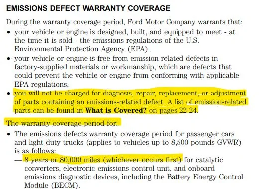

RSH is correct! Directly from the 2022 Ford warranty guide:
Ford Bronco Sport P0496 EVAP Purge Valve Replacement 1755050978993-mz

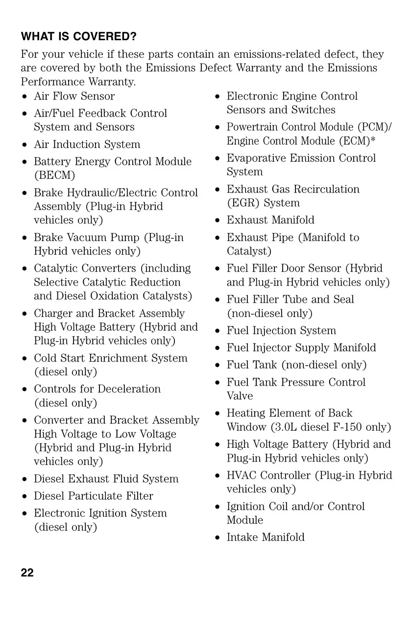

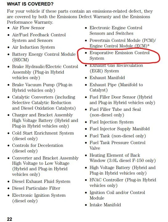

From page 22 (list of parts that are covered):
Ford Bronco Sport P0496 EVAP Purge Valve Replacement 1755050675729-nz
For those who may not be aware, the purge valve's function is connect the intake manifold to the fuel tank and evaporative canister to "purge" the fuel vapors that have been stored in the canister, and that are present in the fuel tank. This allows the fuel vapors that have been generated and stored to be pulled into the engine and burned. It is without a doubt part of the evaporative system, which is exactly why you are getting a check engine light and a fault code! CARB OBD requires that system to be monitored for leaks as small as 0.020" in diamater and when there is "no purge flow from the evaporative system to the engine." All this ensures no fuel vapors escape to the atmosphere. You might need to educate your dealer about what is truly required under warranty.

You could interpret the wording as if it is covered. The problem is the valve itself is an electrical component and does not fall under the other emissions components.
The entire assembly must be replaced. The valve itself is not replaceable.

The dealers are screwing people over (intentionally or out of ignorance, I won't pretend to know which one), but the valve is diagnosed by the OBD system, and the part is required to be covered. It's a required component to meet both CARB and EPA evaporative emission standards. You may have to get forceful, but I'm quite confident it's required to be covered......"electrical parts" are not excluded from the federal emissions warranty. Most of the parts on the list of covered components are electrical in nature (e.g. air flow sensor, air/fuel feedback control and sensors, Battery Energy Control Module, Brake Hydraulic Electric Control Assembly, Electronic Engine Control Sensors and Switches, Powertrain Control Module/Engine Control Module, etc.). If "electrical parts" were excluded, more than half of these parts wouldn't even be on the list.

Is not the dealerships .., Ford documents the covered parts in the emissions warranty
It’s listed online … I’ve read it and there’s some gray area but not to Ford
Here is one link (if interested, confirm for yourself if it’s the current version) and pasted in one of the tables
https://www.ford.com/cmslibs/content/dam/brand_ford/en_us/brand/resources/general/pdf/warranty/2022-Ford-Car-Lt-Truck-Hybrid-Warranty-version-2_frdwa_EN-US_12_2020.pdf
Ford Bronco Sport P0496 EVAP Purge Valve Replacement IMG_8782
Ford Bronco Sport P0496 EVAP Purge Valve Replacement IMG_8783

That is the exact same document I quoted/pasted from.

I did some more digging and I'm confident the purge valve is required to be covered under the federal emission warranty. I was focusing on what the regulations require, not what Ford is actually doing, and i was interpreting the comments to mean Ford is claiming the purge valve is not a covered part under the emission warranty. As I'm sure you can imagine, what Ford is required to do doesn't necessarily have to align with what they actually do. This is what I thought may be happening.
However, I think I may have uncovered the real reason why users are getting the response they have received from Ford on this part I believe the 80/80,000 portion of the federal warranty only applies to select parts and the remainder of the components covered under the federal emission warranty are only covered for 2 years/24,000 miles. This means the federal emissions warranty is essentially useless (except for those specific parts called out under the 8/80,000 section) as long as Ford continues to offer bumper to bumper for 3/36,000.
So, the part is technically an emission related part and is required to be covered, but i don't believe it is covered for 8/80,000 miles.
I will post references to the federal regulations to confirm this later. For my sanity, I believe the reason why Ford has not been covering it is most likely because the vehicles exhibiting the issue are beyond the 3/36,000 (and by default the 2/24,000) and not because the part is "electrical and not covered by the emission warranty." It's a subtle difference, but I wanted to understand why the text didn't align with the response. Maybe users can chime in if they have examples where Ford is not covering it within 3/36,000. This seems unlikely based on the definition of bumper to bumper... unless they want to claim the purge valve is not between the bumpers!! 🤣
Note: Customers in CA should have a much better leg to stand on as their emission warranty requirements are much stricter.
Stay tuned for regulation references. I'm not at home so I will post these as soon as I can.
