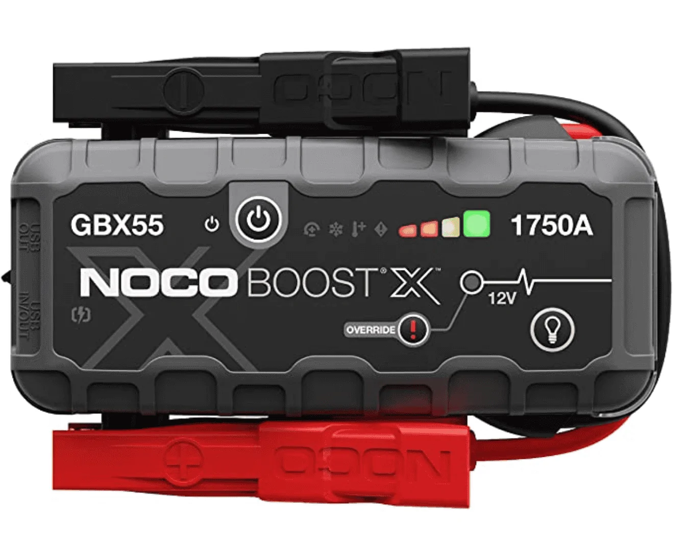

I just picked up one of these for those DEAD BATTERY events. It can start up to a 7.5 liter gas engine and up to a 5.0 litre Diesel engine!
Ford Bronco Sport Emergency starts! Screenshot 2022-05-16 at 10.39.37 PM

These things are the greatest thing since sliced bread, I've jump 3 cars for people this winter.
Keep it in the vehicle and charge it up every 3 months just in case.
I've only had to use it for my mower this spring, forgot to charge the mower battery before storage, sure beat's dragging out the cables.

Is this one kinda the one to get? I keep looking at these every year as they seem like the ideal jump start solution. No cables, no worrying about hook ups. No waiting for AAA when the weather is bad & absolutely everybody needs a boost. Just use it & go. For yourself or anybody that asks if you have a set of cables to help them out. I’m assuming they can start any vehicle even one that’s deader than dead.

Is this one kinda the one to get? I’m assuming they can start any vehicle even one that’s deader than dead.
These things are great but no not every dead car can be started.
When we hook up with cables for a jump sometimes we have to wait a bit while the running vehicle put a little juice in the dead car.
I can’t count the times the first attempt was a no go.
But the ease of use looks to be a bonus in itself.

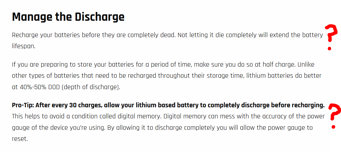

https://northeastbattery.com/prolong-lithium-battery-life/
Ford Bronco Sport Emergency starts! 1652796671366
From the linked article
The 30 charges seems to be the key to resolve the conflicting statements
I have heard from multiple sources that Lithium based batteries should never be fully discharged. I still think that the information posted is in conflict. Most sources I have seen say that Lithium batteries should be kept between 40% and 80% charge for the longest life. Allowing it to completely drain is very very bad for the battery, charging it to 100% and holding it there is just kind of bad. The 40-80% rule is just for maximizing battery life. I try to use that range for my cell phone.

I also just got one. Haven't had the need to use it yet, for myself or anyone else... but it's reassuring to know it's nestled in the back. Also have a rechargeable air pump.
I'll agree with your statement
However component properties of lithium batteries is out of my wheelhouse
The deep cycle 12v I use for a solar back up generator say no less than 50%
Inverter auto cut-out engages at 50%
pulling those batteries below that threshold is the death knell

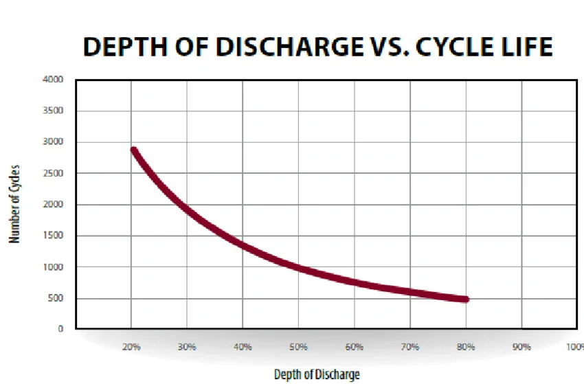

Deep cycle lead-acid batteries (like golf cart/GC batteries) have different requirements from lithium. For lead-acid, 50% SOC (state of charge) is the commonly accepted low limit. However, that does not mean a lead-acid battery will be an unusable paperweight if it drops below 50% SOC. 50% is just a point on a graph:
Ford Bronco Sport Emergency starts! 1653334711854
The numbers will vary some, that graph gives a rough idea. You can see that you can discharge a lead-acid battery 70-80% (20-30% SOC) and it will still give roughly 500 cycles -- but if you can hold it to 50% it will last for about 1,000 cycles.
Clearly it's best to keep the depth of the discharges to a minimum -- but that often only works on paper, because you need a certain amount of power in actual use.
That's true, but it applies to 'raw' lithium cells. You can purchase raw cells and build your own lithium battery cheaper than a "pre-packaged" one, but in either case, they must have a BMS (battery management system) to protect the cells from overcharge; excessive discharge; high charge voltage; excessive charge/discharge current; and temperature extremes.
The BMS should prevent the SOC from reaching a true/actual 0% or 100%. That's in the mfr's best interest, because they have to warranty the batteries -- in our case for 'life', which is considered to be a minimum of 3,000 cycles -- while still maintaining at least 80% of the original Ah (amp-hour) capacity.
Mfrs typically don't give the actual SOC levels the BMS shuts off at, but as long as the battery capacity (in Ah or watts) and service life is as claimed it doesn't really matter. Still, just out of curiosity it would be interesting to know the actual (full) capacity of the cells. Our batteries are rated 105Ah @ 12.8V, but I'd guess they may actually be (say) 125Ah with an unused 10Ah at either extreme.
Bottom line, these devices are most likely well protected. The mfr knows that most people will either -- a) charge them fully every so often, b) leave them plugged in, or c) forget about them and never charge them (rather than maintain them at ~50% SOC). They must account for that. Then again, IDK what the typical warranty is. If it's one -(1) year, almost any lithium battery will last that long, no matter how it's treated.
