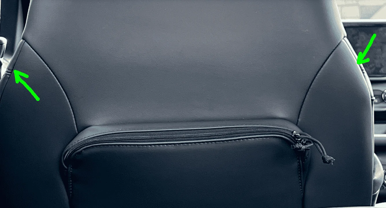

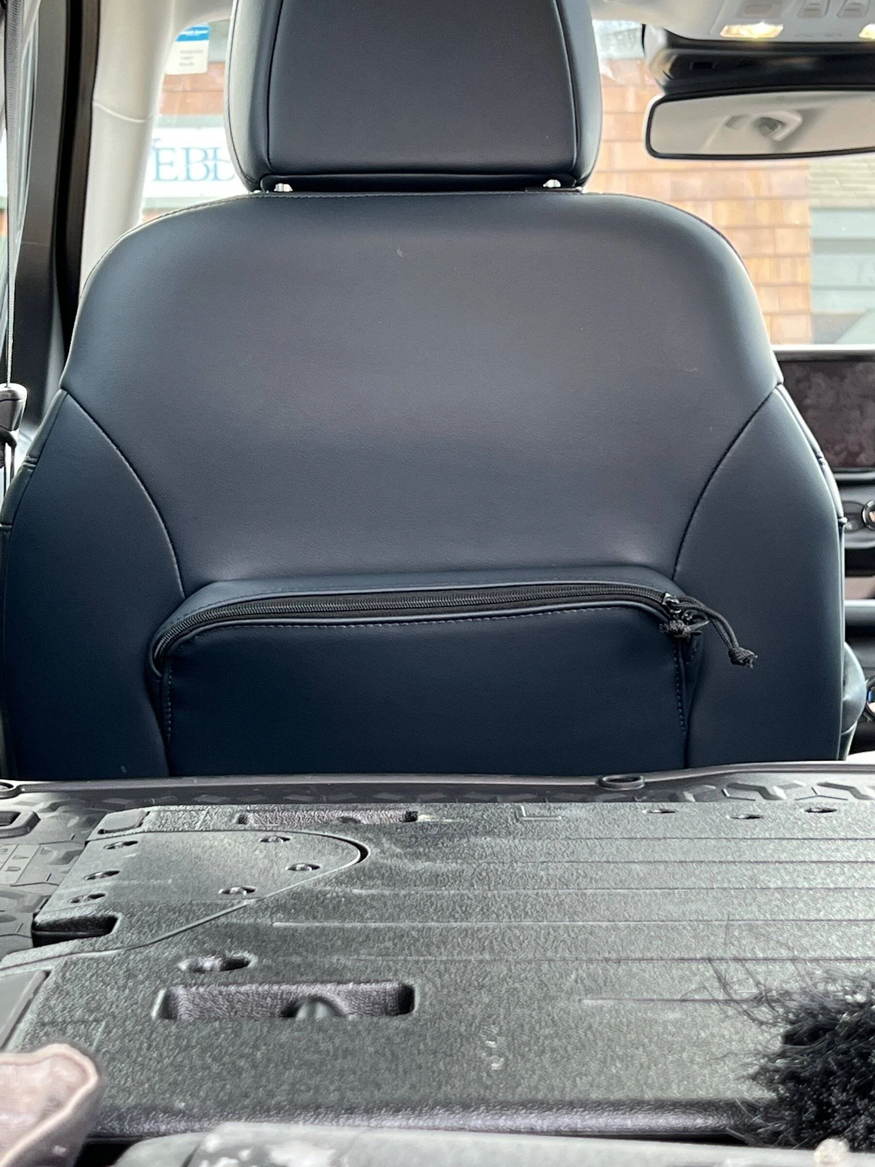

I put down my back seats to try and get a view from the back. The chair leans to the left for sure. Also wtf is up with my back zipper pocket? It doesn’t look like how it’s supposed to be positioned in other broncos? Checked out an OB yesterday and that tipped me off that the seat should be much more comfortable still and that my zipper pocket looks like it was yanked out of its holding space.
Ford Bronco Sport Driver Seat Cushion Lobsided/Giving Out? EA18FF30-9579-4A11-A9A4-E2E37C6549ED
Ford Bronco Sport Driver Seat Cushion Lobsided/Giving Out? 027B4D26-E984-4837-8247-FECF146447F4
Ford Bronco Sport Driver Seat Cushion Lobsided/Giving Out? 1651524871945
Right side stitching rides on top of "shoulder"
Left side stitching rides below "shoulder"

Thanks for validating that.
Also, for all bronco owners, is my pouch supposed to be popping out? It’s inserted on my passenger seat.
