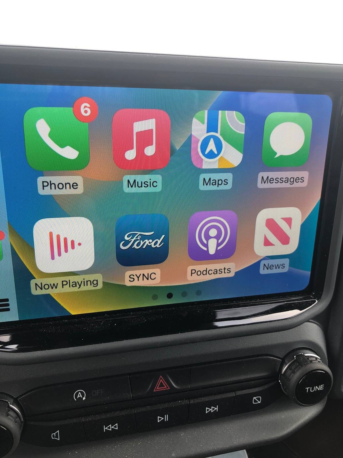

Post a pic please, for example using CarPlay the Ford Sync button looks like this but maybe you use Android Auto

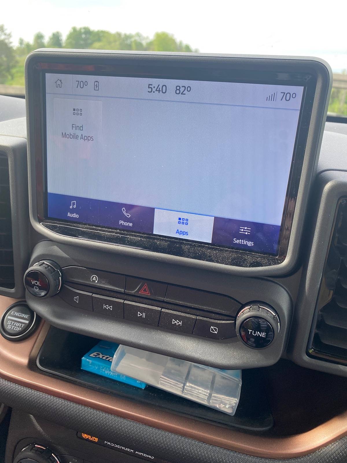

I use an iPhone and Ford Sync is gone. I can attach iPhone and get to apps on phone but to get to Sirrus for example I have to disconnect the phone. On no screen does For Sync show up.
I removed my iPhone 8 and reconnected via Bluetooth as well.
I can deal with it but don’t understand what changed.
Per the other post I did pres the button suggested, it changed
Screen but didn’t bring back the screen with Ford Sync, just a clock or blank.

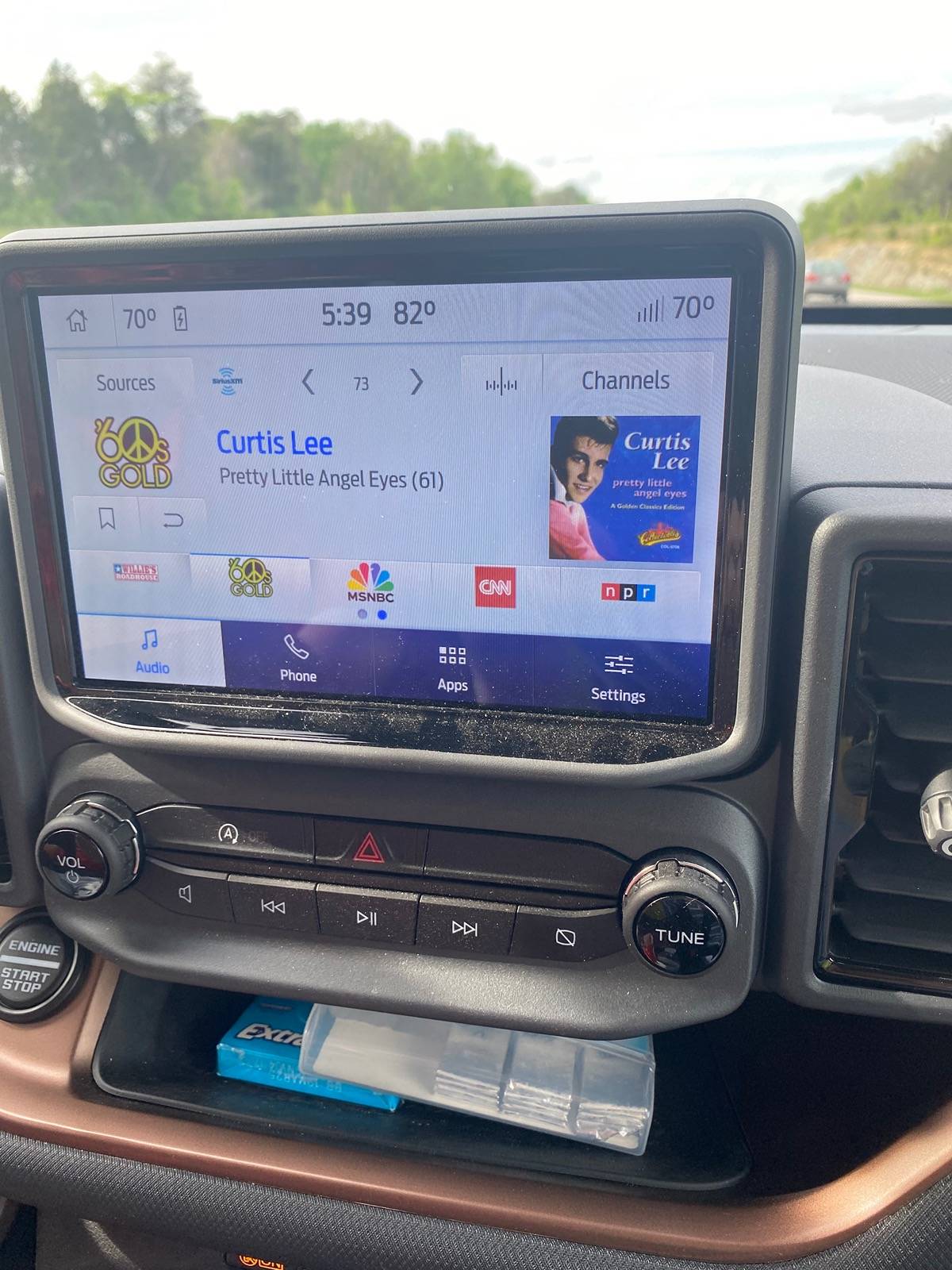

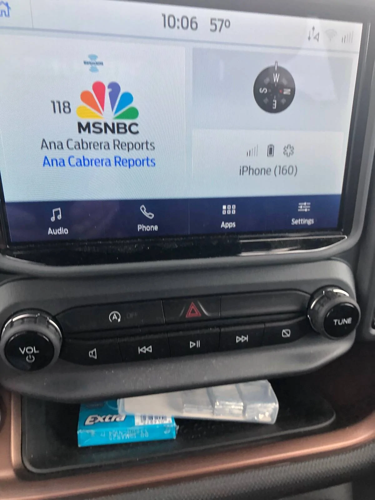

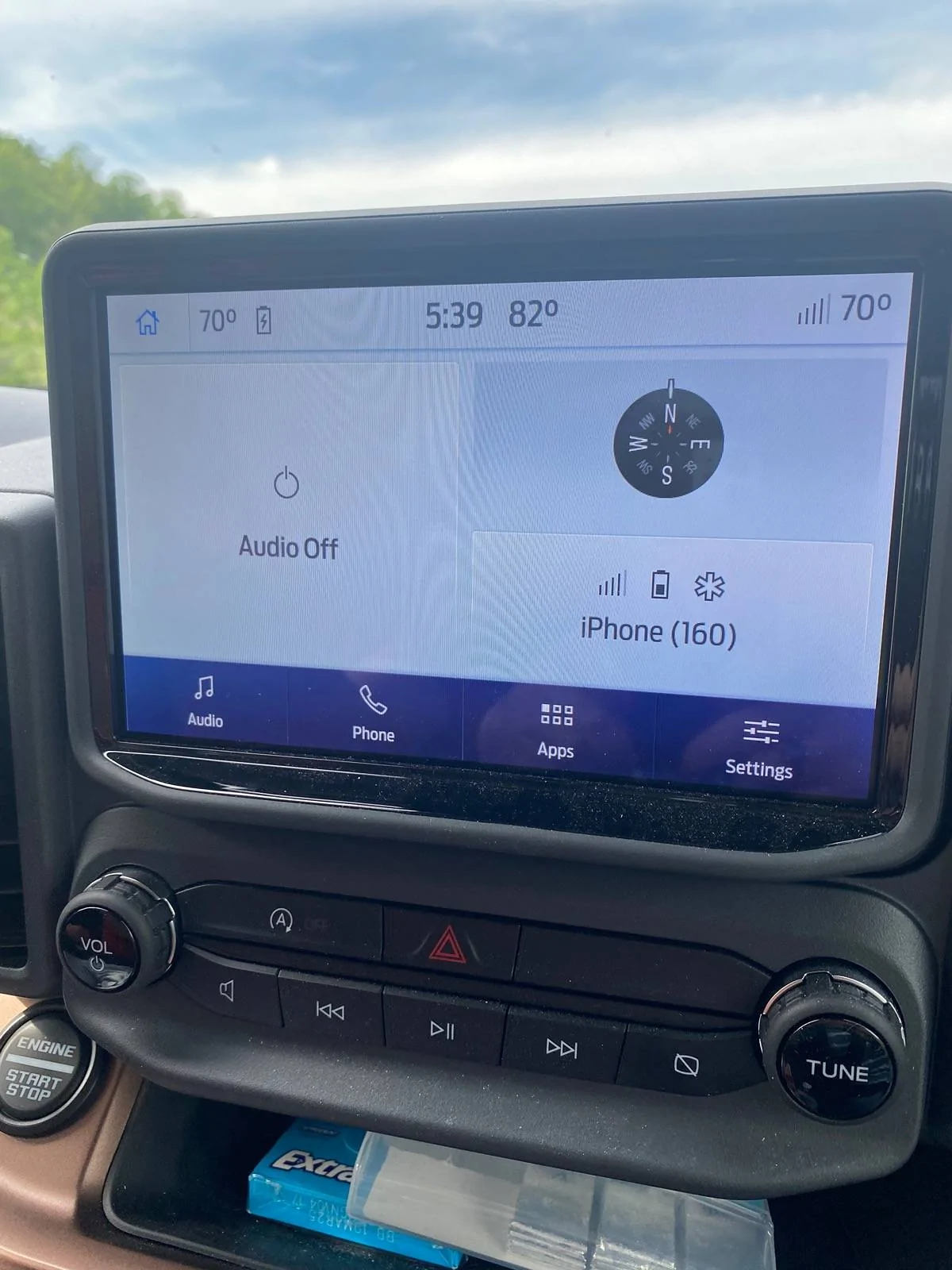

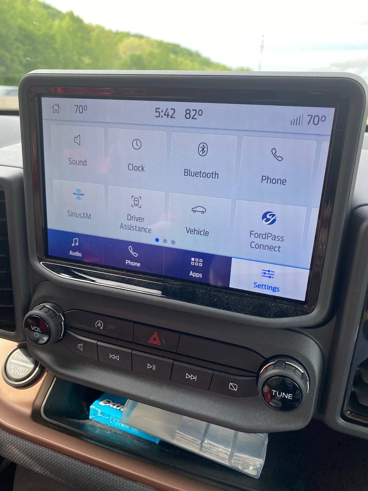

here are my screens
Ford Bronco Sport Ford sync disappeared off screen 2022 Bronco sport IMG_3774
Ford Bronco Sport Ford sync disappeared off screen 2022 Bronco sport IMG_3775
Ford Bronco Sport Ford sync disappeared off screen 2022 Bronco sport IMG_3777
Ford Bronco Sport Ford sync disappeared off screen 2022 Bronco sport IMG_3780
109
4,391
5,120
@Kozz as far as the 4 screens you posted nothing changed there - all 4 are the Sync screens

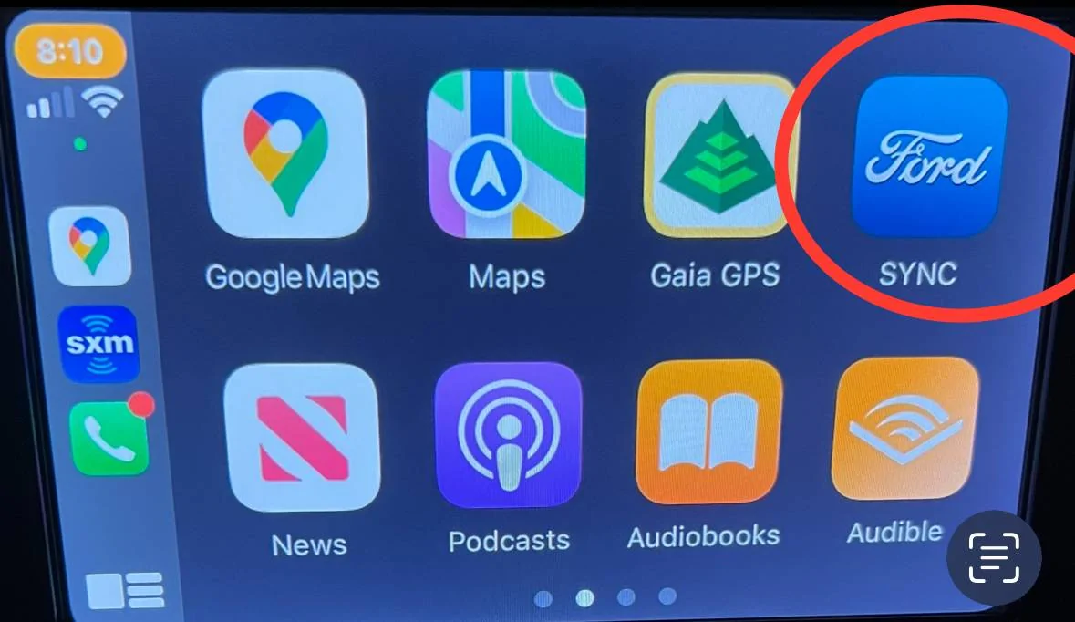

With your iPhone I think you are referring to use of CarPlay - see the CarPlay screen I posted in Post #3 where Ford Sync is circled?
If you are not seeing the CarPlay screen …
1. Make sure you are using an Apple certified USB Cable and are plugging your iPhone into one of the USB Ports below the 8” Display. With your vehicle running or in Accessory mode, plug in your iPhone and CarPlay should come up.
If you cannot get CarPlay to come up, you can:
Unplug your iPhone and power down the iPhone
Remove your iPhone using Settings on the 8” Display
Power up the iPhone (do not plug it in)
You should then be able to re-pair your iPhone to Sync (which is over Bluetooth)
Once that is done, plug in your iPhone and CarPlay prompt should come up
There are other things to try like making sure your iPhone is up-to-date (iOS 17.4.1 or latest), make sure Sync is up-to-date (currently 23188 or later)
Then post more info regarding what happened when you tried the above.

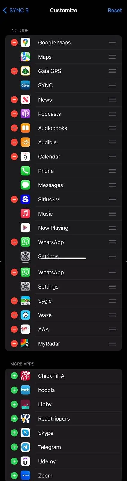

@Kozz to change what is shown on the vehicles CarPlay screen:
on your iPhone go to:
Settings > General > CarPlay then click on the name of your vehicle (mine is just the default SYNC 3) then click on Customize
You can order the items you wish to see and hide any you don’t want to be displayed. For example the pic shows mine:
