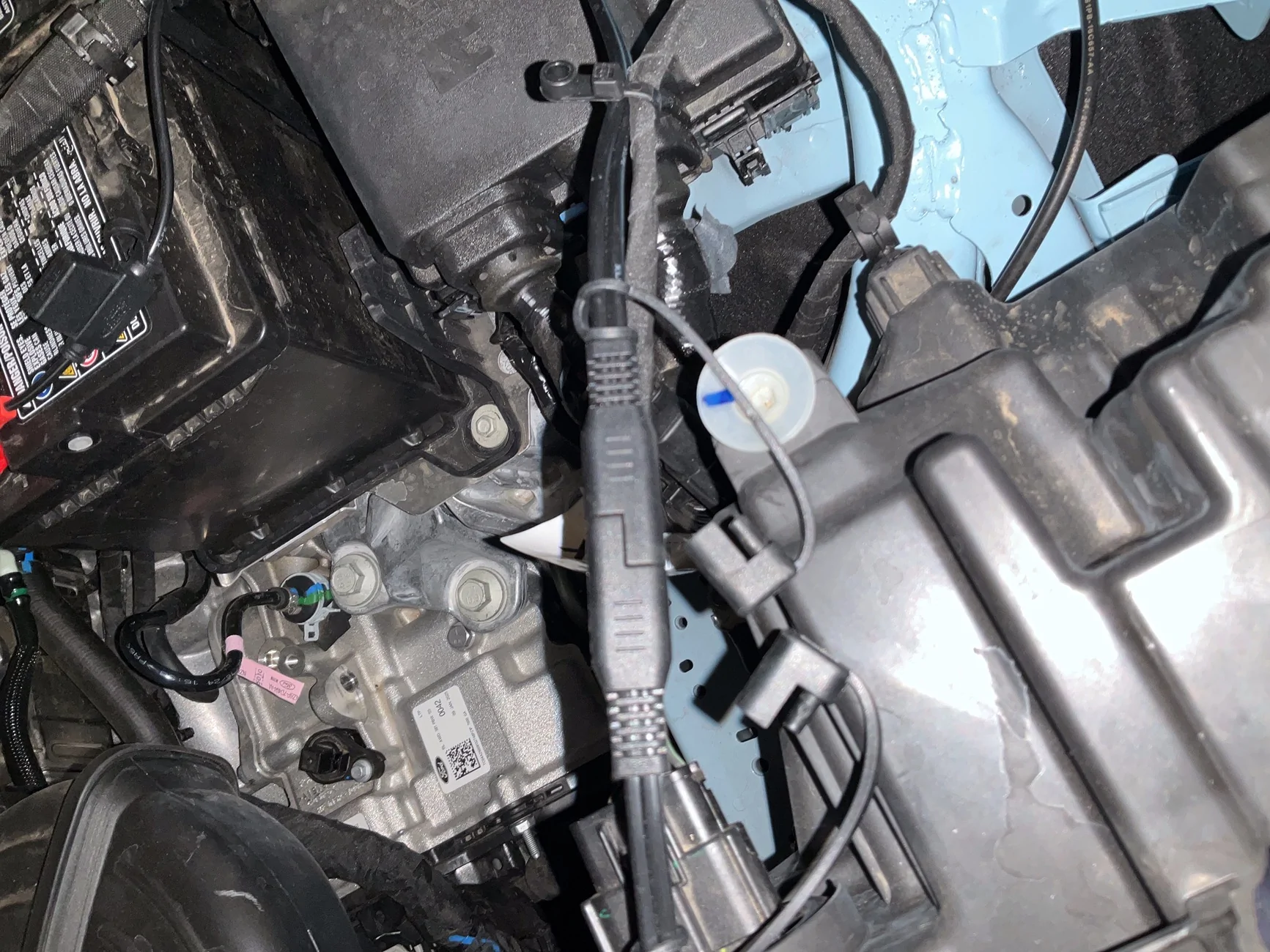

I have a 5 amp trickle charger and I installed a quick connect cable.
I just charged the battery today.
It took 6 hours.

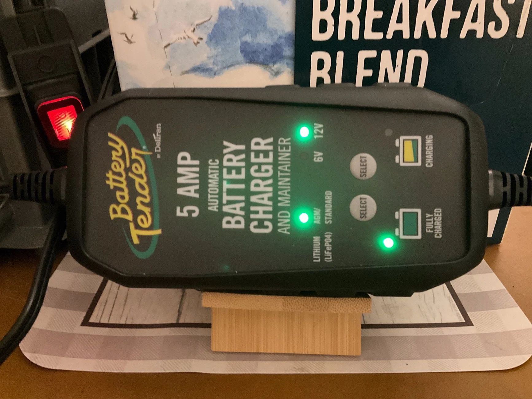

I use the same Battery Charger/Tender. I recommend: Connect the negative lead to a clean chassis ground (not directly to the battery's negative terminal) to ensure the vehicle's Battery Management System (BMS) or current sensor accurately tracks charging.
Also, unplug the Tender from the wall outlet once a week for ~30 minutes. This resets it from maintenance ("tickle") mode back to full charge mode when reconnected.
This helps maintain optimal battery health, especially in vehicles with BMS monitoring.
It took 6 hours.
That's what I have on my vehicle. A semi permanent installed 5 amp charger and it's plugged in anytime I'm not using the vehicle for more that two days.

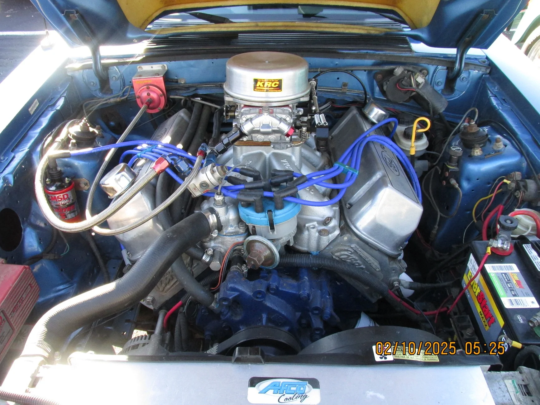

I don’t trust plugged in electronics left on for lengthy time periods, i probably would just disconnect the negative cable
X2!! I just started My Mustang on Tuesday the last time I had it started before Yesterday was Jan 8th.The 466 BBF cranked over and started fine although I have a quick disconnect on the Positive cable and it was 10 below zero here a couple of nights between Yesterday and Jan 8th FWIW it sits in the unheated garage not outside.
