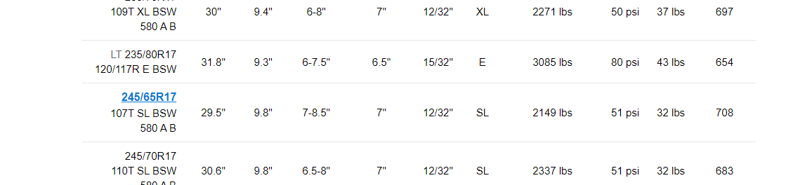

Check out TireSize.com. They typically have pretty well every tire's specs on that site. For instance, this is what they have on the Goodyear Wrangler TrailRunner AT:
Ford Bronco Sport Decisions for new tires 1690669550969
At 245/65/17, it is only 32 lbs.
