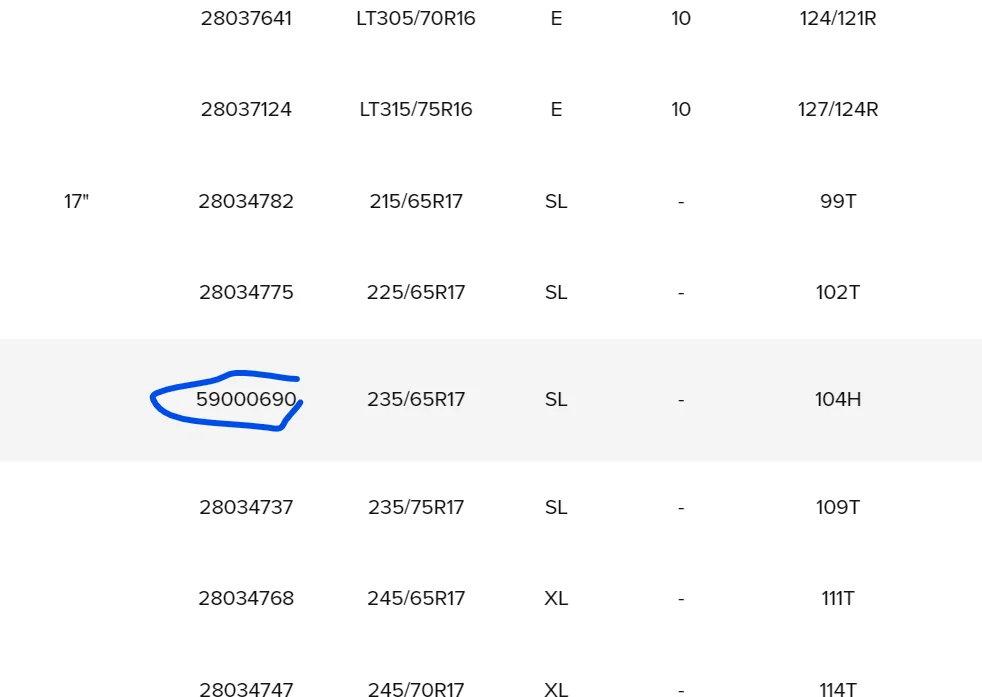

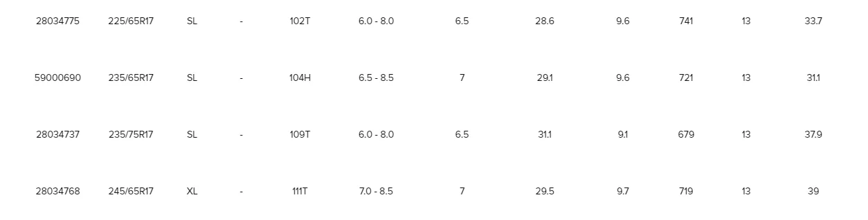

Can't speak for Mark S, but I got my 235/65/17 AT3W from Discount Tire and they are the same as the OEM tires direct from Ford. I keep seeing commentary that there are non-OEM 235/65/17 AT3Ws, but I have never seen any evidence of this. I think Mark S is correct when he stated that Falken just did not manufacture this size before Ford requested it. The only 235/65/17 Wildpeak AT3W is the same as the OEM tire, which can get aftermarket as I did. This direct from Falken's own website, they only list one set of specs at 235/65/17:
Ford Bronco Sport Decisions for new tires 1690291674859
https://www.falkentire.com/wildpeak/at3w#size-list
Ford Bronco Sport Decisions for new tires 1690291628824

I looked on Falken's website, and I can only find one size 235/65R17 tire for the Wildpeak AT3w. I don't believe Falken makes more than one version of this tire size. It's not unusual for a tire manufacturer to make one-off tire sizes for OEM use by an auto manufacturer. I've read in the past that auto manufacturers sometimes patent specific tire sizes.
At any rate, all the specs for the OEM 235/65R17 tire (as well as all other sizes for the Falken AT3w model) are listed in the table (scroll down) on the page linked above. It's publicly available data--no hidden gotchas.

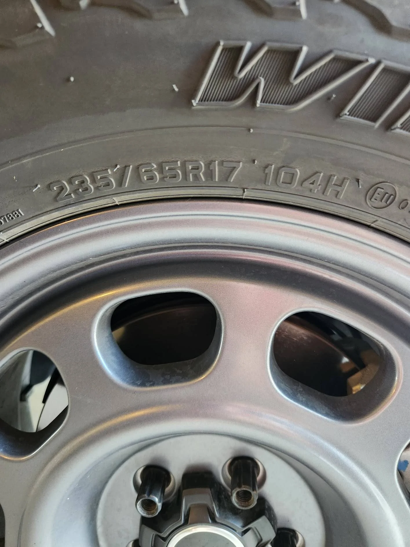

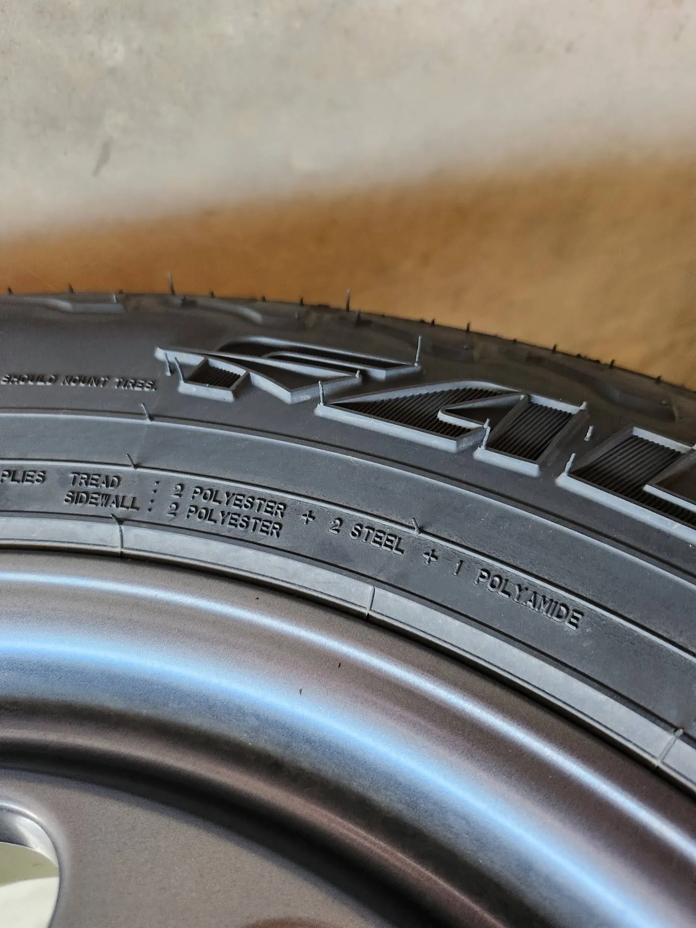

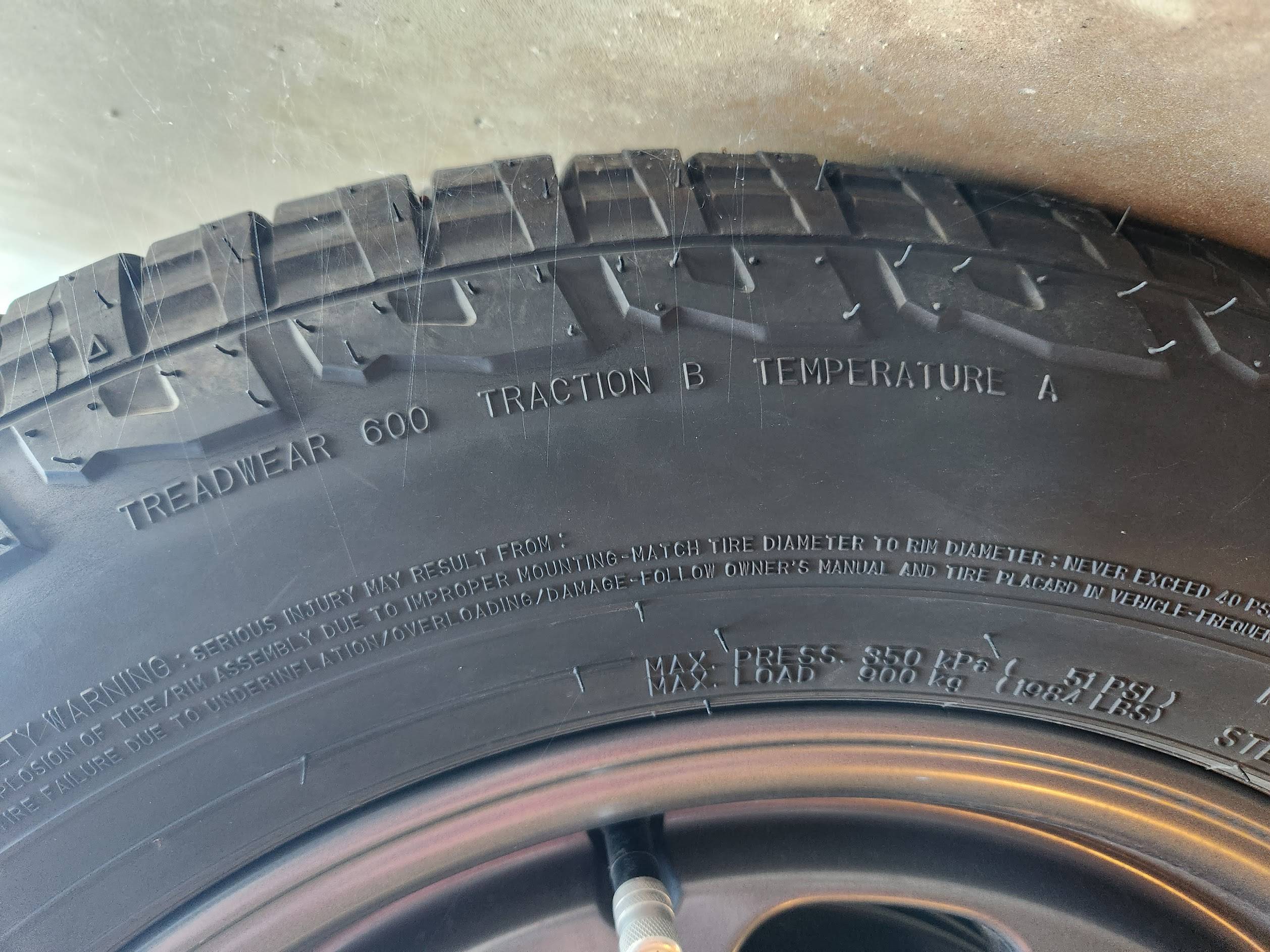

The tire at your link is the same as the one listed on Falken's website for the size we are discussing. Here's a link to the same size sold by Tirerack. Here are pics of the tire installed on my car:
Ford Bronco Sport Decisions for new tires TQsUCob2JW9iJBCETuLIWk=w1415-h1886-s-no?authuser=0
Ford Bronco Sport Decisions for new tires Jrax66cLzymtRwu-9RgHqo=w1415-h1886-s-no?authuser=0
Ford Bronco Sport Decisions for new tires qhTc38eg6Q2OOziOJ-D4H0=w1415-h1886-s-no?authuser=0
Ford Bronco Sport Decisions for new tires CIv4YOHpVFriP-2ieIDTHQ=w2515-h1886-s-no?authuser=0
All of these specs match the specs listed by Falken on its website as well as the specs listed at tirerack.com.
I don't believe Falken's rep said it sells more than one version of the 235/65R17 AT3w. I believe he said you can purchase non-OEM versions of the AT3w, such as the 245/6R17 that many here have purchased.

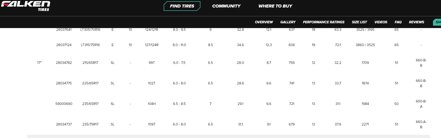

So called Falken and got clarification.
If you look at the Falken A/T3W size list on their website.
The tires with the product number beginning with the 280 are the actual A/T3W designed per Falken's spec tire.
Tires with the 590 number are tires that have been redesigned to meet the car manufacturers required specifications for an OEM tire.
235/65r17 is only available in the Ford OEM tire spec.
This is why people that have chosen the 235/65r17 are getting a smoother/quieter ride than what you would expect from an A/T tire.
