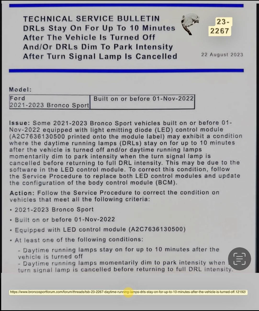

Are you experiencing any cases where the headlamps remain on past 10 minutes or is the issue for you sometimes only the DRLs stay on past 10 minutes no matter which Sync Setting timeout you have selected?
If it’s only DRLs, perhaps TSB 23-2267 applies to your vehicle?

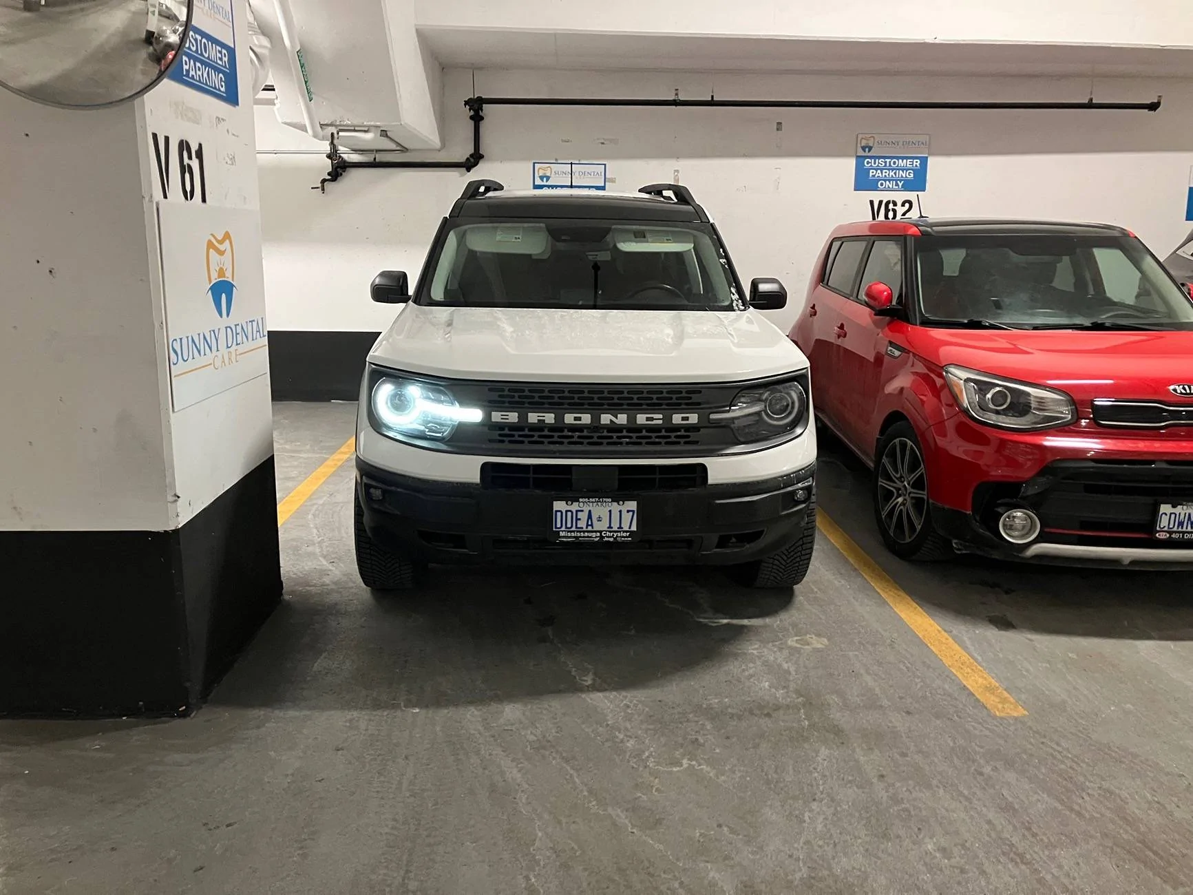

I thought I saw a thread on this earlier, however I couldn't find it.
I've noticed that when I shut off the vehicle (BS Base) and lock the doors (via key fob) that things shut off in a sequence....interior lights, then guages, then headlights (if night) and lastly the daytime running lights. Problem is that occasionally (say 1 in every 10 shut downs) the daytime running lights will stay on. I then have to re-open the vehicle with the key fob, then lock it again...then everything shuts in the sequence including the daytime running lights.
I've come to the conclusion that today we drive computers rather than automobiles...likely a software glitch. Any one else experience this?
