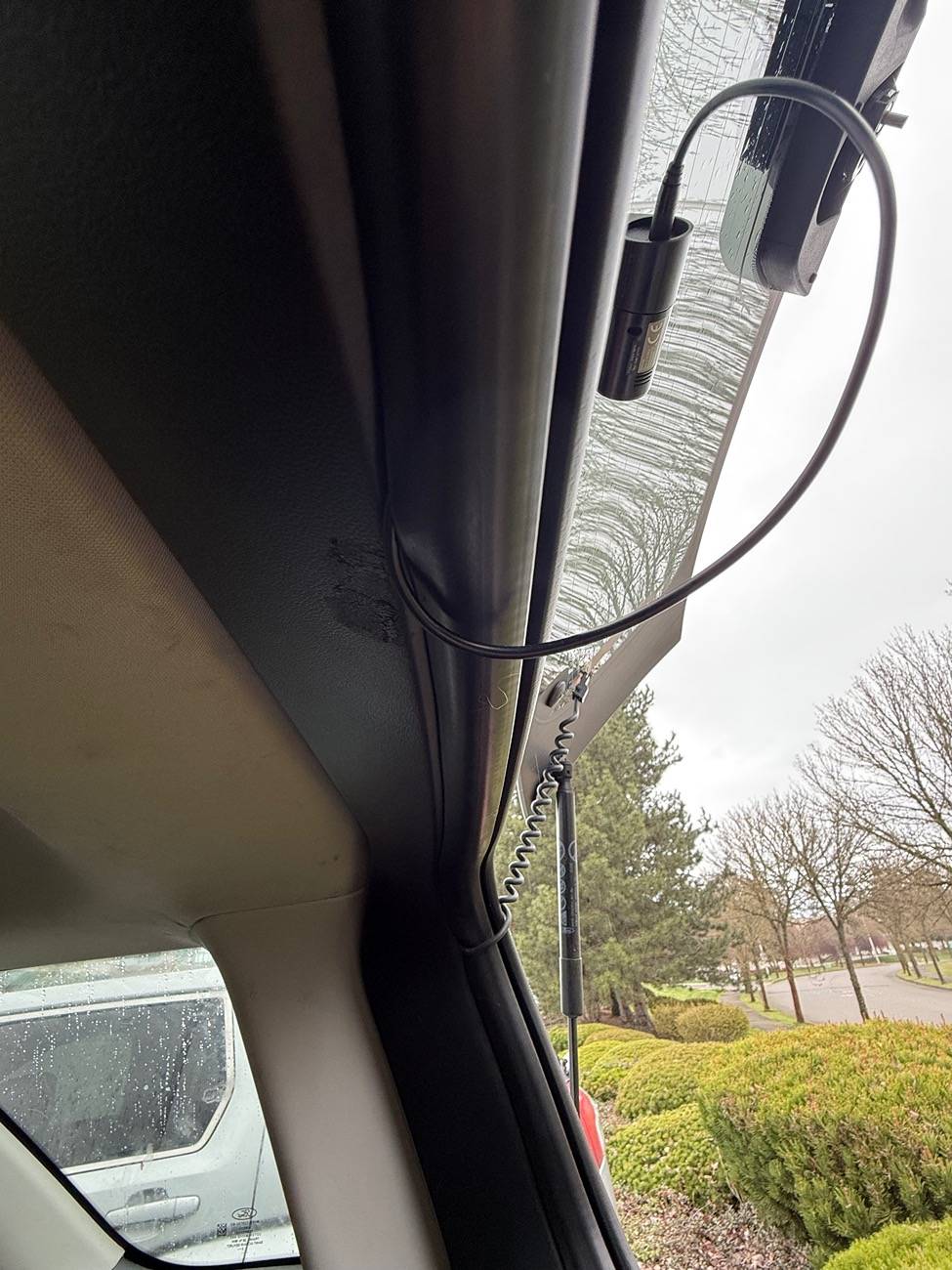

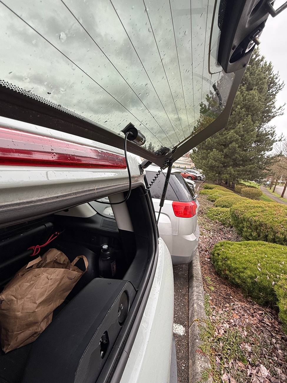

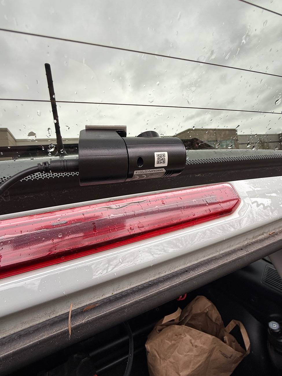

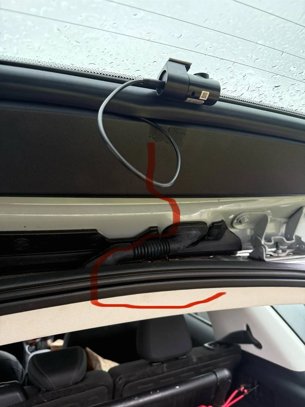

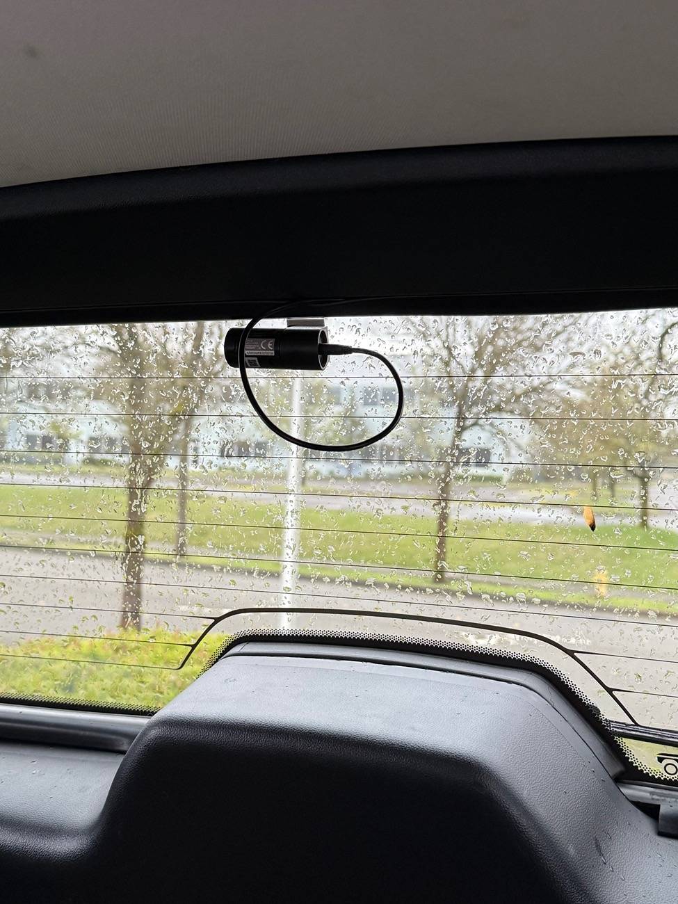

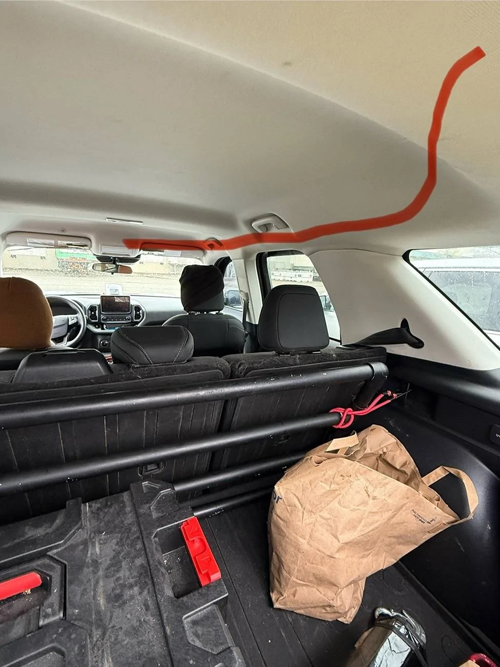

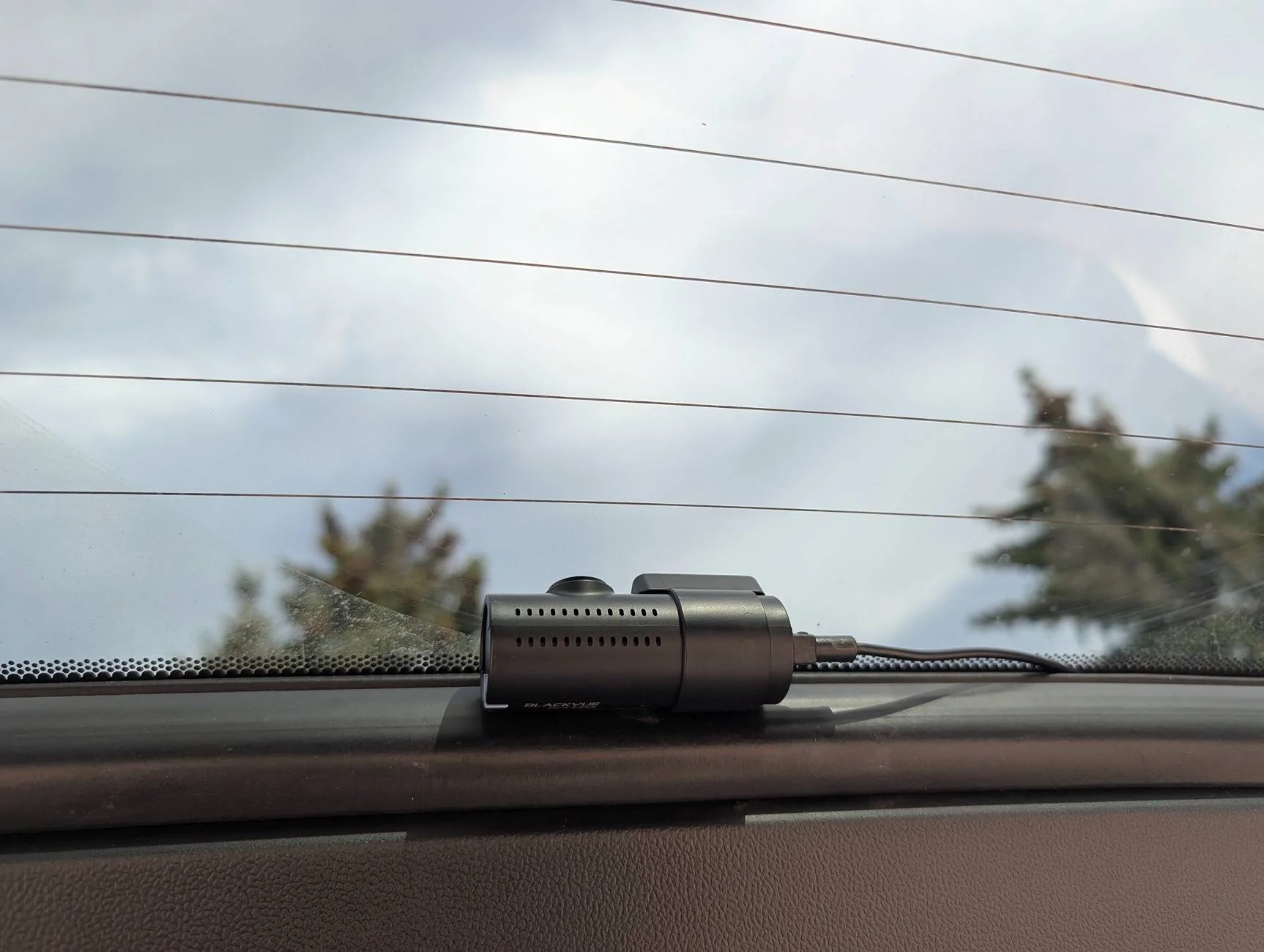

I will say. It’s the most efficient route in terms of opening the glass with no issues but getting it through that rubber boot was an experience. I fished a guitar string through the boot and pulled the camera wire back through. Also used an electricians fish tape and pulled down the roof from the rear opening and pushed it through til I could grab it from rear passenger door roof than pulled the camera wire straight over to the rubber boot/grommet
Also gotta be careful to keep the camera wire behind the airbag curtains so as not to inhibit them from operating correctly when needed

That’s great for the rounded ones with a mount like that. But most that I have seen would not mount like that. They are meant to mount like above license plate. The bracket would not accommodate sticking on window. But that’s a great mounting job!
i dont know of any rear dashcams that mount outside of car, back up cameras do but dashcams are always inside window
