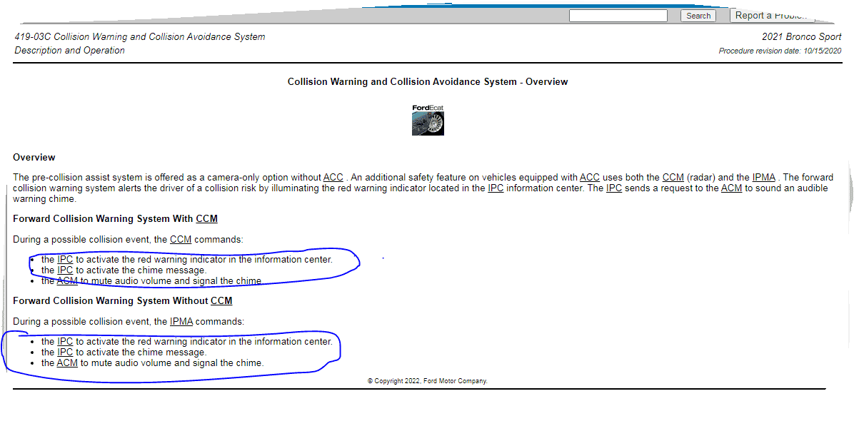

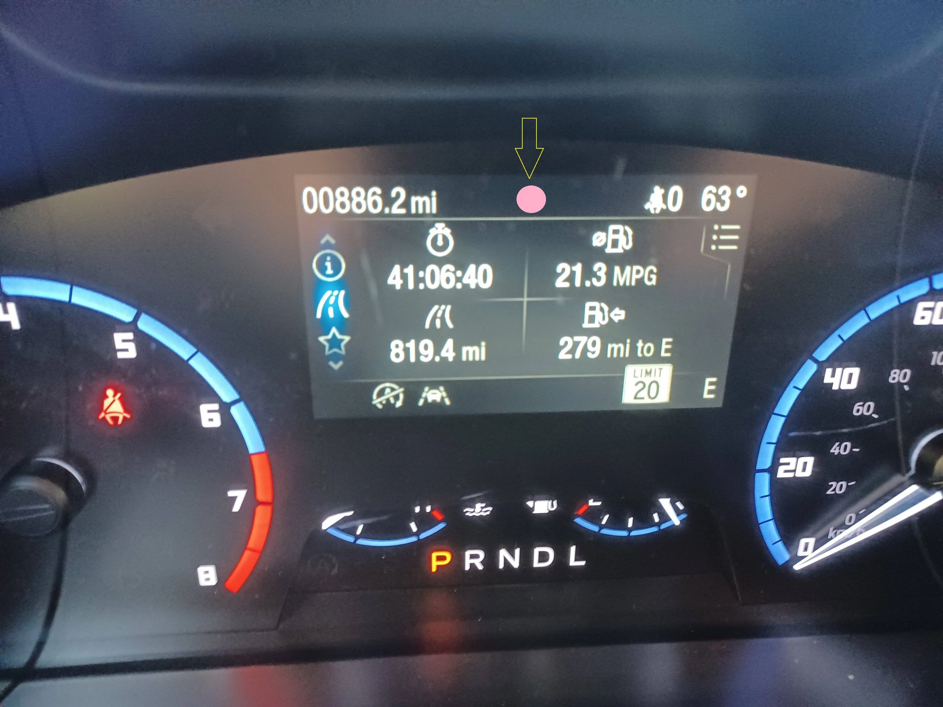

As you can see from the pic... I don't have too many miles on my BS. Twice now, a red or pinkish indicator light came on at the top of the Information Display. It looks to have an infinity symbol or something in it. It came on while driving and it goes away by itself, so I didn't get a good look. Does anyone know what this indicator is for? I can't find it in the manual... Thanks in advance.

I know mine shows a similar symbol when following too closely to the car in front of me.

Maybe that's it... But, only at above a certain speed? I have to test it out. Thanks!

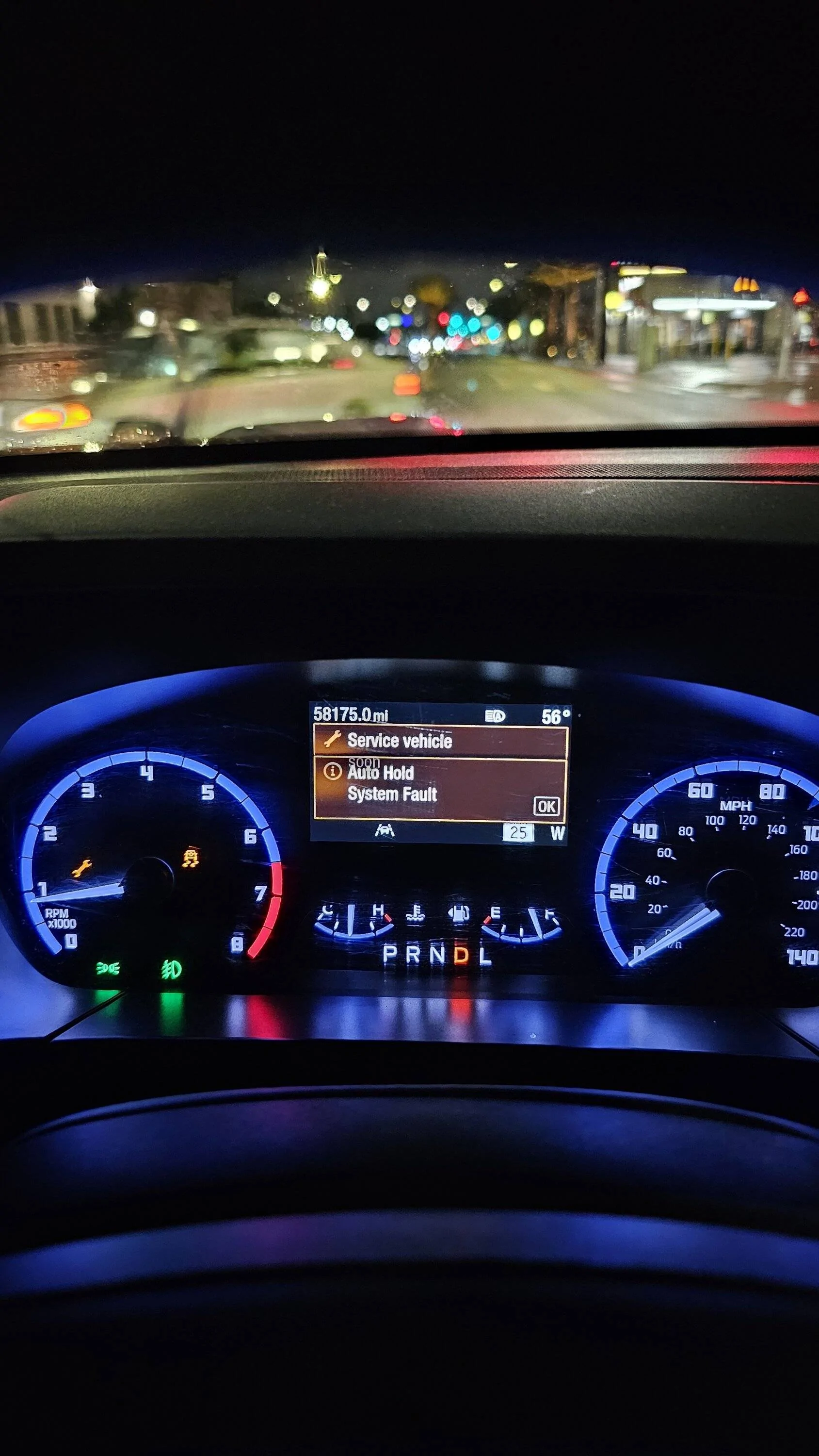

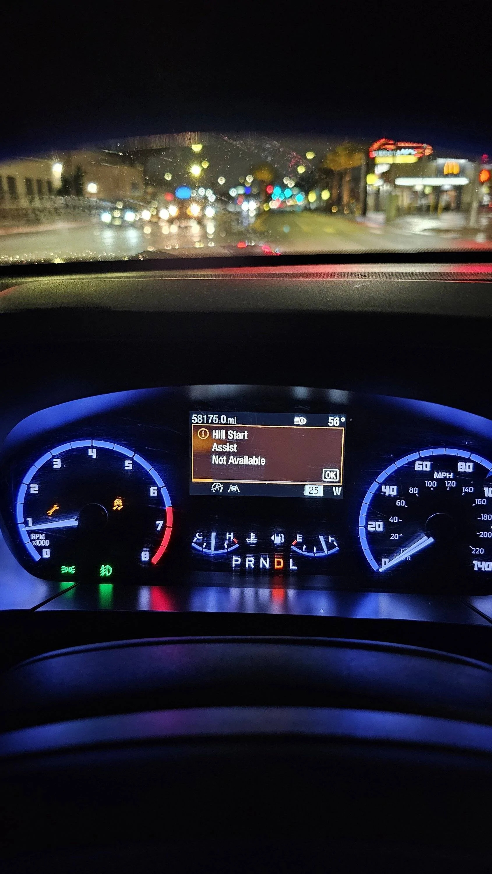

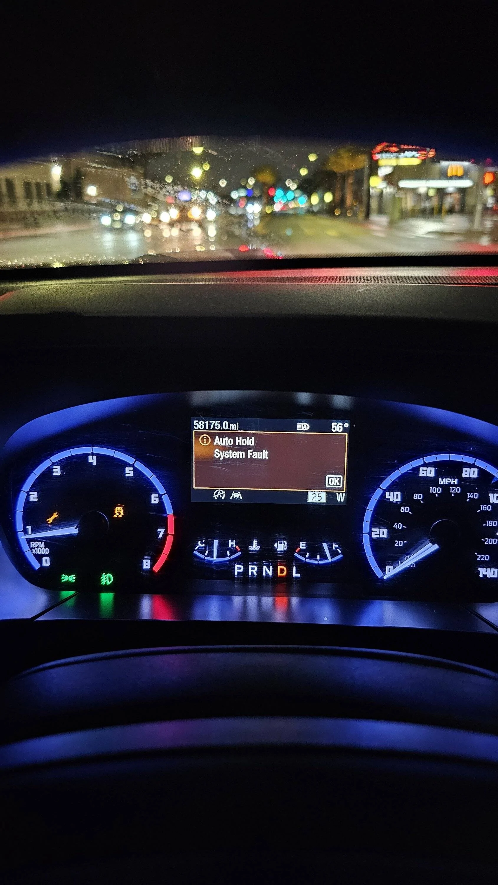

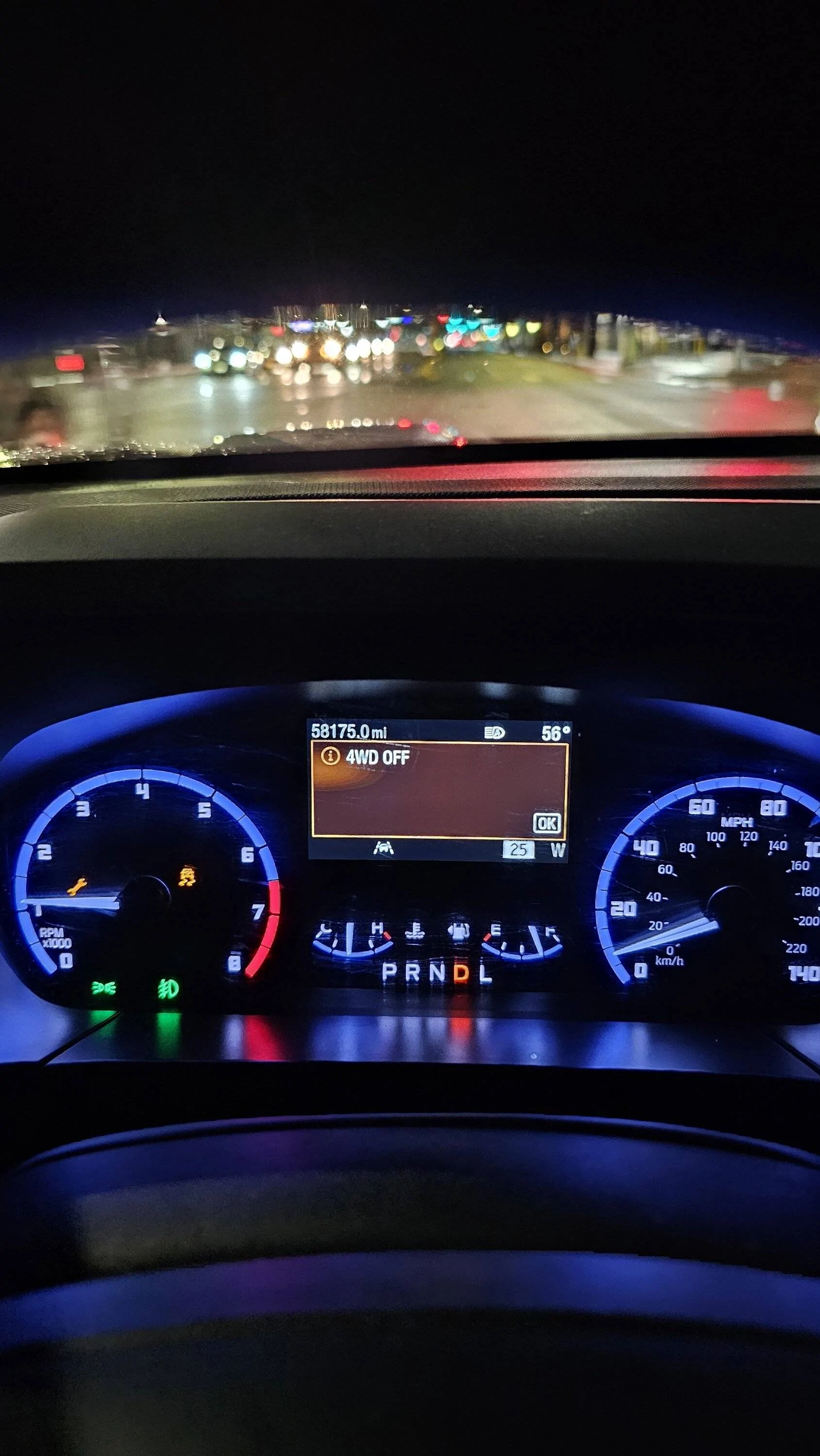

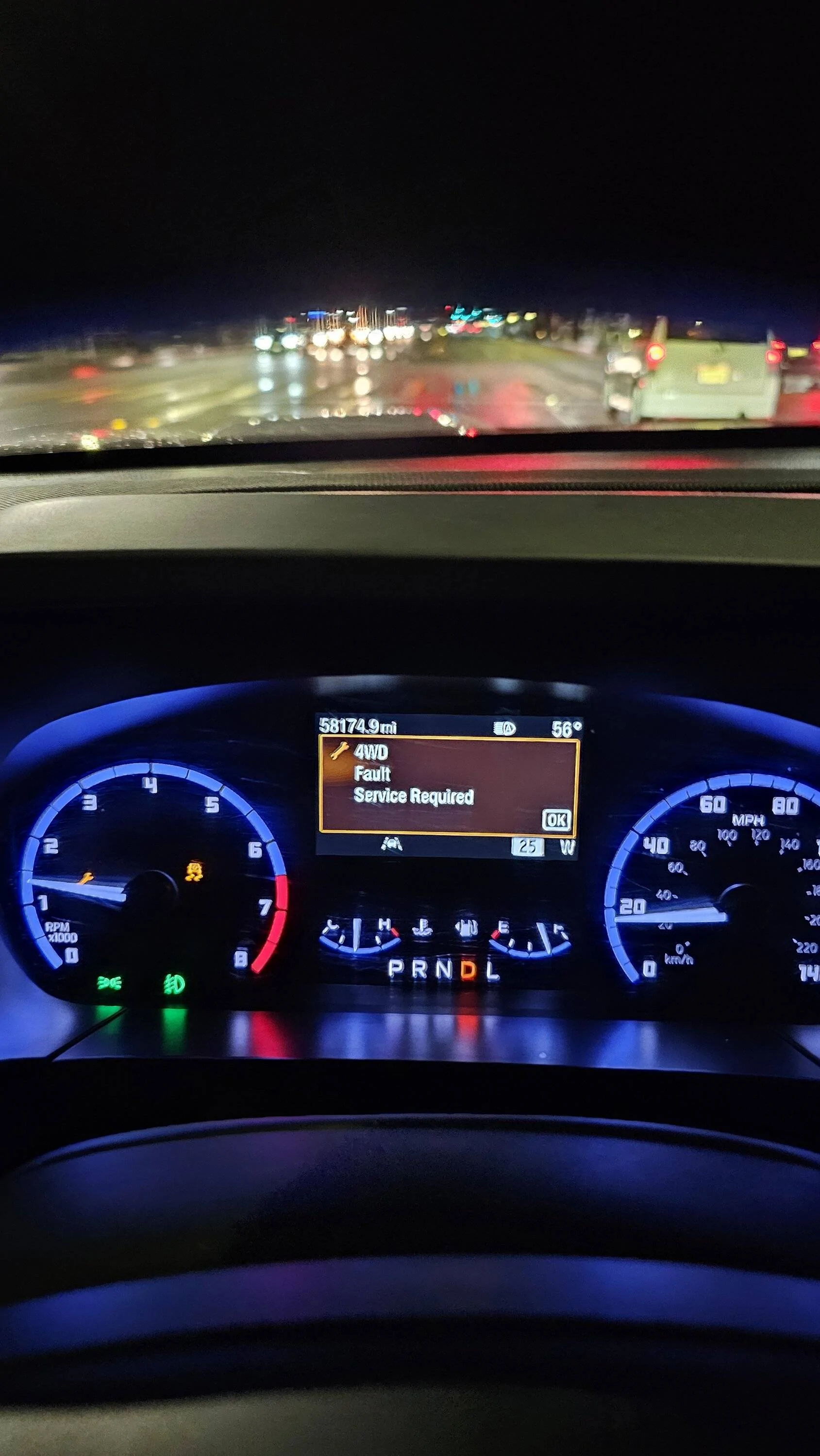

I've had this problem for the last 2 days. It has been raining but nothing compared to the last storms we had a few weeks ago in Los Angeles.
It sometimes come on right away. Then when I turn off the car and on the go away. Sometimes they come back after a 5 min drive or a 30 mile drive.
Has anyone resolved this problem, hill assist, 4wd not available, 4wd service, collision fault

I dropped off the car at Colley Ford in Glendora, Ca. They said they need it for a couple days.
I have extended warranty. So I hope it covers. They said if it qualifies for warranty then my rental would be covered but it has to be a Ford car. (I'm in a 23 Ford Edge Sel)
So far I'm $175 out of pocket for a rental
