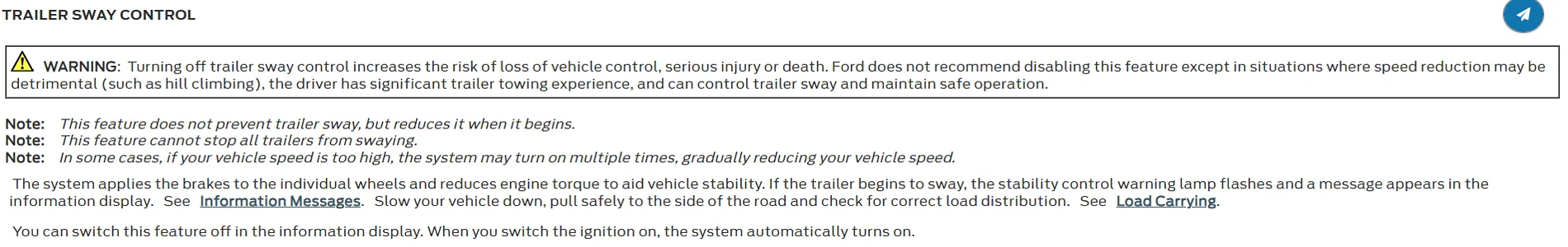

Are you sure you have to have the factory wiring to get the sway control? On my BSOB I do not have the factory towing and have yet to install any aftermarket hitch or wiring, but the sway control setting is available to me on my infotainment screen and I can turn it on and off. I thought the sway control didnt have anything to do with the wiring and it was basically all sensors that are already on the vehicle??? I could be wrong.

^ Mine is the same way. I have a tekonsha harness and am able to turn on or off trailer sway
