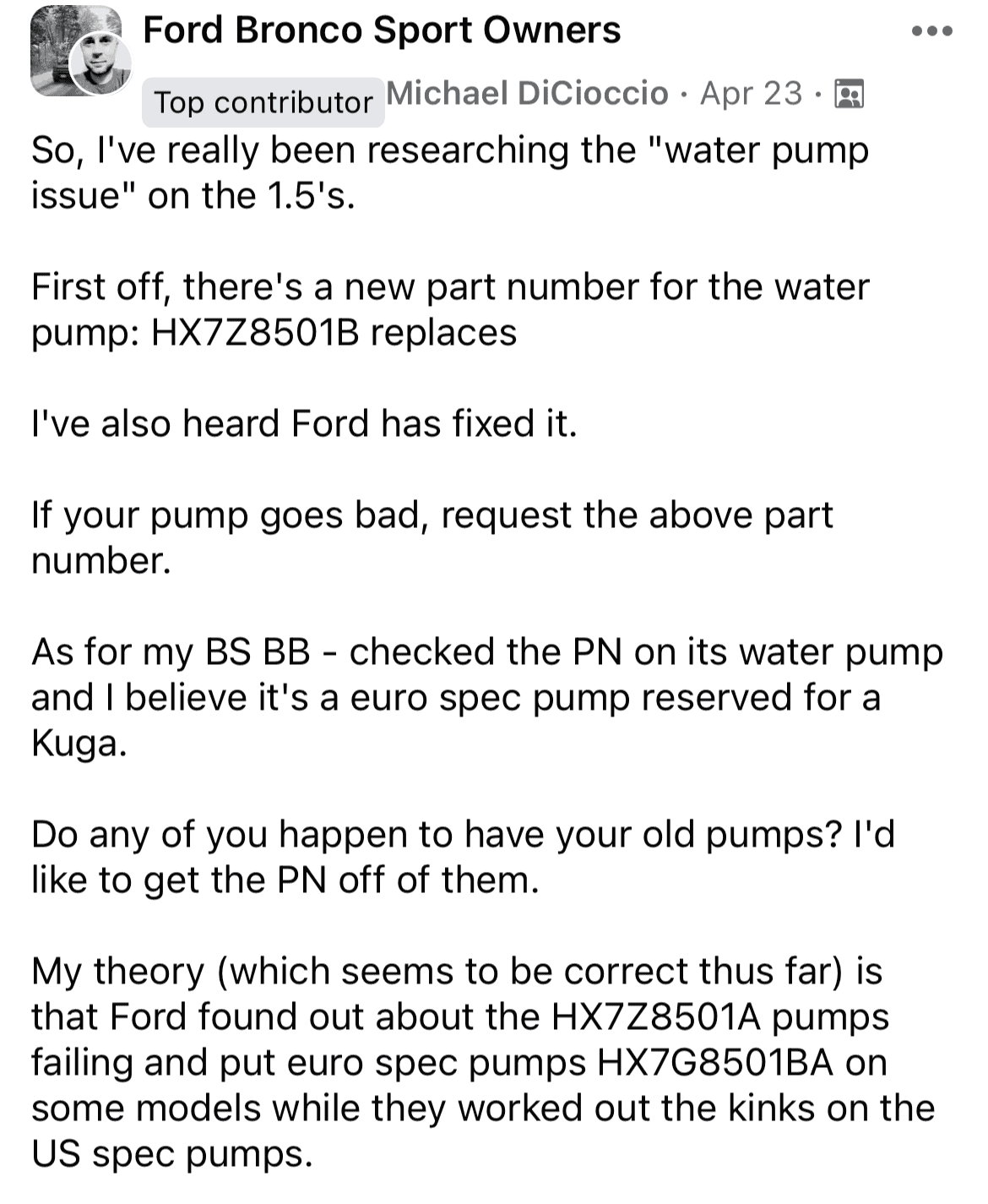

Ford released a redesigned water pump with the B suffix (prior version was the A suffix).. maybe your Ford receipt shows the part number and if you are lucky was the redesigned part. Attached is a pic of more info but I am not the originator of this info.

that’s me. I need to revise the post. The new water pumps leak as well. It is believed that the lack of belt tensioner on the engine causes too much strain on the pump. The updated part isnt different from the previous one, at all. maybe a new supplier, but it’s not revised at all.
How did you confirm that the new "B" pump is no change/different from the "A" pump ? Is the "no tensioner" cause still your theory or did you find out that Ford has agreed with you on this ? My original pump is leaking too at 13,000 miles. Belt is soaked in coolant and making a mess !
