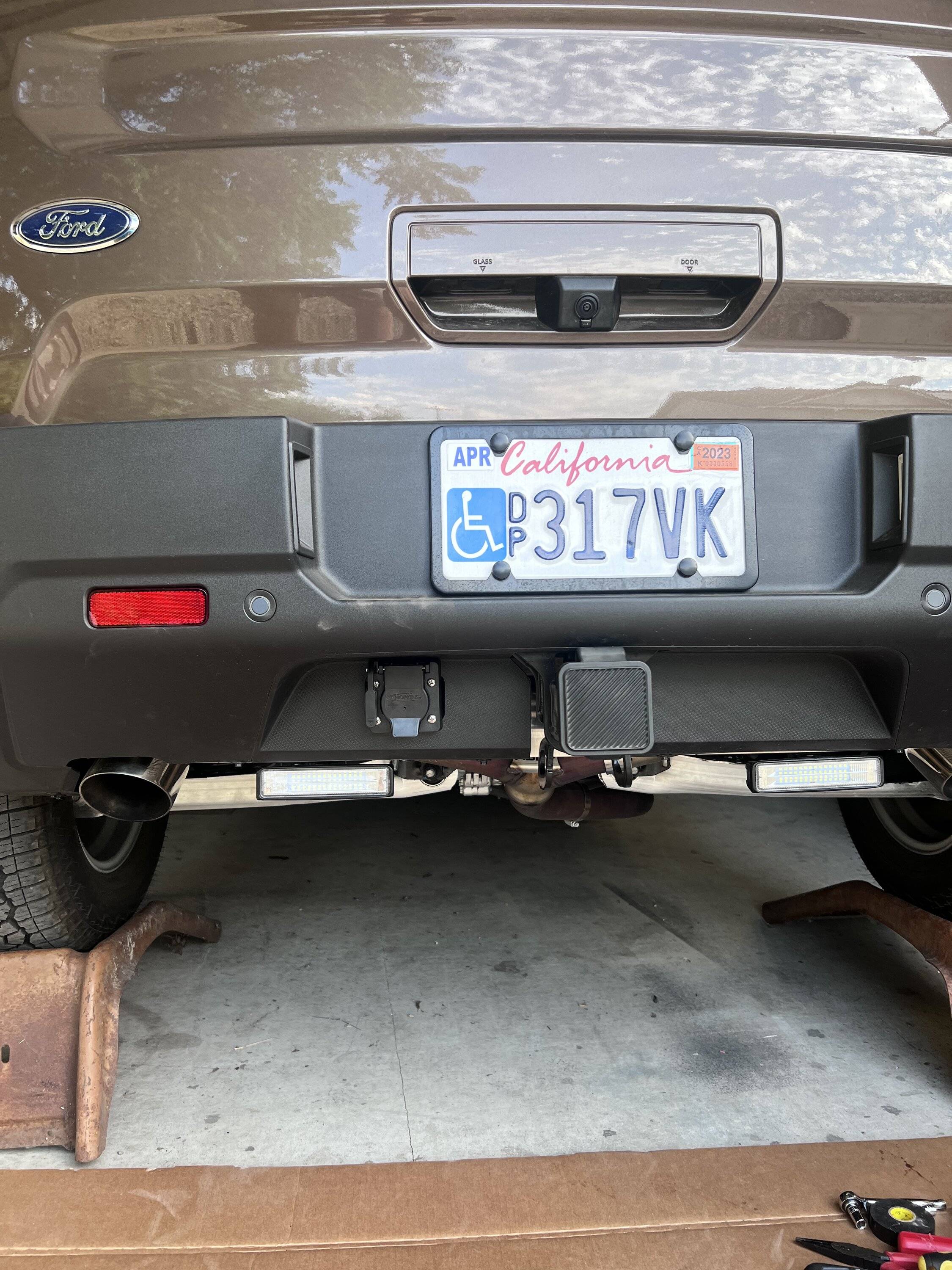

i mounted the 7pin socket here - where the flat 4 socket was mounted on the optional hitch from the factory… looks almost ‘stock’… haha. I was quite a tech install, but I had already installed an aftermarket exhaust system that eliminated the large rear muffler… I then had lots of room to cut the flat4 brkt & cut a hole in the alum backing plate to fit the7 pin socket…
I’m using an ‘Echo’ trailer brake device, so I only had to run the Hot Battery Pos lead up to the engine compartment with a 30 amp relay that gets energized when the engine is running…
ialso ran a switched lead to two backup lights mounted below the hitch on the bronco for improved vision when I need it - also ran same lead to the ‘backup’ pin on the 7 pin socket so that the trailer backup lights come on at the same time… cool, eh’…?
