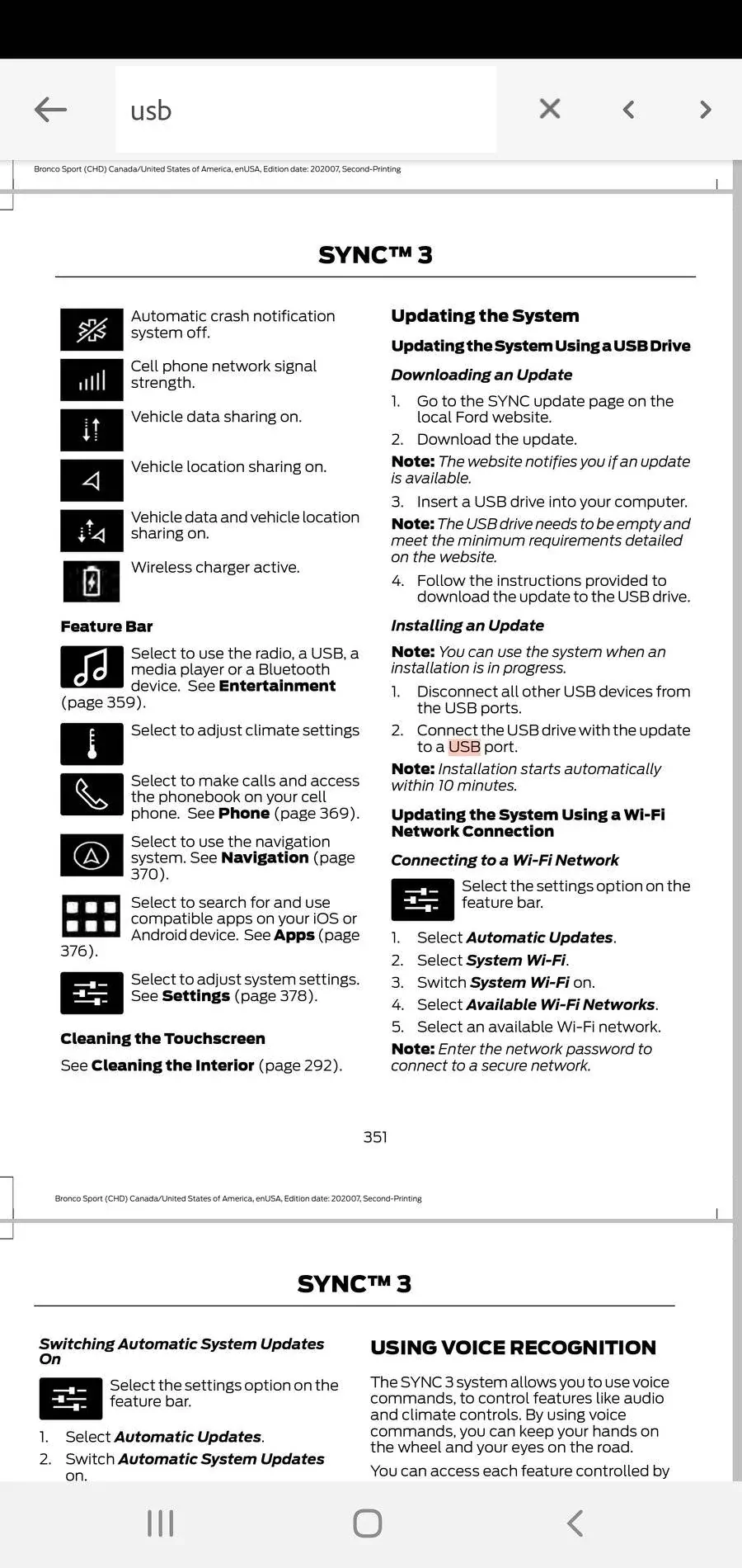

I see in the manual that you can use any USB port for an interface for sync 3. This needs another update as this seems like a typo.

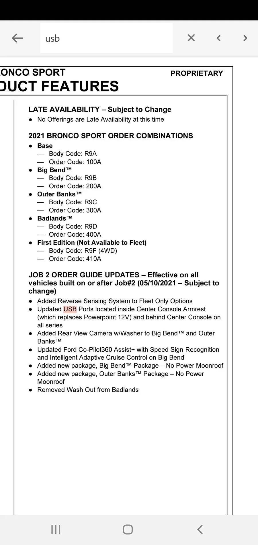

From the April order guide, "console usb replaces 12v"

Hello and thanks all for the replies. My usb ports in the console as of now will not do data. In the above screenshot they may be updating these to do data on vehicles built on or after 5/10/2021. if that is the case this will not help me because my vehicle was built before then. Or will a update fix this and make them be able to connect to sync3?
Am I reading this correctly?
