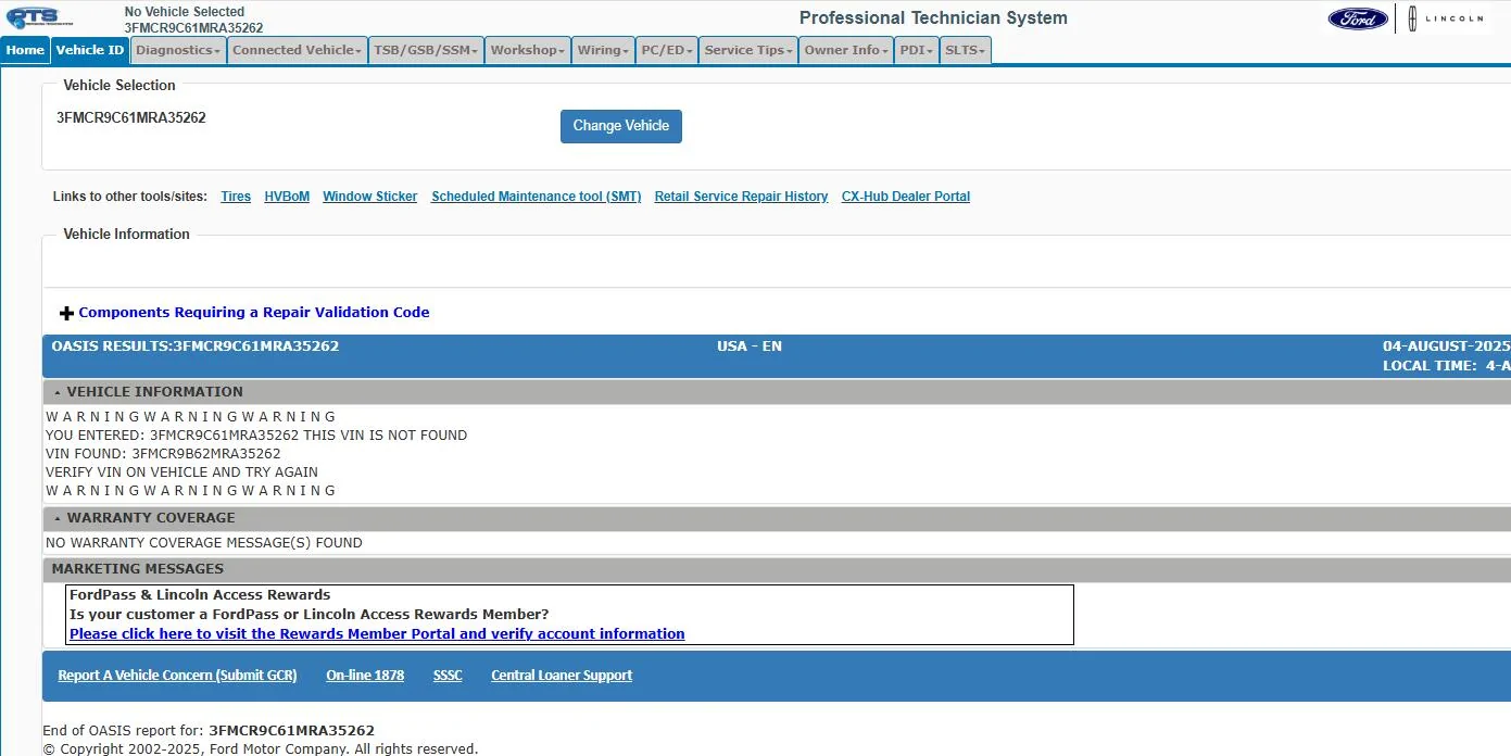

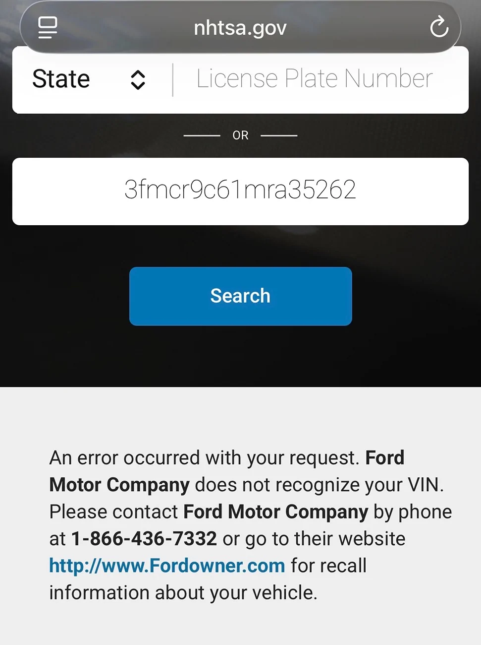

This probably is OPs VIN
3FMCR9C64MRA35262
@rugedraw want to see if you can find anything on this VIN
Same. The VIN suggested by PTS pulls up, but I don't think it's his truck based on warranty history not matching up with his prior issues and the fact that VIN is for a truck not being driven, so it is not reporting data to the cloud since 5/28(see second screenshot).

I'm more curious about the VIN issue that the actual problem at this point. 🤣
I checked the vin number on the car and I apparently made the mistake. The last 2 numbers of my vin is 52 not 62. Sorry as I have had an eye issue lately or a typing issue. lol
