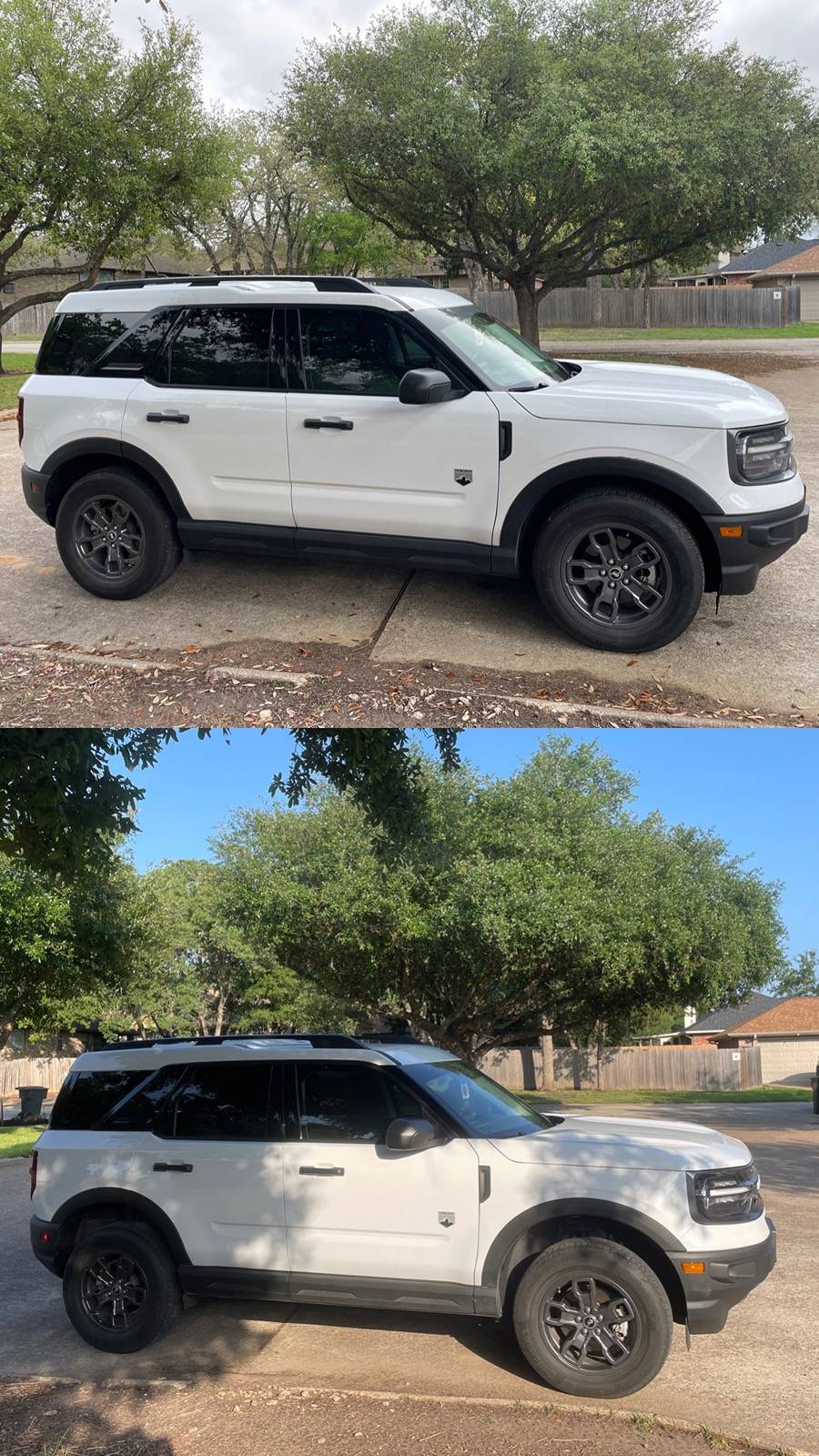

Hey Guys! I just got my BS and it has around 40K miles, with warranty until 100. The dealership said that a lift wouldn't affect it unless it can be proven, so I ordered a lift from FR Lifts and we tried putting it on yesterday (my bf works on cars and did a few lifts for friends and family) so is well experienced. We thought that the clearance from the CV boot is extremely small and actually punctured it in the instillation and had to replace it.
I love the lifted look and bought the vehicle with the intention of lifting it, but if the car isn't made to be lifted and it'll cause many other issues later down the line, I would rather just return it or not do it and ruin my car's longevity. Was wondering if anyone with the 2' has had any issues because the car's struts just dont seem to fit well with the lift and I don't want to force the vehicle into strain and cause damage.
I still am considering putting it on because it looks so great but wanted the real deal insight from yall! Thanks in advance.
