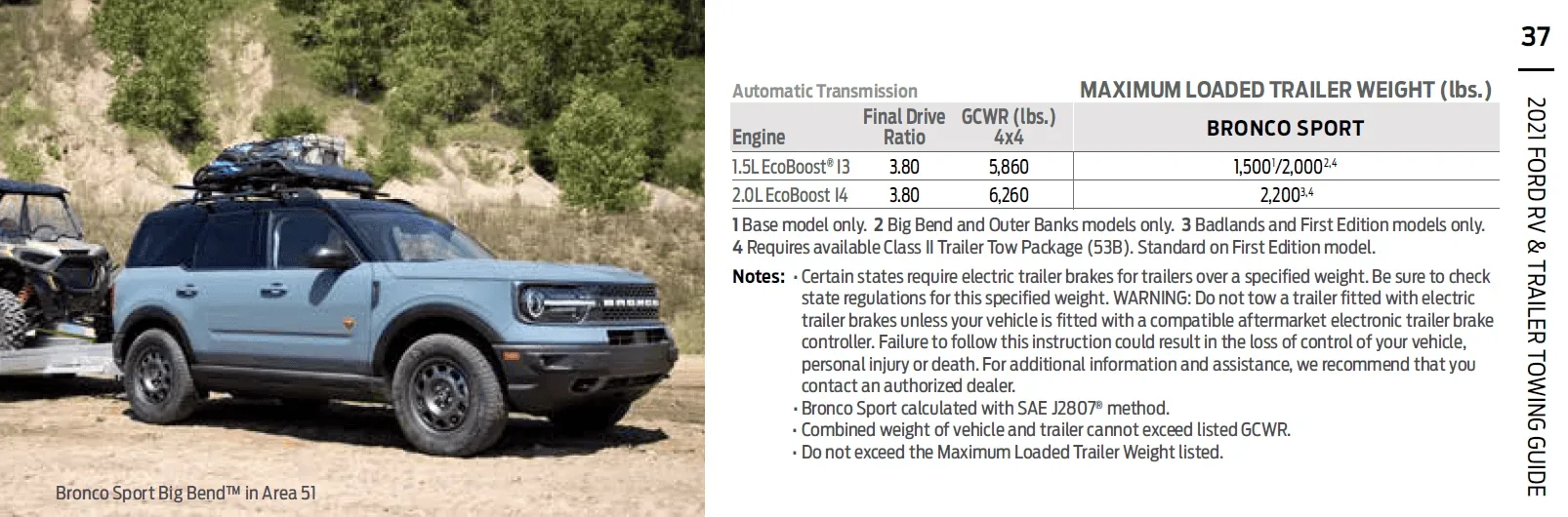

Pay attention to the factory specs. According to the FORD brochure below:
Base model is 1500 lbs.
BB and OB is 2000 lbs.
FE and Badlands is 2200 lbs.
https://www.ford.com/cmslibs/content/dam/brand_ford/en_us/brand/resources/general/pdf/guides/21Towing_Ford_Bronco_Sport_Dec3.pdf

I guess that FORD dealers and BS owners need to read the towing literature and towing specs provided by FORD.
In the link that I provided, it states:
REQUIRED EQUIPMENT Includes items that must be installed.*
Your New Vehicle Limited Warranty (see your dealer for a copy) may be voided if you tow without them. For trailers over 1,500 pounds – Class II Trailer Tow Package (53B) *Check with your dealer for additional requirements, restrictions and limited warranty details.

Look at the footnotes.
