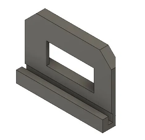

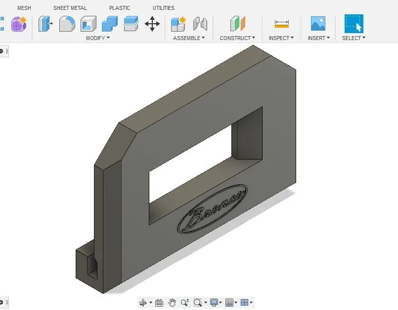

cybertruck it like this?
this one is 110mm long 22.4mm tall at the peak, 13mm deep (depth is going to change if ill change mounting to use the bolt).
~$1 in material
I will be willing to share when I'm happy with the product. Price for the people that helped with ideas will be material + shipping from 16201.

I like the look of that, but, I would remove the Bronco oval. No need for that imho. There is already enough badging on the Sport itself.
Also, if the front could be made just a tad taller to allow for straps to fit through that would be awesome too. Otherwise, it just becomes eye candy for looks.
I think the back opening should be square without the raised roof look. Makes me think that straps would bunch up there.
Maybe a hole at the front and back for carabiners to attach?

I like this design a lot, minus the Bronco lettering and it is pretty much spot on. Upload pictures as soon as you get a test set printed and installed on your Bronco Sport.

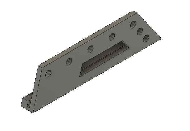

This is utility friendly version
Ford Bronco Sport Can anyone 3D print longhook

Annealing will certainly help to prevent delamination. Hurts for mass production though, since I'm guessing you'll be getting requests once you get it spot on. I like the new design.

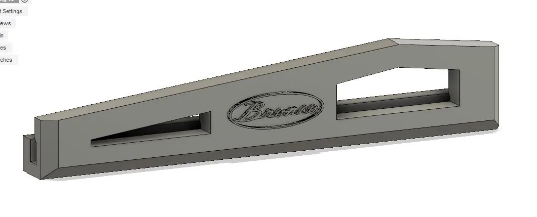

Just like buttholes and opinions, everyone has one. Personally I like the Bronco lettering and that example of your trail sight. Strictly for looks. How would it hold up to an automatic carwash? Would also be cool with turn signals ala Caddy’s of yore. Google if you are young ?

Been busy, printing utility version now.
I personally do not like the house roof ending on the one with the bronco sign, but did not really know how to end it. Tried just a rectangle and it did not look correct either.
I don't know about carwash chemicals but the material is stronger than our fenders... kinda sad.
