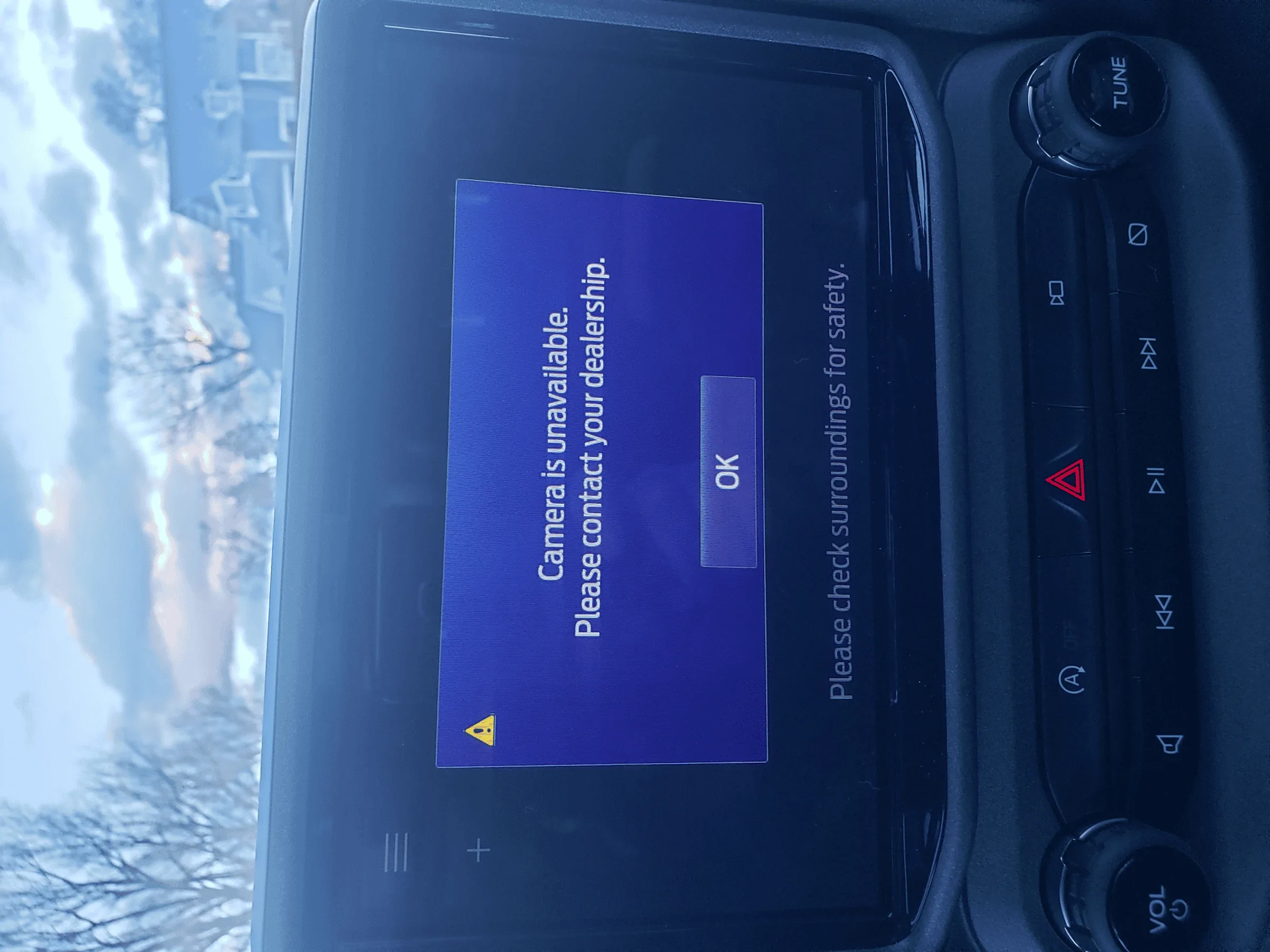

I've got my 2022 BS Badlands last week. Within three days of owing this car the backup camera didn't work showing a blue screen and saying 'check with dealership'. Then the next day the front camera also didn't work with the same blue screen. I made an appointment with the dealership later this week. Hopefully they can be fixed easily. But disappointed it has the problem like this for the brand new car.

It does it all the time. It's not working at all. I have to be careful whenever I do back up. I did some research and found there was a recall on backup camera issue for Ford trucks recently too. Below is the error message I get when I back up.

Oh wild! No mine never gave that error message, it was literally just a blank blue screen. It showed the backup camera too in the 360 overhead view (which the explorer does have) as just being a blue triangle. Hopefully itā€™s a quick easy warranty repair For you!

So I took it to a dealership. Even before they looked at it, he said they might need to place an order for parts. And then they disassembled parts and dash pieces and took a look at it for several hours. They couldn't find what the problem is and couldn't fix it. They asked me to leave the car in the dealership for a few days for more disassembling parts to look at it deeply and to know what they need to order. I was not comfortable about their capability. So I brought my car back and made an appointment with another dealership next week before I leave my car in the dealership for a longer repair. We'll see how it goes.

Also I think this is some sort of connection issue. It worked for the first couple of days. On the third day, it was rainy and snowy (based on my research, water leak can cause camera malfunction of on/off working. But mine is not working at all) I opened the cargo door and closed. It was not hard, but normal close. Then it stop working. Then the next day the front camera stop working too. So I feel this is connection issue.

Sounds like maybe there was a wire loose like you said. Seems strange the dealer wouldn't be able to figure that out though.
