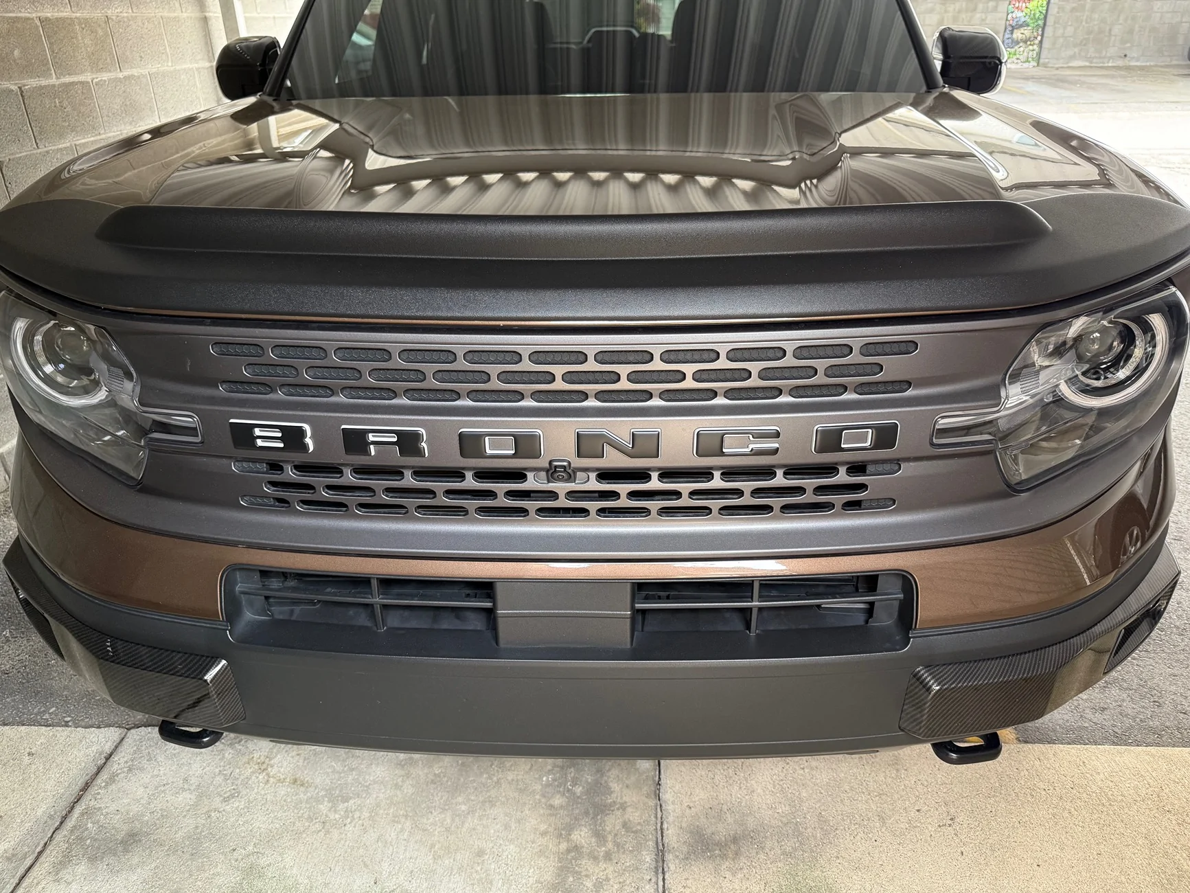

I have the Ford Aeroskin II protector and inserted 1/2" fuel line inside the rear seal to lessen hood vibration. It has helped noticeably and at 80 mph it is now minimal.

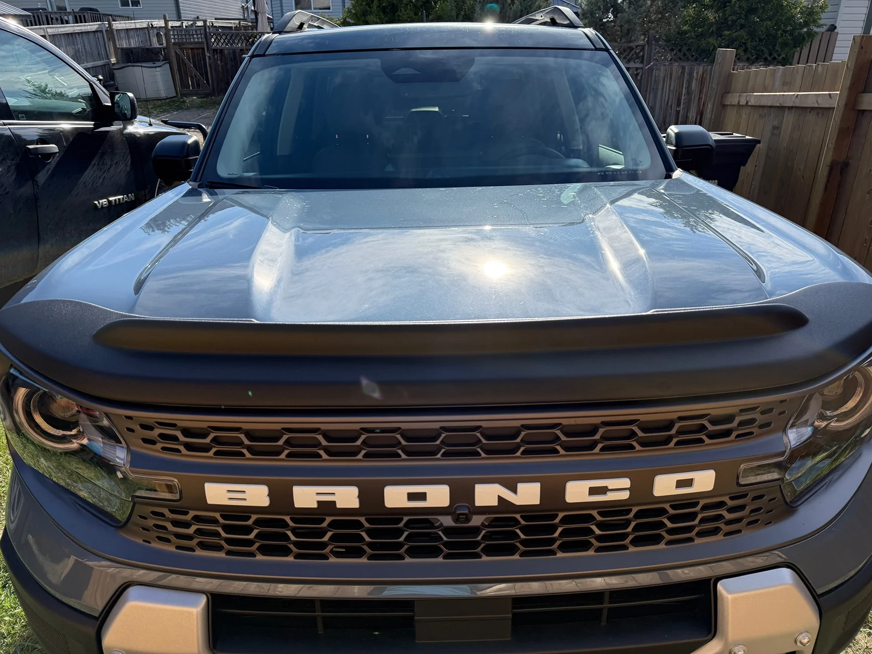

I put the aeroskin II on my ‘25 Badlands and it’s really reduced the amount of bugs on the windshield. I haven’t had any issues with rock chips yet. The ‘25 BLs have insulated hoods so the vibrations are pretty minimal. I did notice it after putting it on but it’s because I was looking for it. I’m not sure if it was already doing it before installation. But I also just installed Redline hood lifts as well which has also helped. The vibration is most noticeable in the centre of the hood closest to the windshield. It’s very minimal though and totally worth the extra protection for your hood and windshield imo.

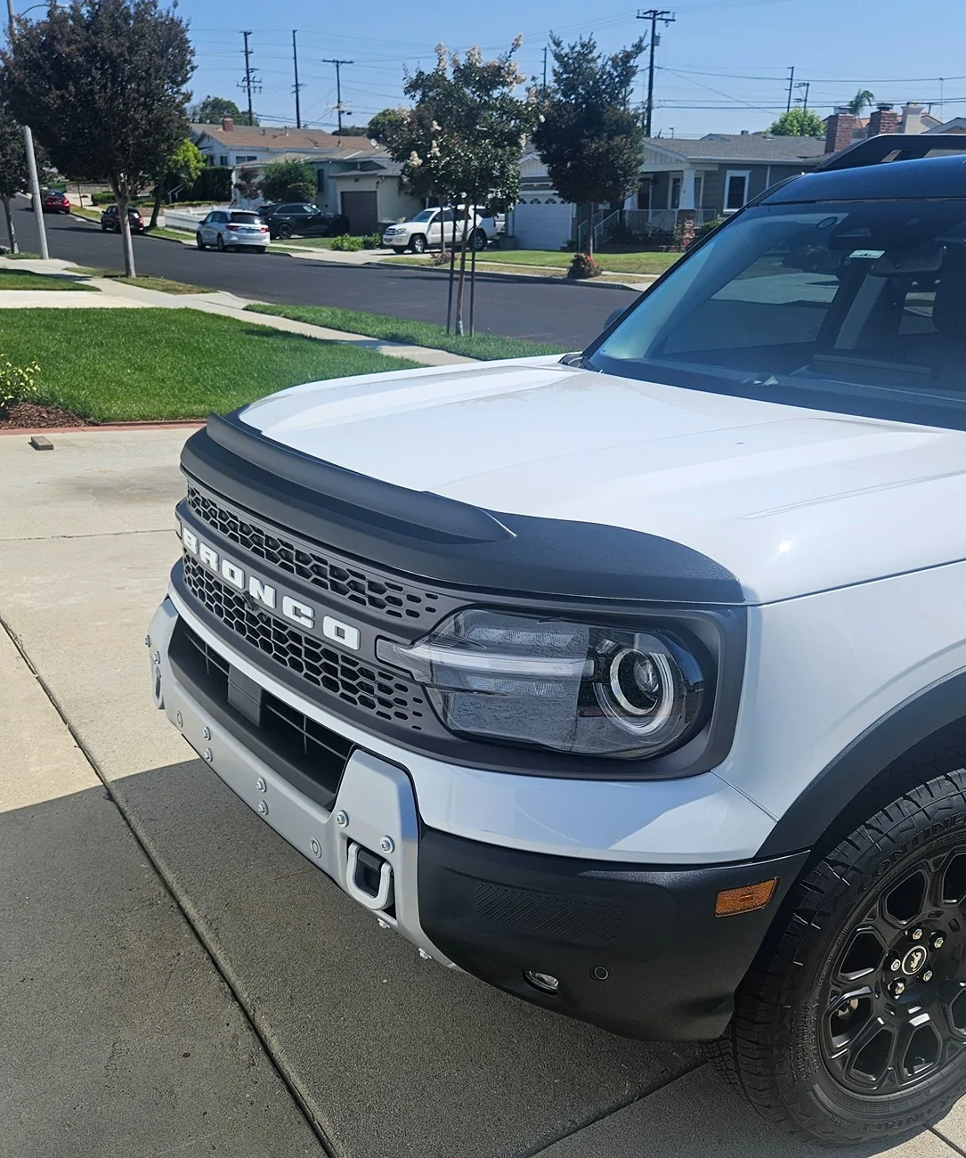

Got it done today! Love it! Aeroskin II.
Ford Bronco Sport Bug/rock deflector? 20250807_102425
Ford Bronco Sport Bug/rock deflector? 20250807_064838
This looks great. After driving through Baja, and thousands of bugs, I'm pretty sure this is a must have.
I'm hoping it stops some of the small rocks that damage the hood/windshield/roof line right above the glass.
Seems like the glass is pretty vulnerable to chipping and cracking (I've fixed mine twice in a year)
