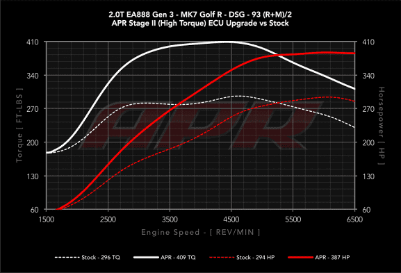

For daily driving the benefit is more power under the curve. For the most part, top speed or peak horsepower is the wrong way to think about tuning a daily driver, even though they're the numbers everyone talks about. I haven't looked at the graphs for the bronco sport since I won't be tuning it (unless I sell my vw and go to one car) but you gain power across the entire powerband which you don't need a track to take advantage of.
Here's a vw dyno since I'm a lot more familiar with the vw aftermarket. I don't have APR but they have a nice graphic (my car is a similar setup but makes a little more power). The extra power under the curve makes the car significantly more lively in day to day driving, its immediate power all the time without needing to push the engine to the max. Making 270 hp at 3500 rpms instead of making it at 4700 rpms (or being able to produce the same power as stock but at 2/3 the throttle input) is more significant around town than making 387 at 6300 unless you redline every gear. I'd imagine this would all be applicable to a tuned sport albeit to a lesser degree.

For daily driving the benefit is more power under the curve. For the most part, top speed or peak horsepower is the wrong way to think about tuning a daily driver, even though they're the numbers everyone talks about. I haven't looked at the graphs for the bronco sport since I won't be tuning it (unless I sell my vw and go to one car) but you gain power across the entire powerband which you don't need a track to take advantage of....
