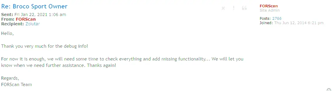

That is the correct account - FORScan
Ford Bronco Sport Bronco ForScan Thread 1626190512968
Odd you cant PM it, might be a minimum posting requirement or something
