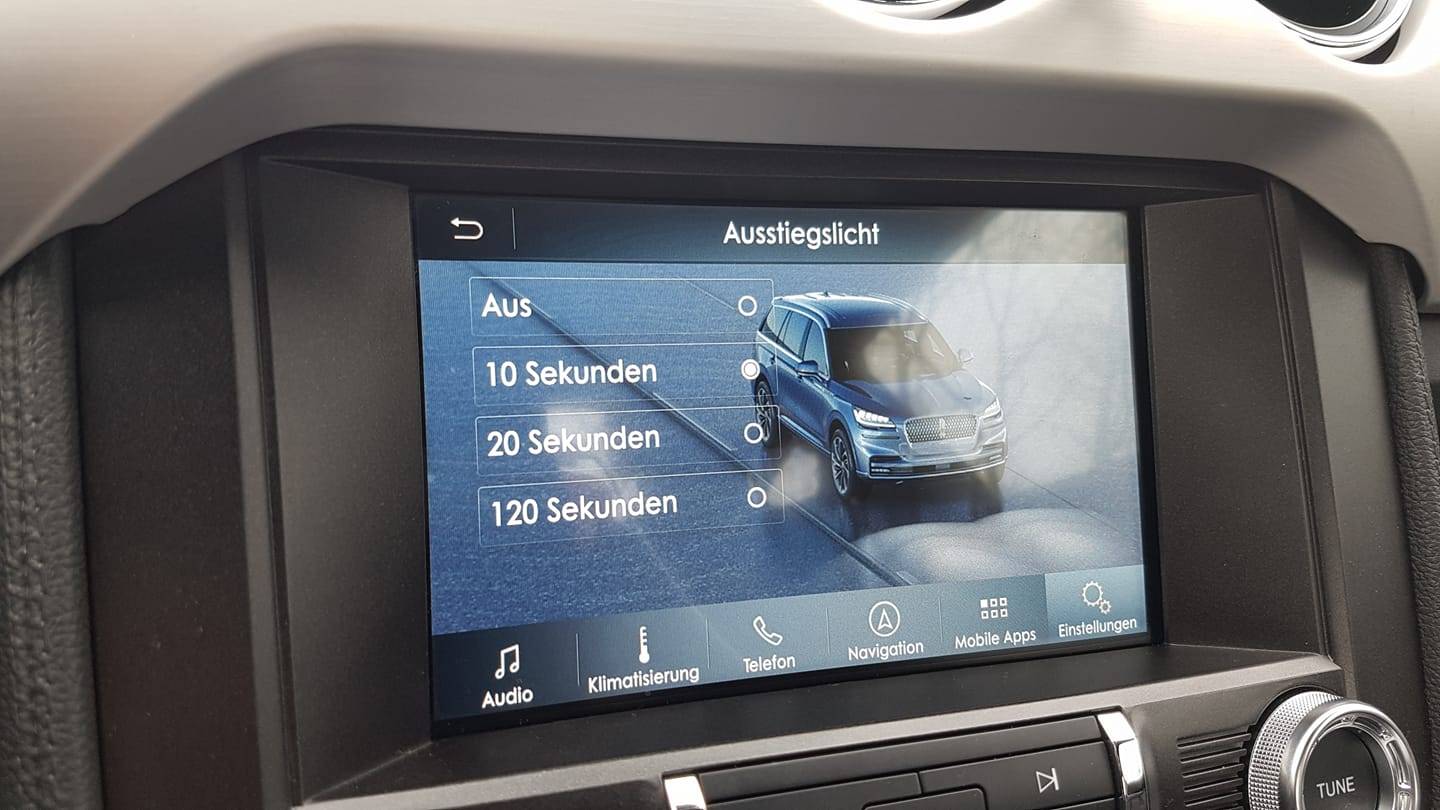

Congratulations to the German who found the Lincoln Aviator images in his Mustang's Sync 3 system. It further demonstrates my point that Ford probably has or will stuff pictures of the Bronco into the Sync system of new Ford models. I have no 2020 Ford's at my disposal to experiment with, but maybe some of you do. We know the Bronco theme is already in current Ford's featuring Sync 3.4
