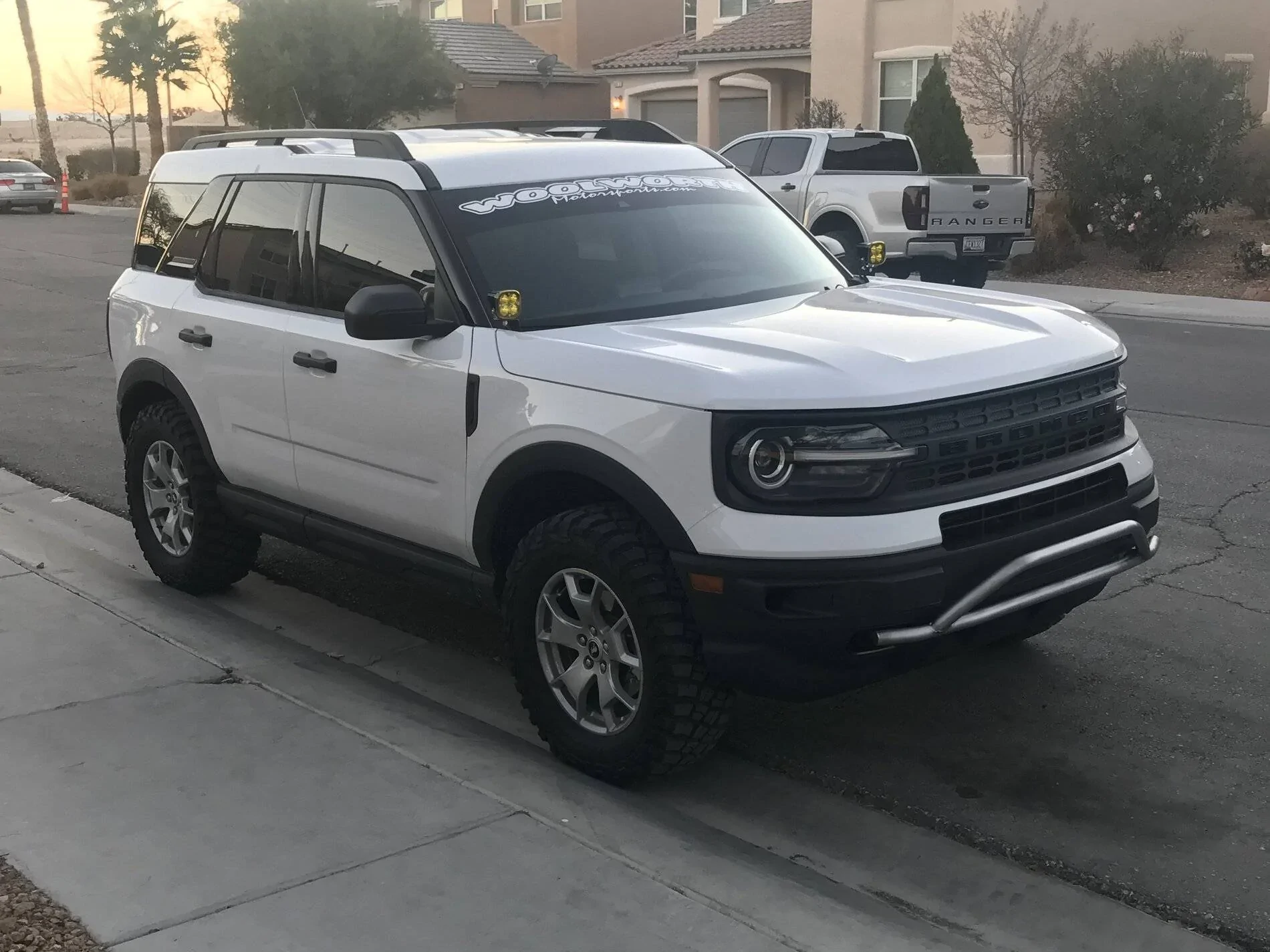

How did the handling change? Say in sweeping corners. Did the anti roll/sway controll ability of the suspension degrade noticably ?

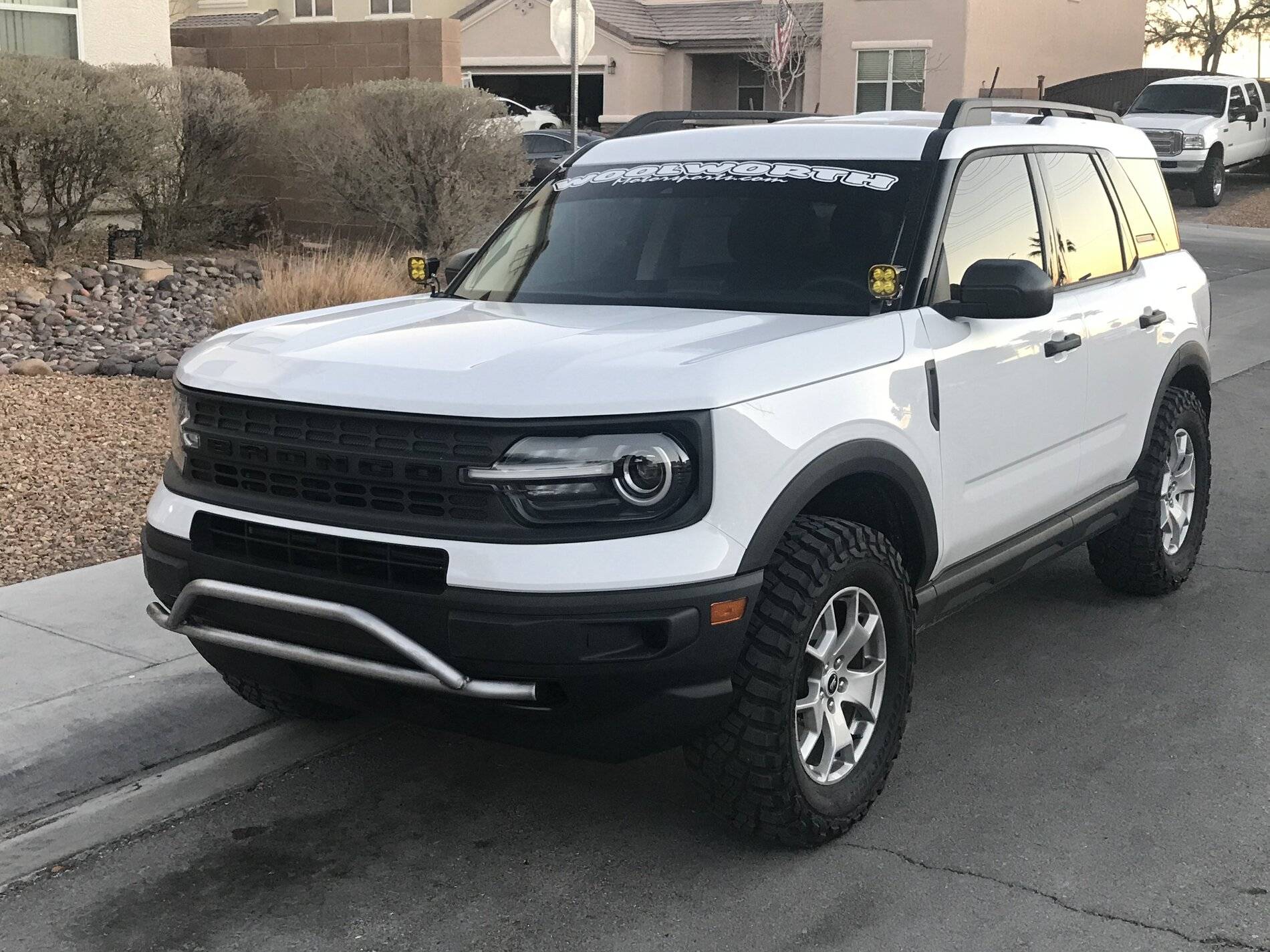

Bronco performs better then stock. The wider tires and level stance makes it really feel planted around high speed corners. I will have some video soon to show how well it works.

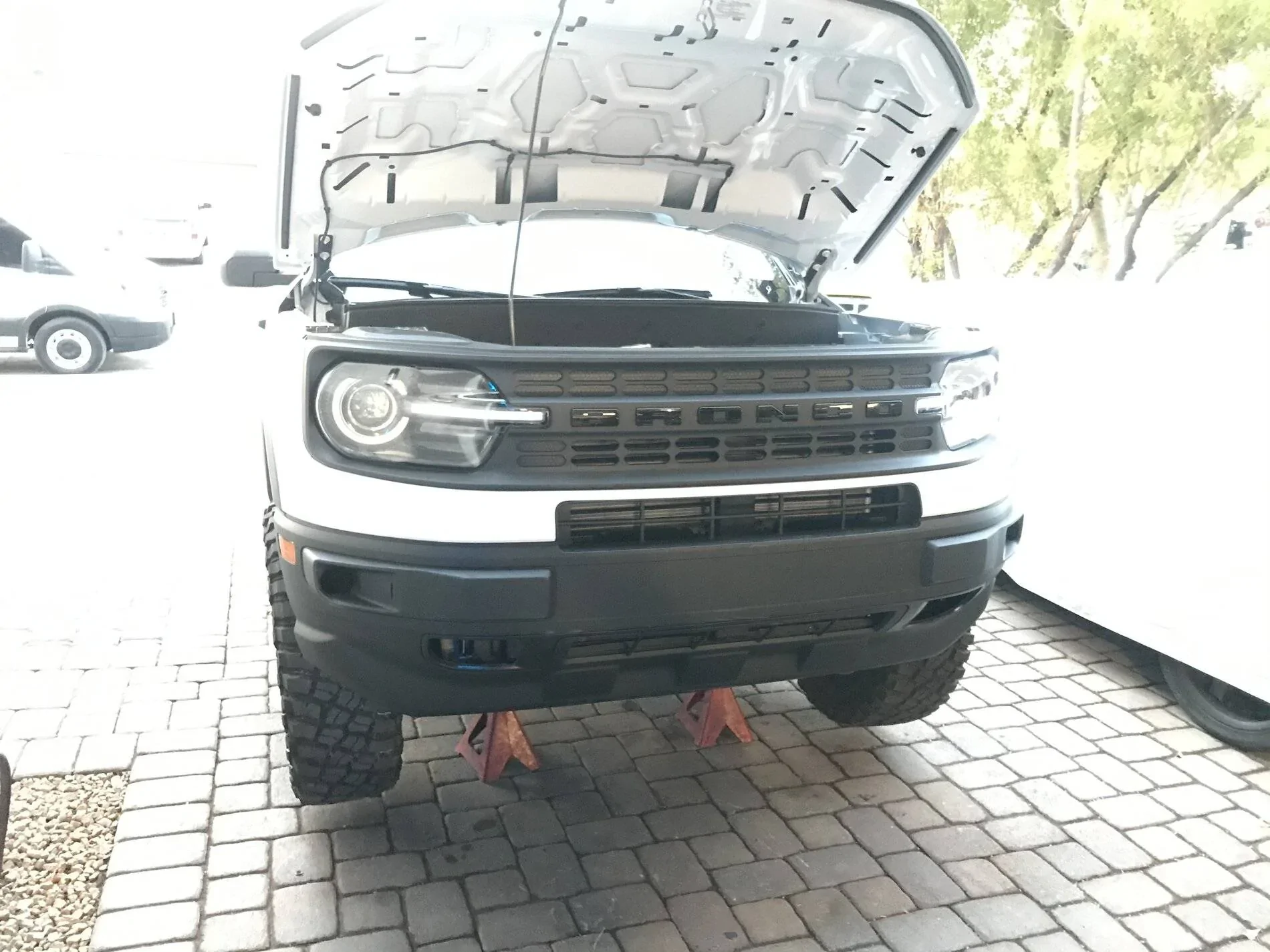

That's exactly how it should look. Any idea if a badlands model would bring up any issues with designing a lift and you think a 2.5” is doable?
Unfortunately 2” is max on these bronco sport models unless you do some major transformation with the sub frame drop. Which right now I’m sure a lot of people may not want to do with a new car. But it is possible to do a 3.5”

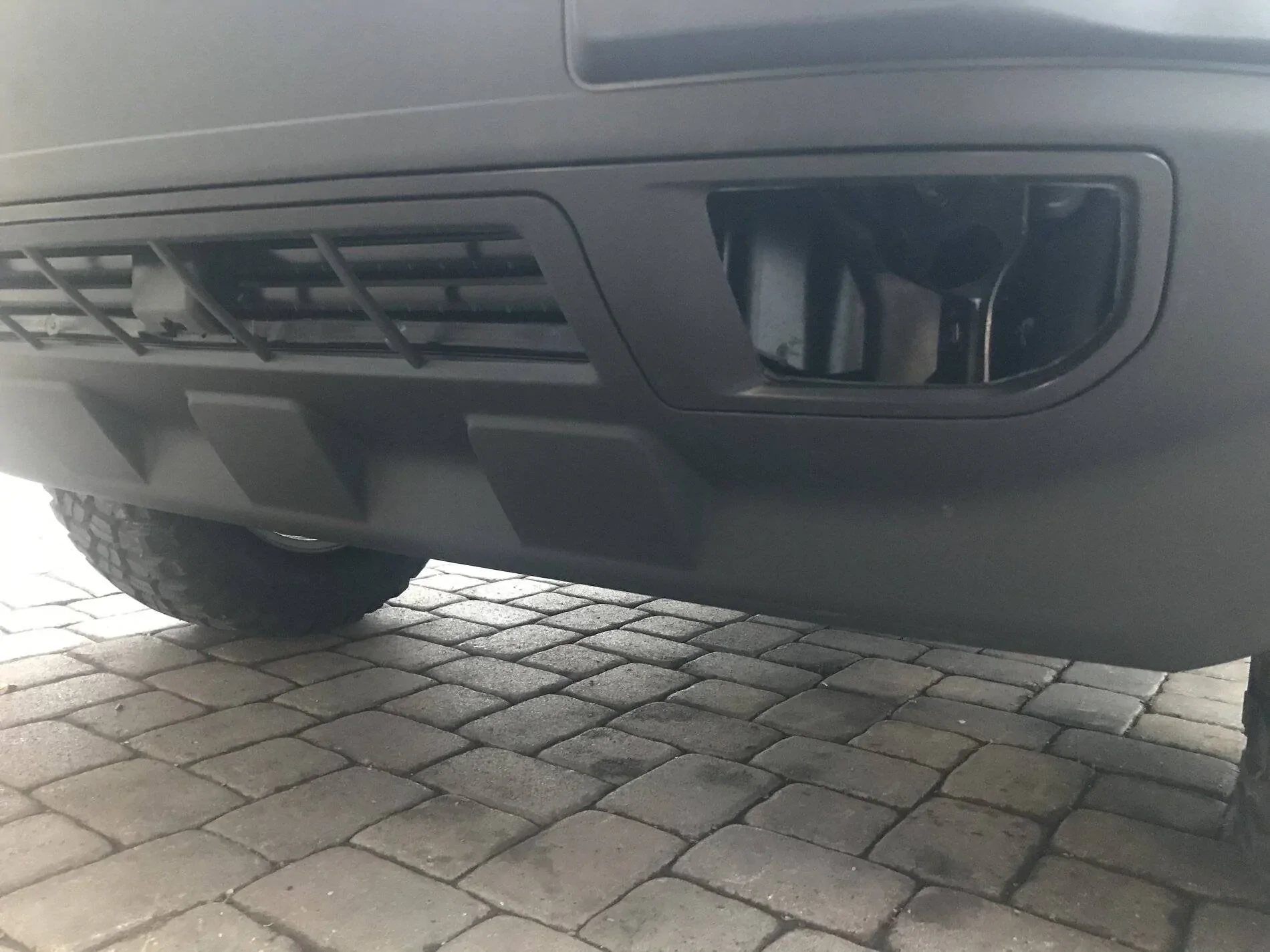

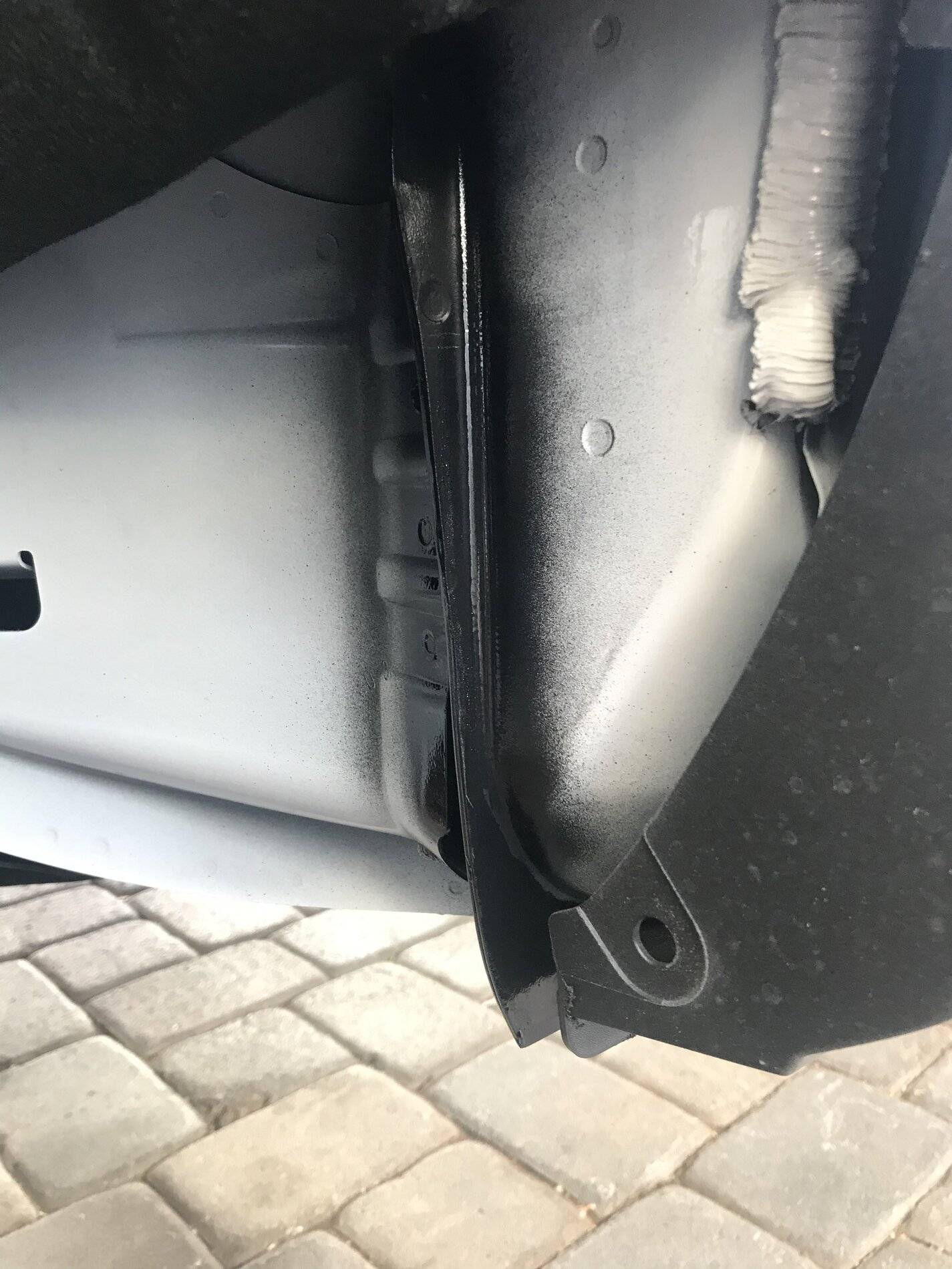

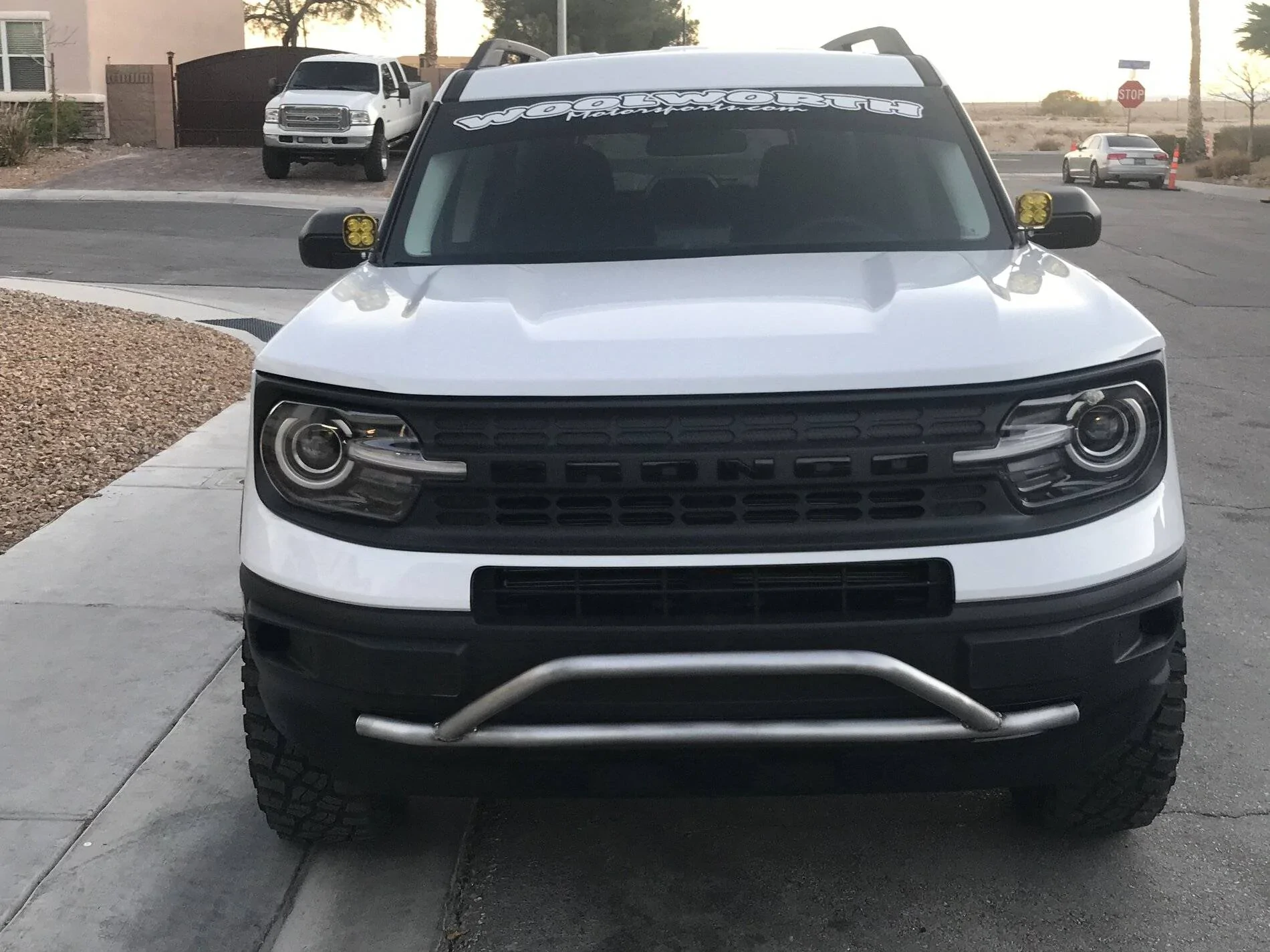

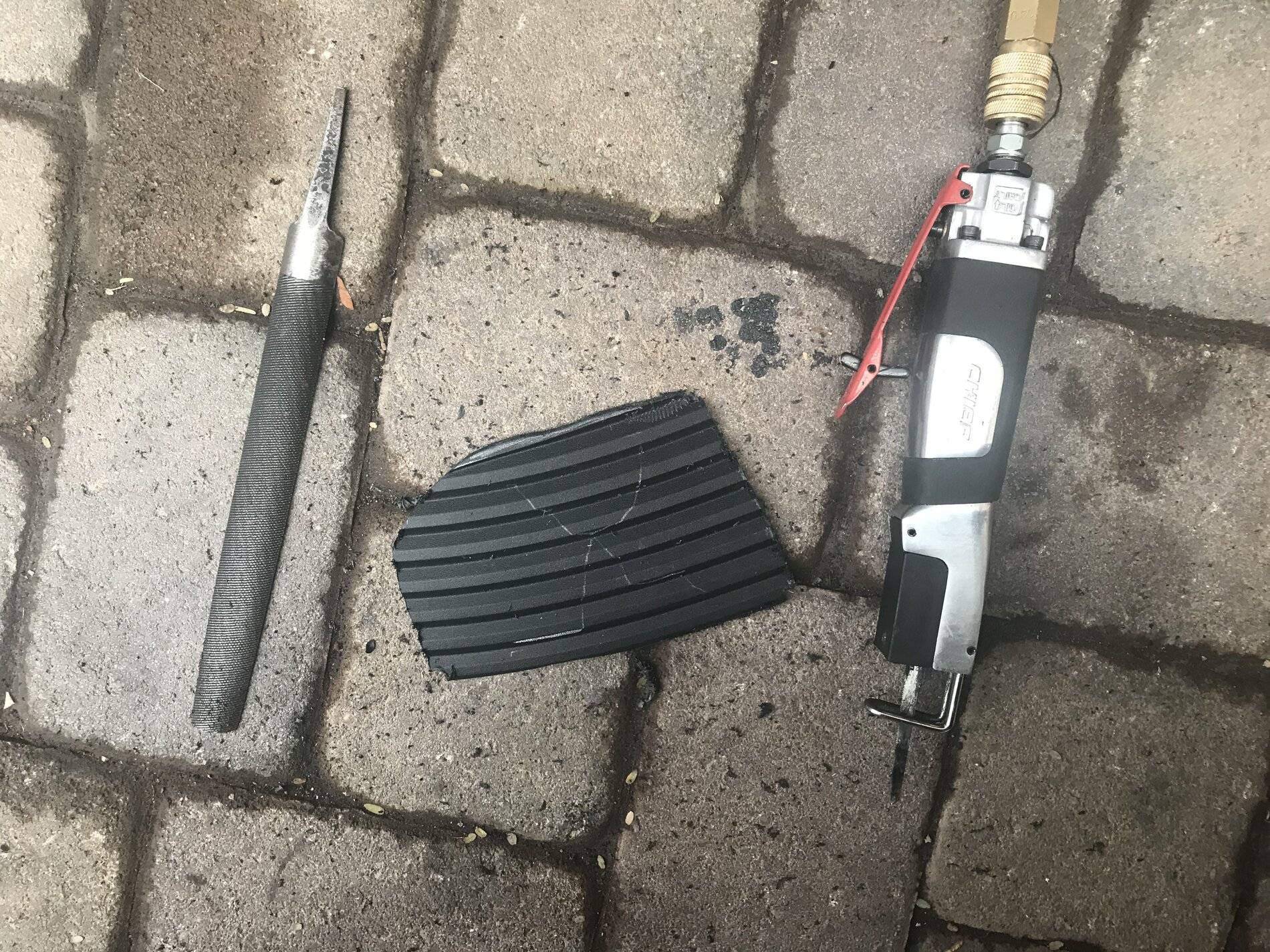

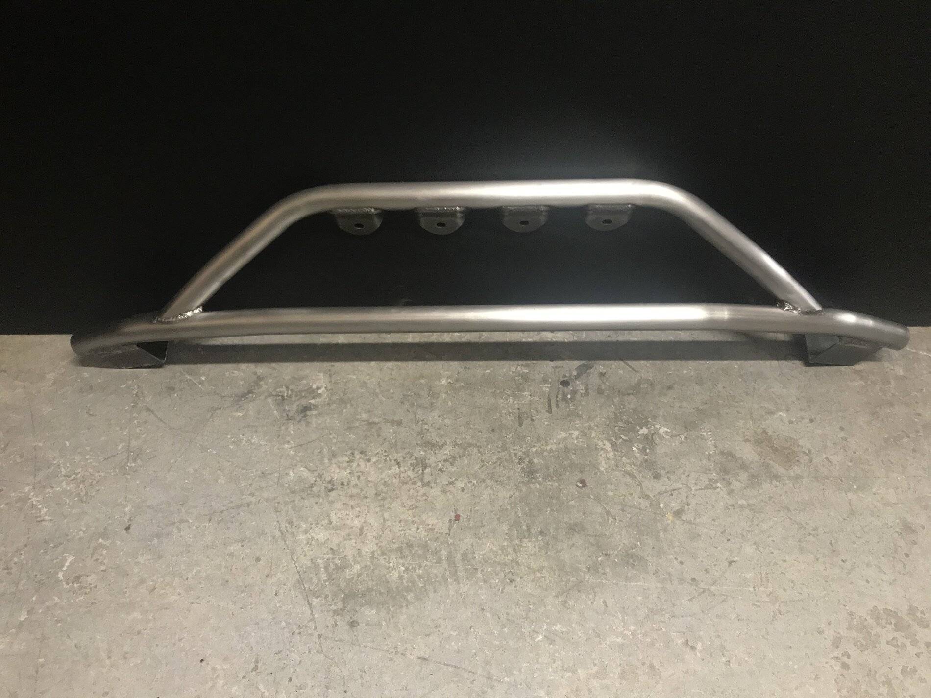

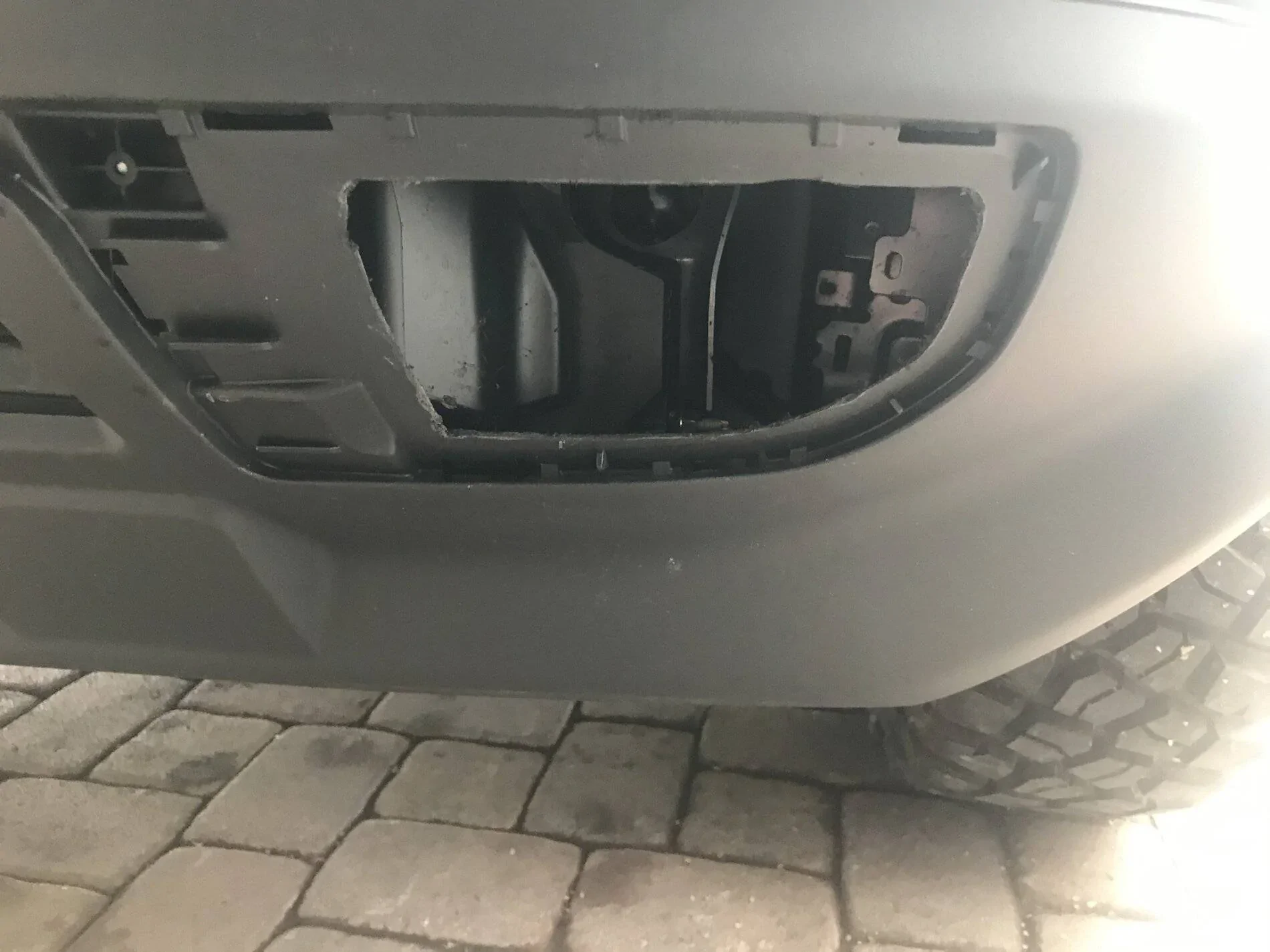

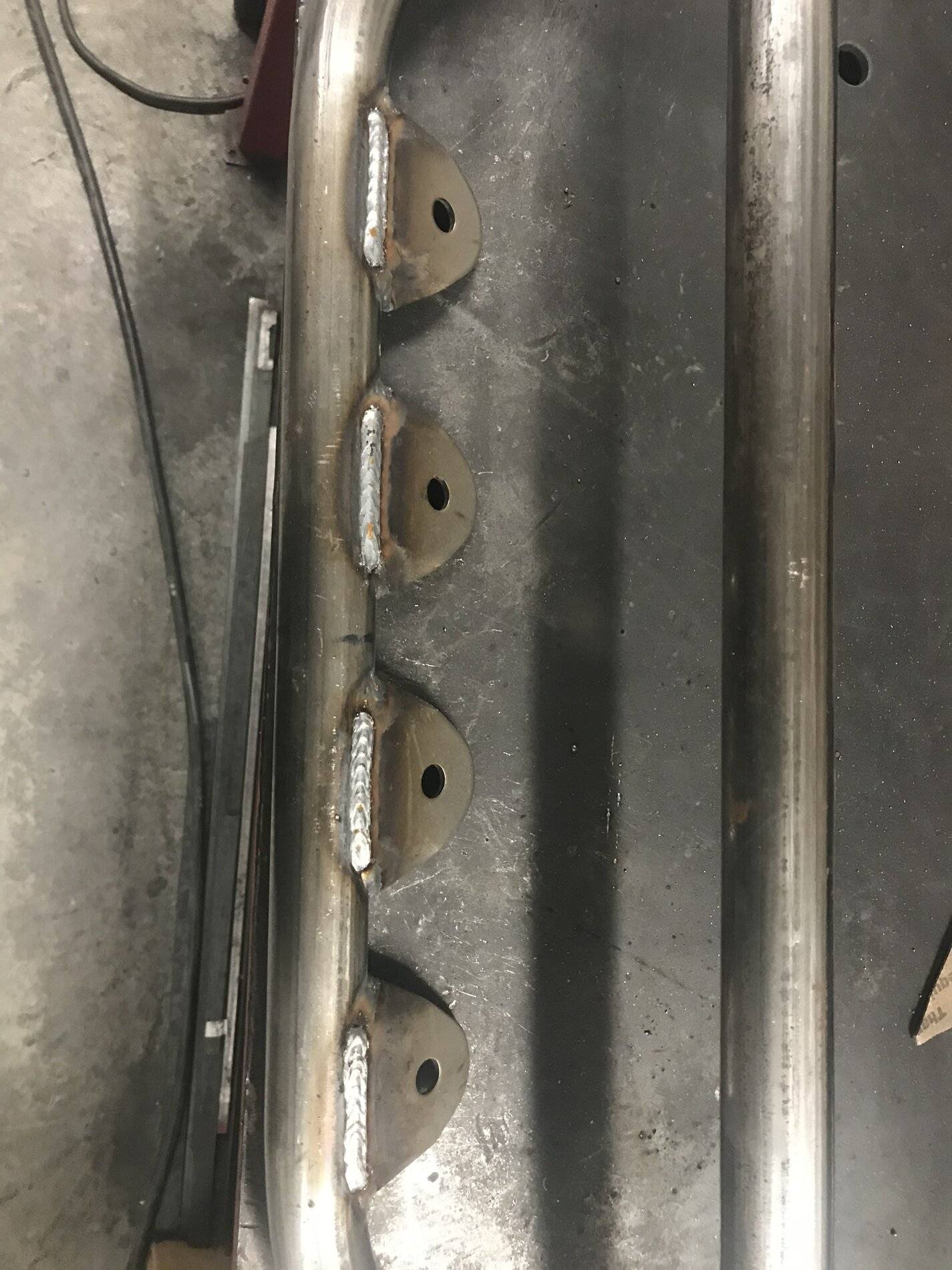

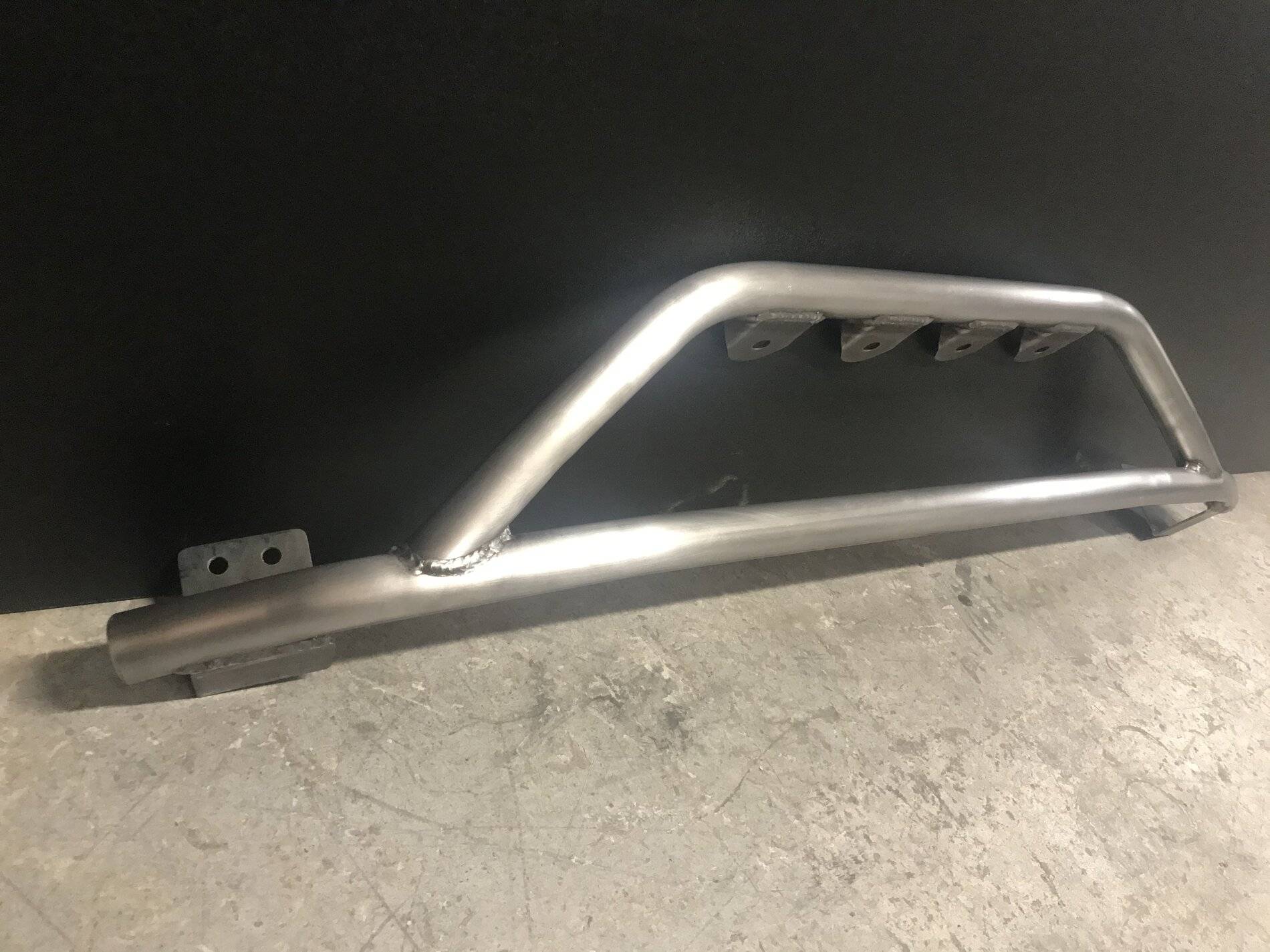

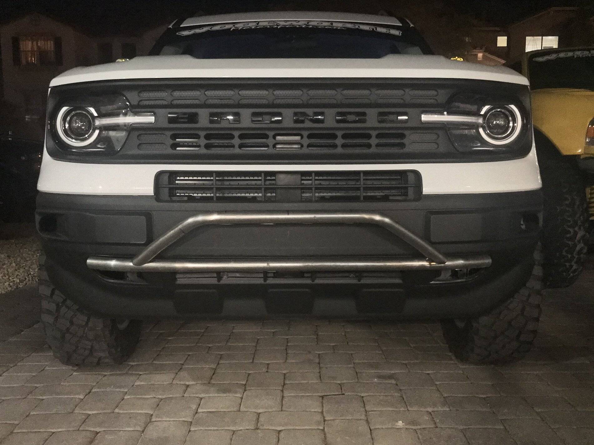

Particularly curious how the mounting went on a non Badlands trim without the tow hooks.
I cut out the section of plastic that would be missing if I had the tow hooks. There is two bolt holes where tow hooks would mount. I made a couple brackets and fabbed up the bull bar/light bar. I’m going to put 4” rigid lights on it and maybe a skid plate.
