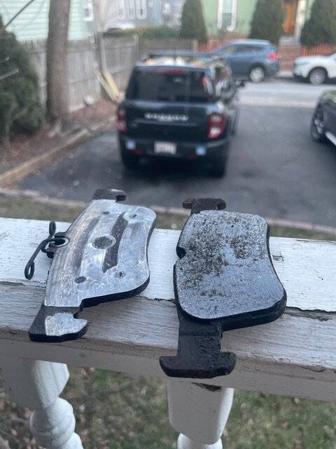

That is a common problem when the calipers run out of lubrication. It isn't normal for that to happen at 10,000 miles.
I was thinking about this yesterday and then just reread the OP. I would say that since the inboard pad is more worn than the outboard pad, then the caliper piston is not releasing as it should. Basically the pad being pushed by the piston has more wear so it is pushed against the disc. It would seem that a caliper rebuild might also be in order. I would say that is an issue Ford should cover under warranty but since you have already done the job, they probably won’t.
This is the primary reason I asked for a source regarding rear brake use using ACC. I looked far and wide on Google and found nothing except for references to posts on other forums from users making the same claim--I could find nothing from an authoritative source.
Even if it's true that ACC biases rear brakes, ACC use cannot explain the uneven wear. I'm confident this issue has nothing to do with ACC use.
Thanks for the opinion. That was also one of my thoughts but wanted to see if anyone else came to that conclusion. I am hoping that's not the case but I hope for can take a look at it retroactively .

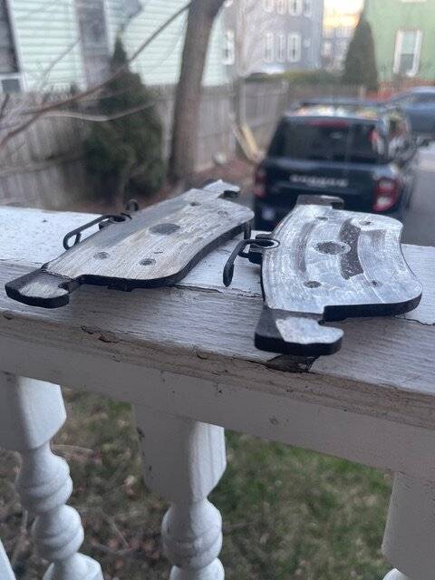

After putting on just UNDER 10k miles on my 2022 badlands, the rear brake pads were completely worn down (see photos). The front pads still have at least half to â…” of the pad remaining. Has anyone else had gross premature wear issues on the rear brakes on the Badlands? When I checked online, the rear brake recall did not include the Badlands trim. Instead of paying $500 per axle at the dealership I decided to change the brake pads and rotors myself. I immediately noticed that caliper pins were dry and not well lubricated when I removed them. Also, the inboard brake pads were more worn down than the outer pads.
I want to get to the bottom of this before I ridiculously go through another set of pads in only 10k miles. My working theories are that the caliper pins were not properly lubricated, preventing it from freely floating and causing the pads to be held on to the rotors too tightly. Also, possibly the parking brake system is not releasing properly, or the auto stop braking system has not been fully disengaging while driving.
Has anyone else had issues with the rear brakes on the Badlands package?

Over the almost 10k miles did you happen to do a tire rotation or when checking your oil did you also look at the coolant and brake fluid levels? You possibly could have noticed that there was a potential problem early on instead finding out to late.

I did not see a drop in any fluid levels when doing basic maintenance. I have not had to add any fluids yet. I had a Ford dealership do the first oil change and tire rotation. Nothing was mentioned then. I am still trying to get Ford to take a look at the breaks. Thanks for the input!
