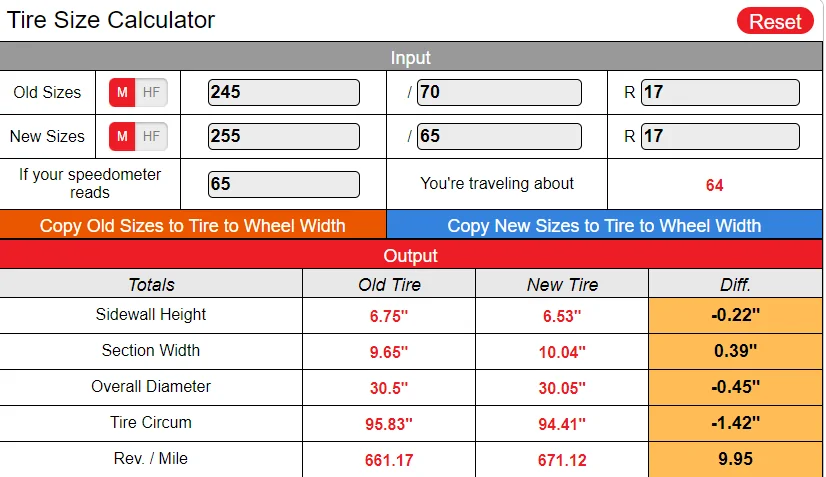

I'm curious to know, do you believe that a 255 65r17 would also have issues?

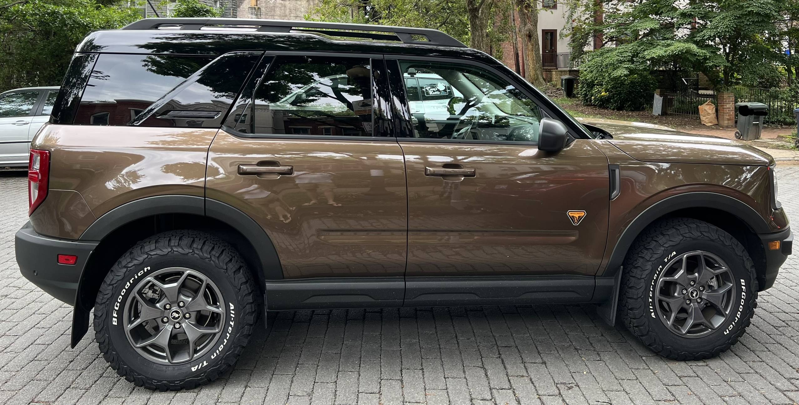

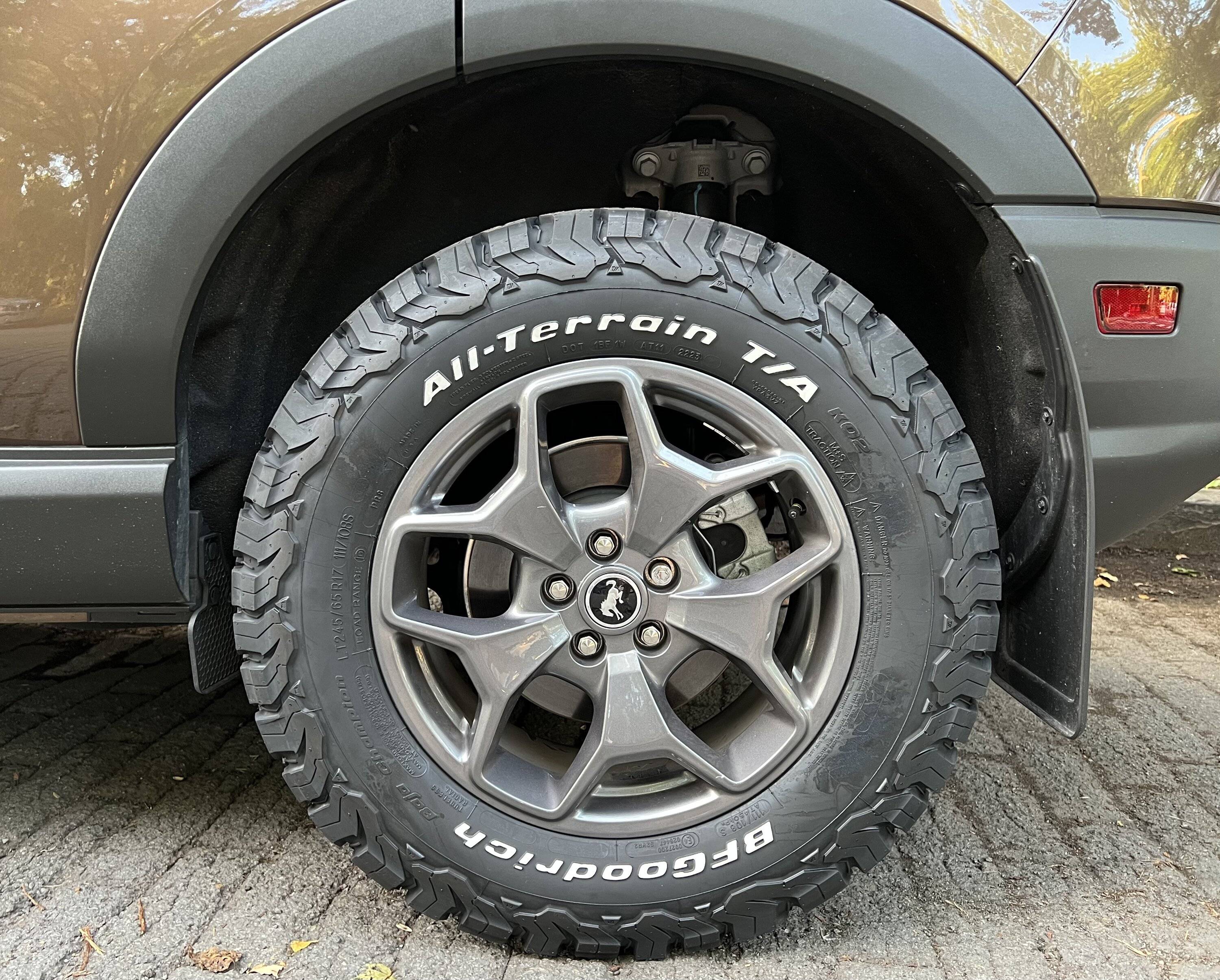

Went with the K02s in 245/65/17. They look great, and no issues at all on a 22 Badlands in full lock turns. Thanks much to forum for info and advice.
Raised about an inch over stock 225 Pirellis. Makes drive a little more stiff and truck-like, but not in a bad way. Accel feels a step slower and braking a step better. Noise is barely noticeable. Mileage only slightly less. Haven’t taken off road much yet, but clearly more grippy. Wife noticed no differences whatsoever, so maybe I just want those things to be true.
Shout out to Discount Tires in Fredericksburg for quick and excellent service!
