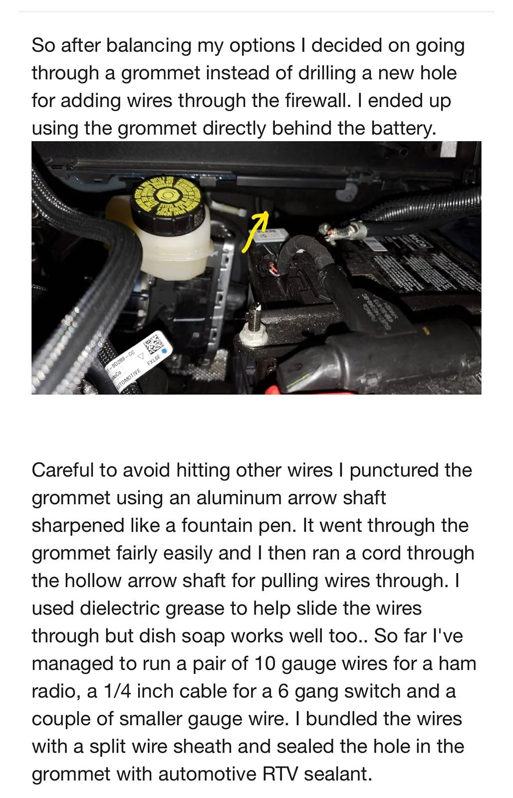

I am put Rough Country 20" Spectrum on my Big Bend. Where is best place to convert firewall to put light on/off switch in cab

The grommet will push out easily. Use some lube when giving it a poke.

I know this is almost a year old. But hoped I could ask a question. Inside the vehicle, where is this Grommet location? Is it accessible without dismantling my dash?

Easy to get to. Up in behind the pedals.
