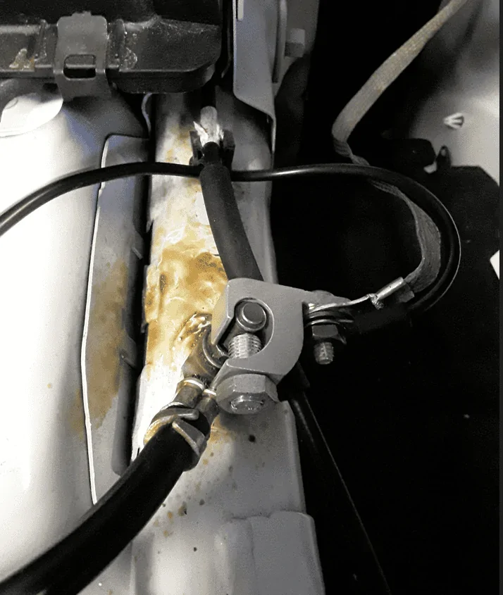

grounding lug attached to frame grounding post
presently occupied by antenna strap and battery tender
Thanks Major, I saw your thread a few days ago. The only difference with my 25, the ground lug is actually a bolt shape and not round like yours. I was trying to find a clamp that would work and make a good connection.

Thanks, on your install you connected to the (-) battery post which is what the video on the BMS suggested not to do. Also the (+) you connected to, that (2) post on my pic, do you know where that leads to?
Do still have yours connected that way, and ever have any electrical or issues infotainment glitches?
lots of smart people on here know more than me.
It works well and has had no problems of any sort
the dealer replaced my battery 6 months ago per the recall and they didn’t say anything about my hook up
but I’m always open to suggestions for safety and performance

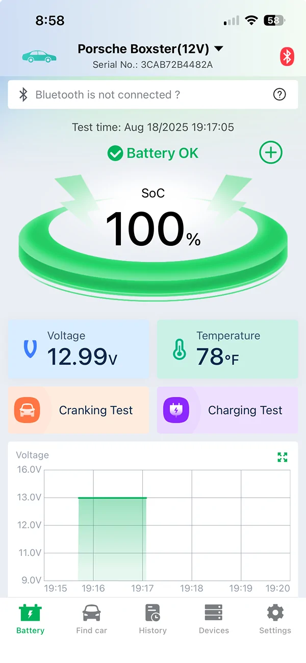

I installed an SAE pigtail on my Porsche and run the connector out near the wiper arm. I cut leads to correct length and crimped some ring terminals. That should work fine for the BS as well. I also installed an Ancel BM300 Pro battery monitor on my BS, 350Z, and Boxster. These use bluetooth to tell you the charge status of all your batteries. I use a Battery Minder to maintain my batteries and use an older version of this one: https://www.batterystuff.com/battery-restoration/12-volt/batteryminder-12v-2-4-8-amp-charger-maintainer-desulfator-and-lithium-charger-maintainer-128cec2.html . Leave your battery connected. There may be some debate on whether you should connect to the BS battery maintainer or directly to the battery posts. You want to leave some kind of reminder that the battery is being charged so that you do not accidentally back the BS out while the battery maintainer is connected.

It's always a good idea to disconnect the neg(-) battery cable first. The reason is that with it connected, almost any metal surface is electrically connected to the negative battery terminal (B-). So if a person has a wrench on B+ and accidentally touches anything metal with the other end of the wrench, it will create a direct short. A shorted 12V battery can produce thousands of amps.
I'd use #2 for the pos(+) connection. In post #3 you asked where it leads to. For purposes of connecting the maintainer that's irrelevant -- it is a direct connection to the pos(+) battery post.
For the neg(-) connection I like Major Kong's grounding lug, although I see what you mean about your chassis post being hex shaped. Actually, the lug would still provide plenty of contact area for the small amount of current from the battery maintainer.
One potential issue -- if the BS must be jump started, Ford recommends using that post. If the post is completely covered by the lug, that would be a problem.
If #5 in your photo is a solid ground that would be OK.
Great info! My limited experience, I always get sparks removing (B-) cable. Heck just backing out the chassis lug it throws sparks and the headlights flicker... I am trying to produce the least amount of disruption to the electrical system. So disconnect (B-) even though I get a small spark should be safest bet?
I can unscrew the ground lug though as I mentioned, just a quarter turn on that lug and it starts to spark and cause issues, it seems like while I have the battery disconnected, I should examine that area and try to get a better connection. Almost looked like Ford left too much paint under the lug. If that chassis connection is not constant and strong, eventually the vehicle will not start am I correct on that? That being the case I would prefer to ground the NOCO on it's own spot.
Appreciate the info
My experience is mostly with older cars -- aside from the Badlands the newest one we have is a 2002 WRX. There is no risk of damage from disconnecting the battery with older vehicles. AFAIK, it's the same with the BS, at least I haven't read anything to indicate otherwise.
You definitely want to disconnect the neg(-) cable first, and reconnect it last. That way, if you accidentally bridge from the pos(+) terminal/cable to any surrounding metal it will not create a short.
A small spark when disconnecting the battery is normal -- especially with a vehicle like the BS which turns on the lights and headlight fans (etc.) whenever a door is opened. If you pop the hood, and then close the driver's door and wait for everything to turn off before disconnecting the battery any spark should be much smaller, and maybe not noticeable.
Your instinct about not using the chassis ground is correct. It is critical. You can use it, and it should be fine, but it would be a potential failure point.
