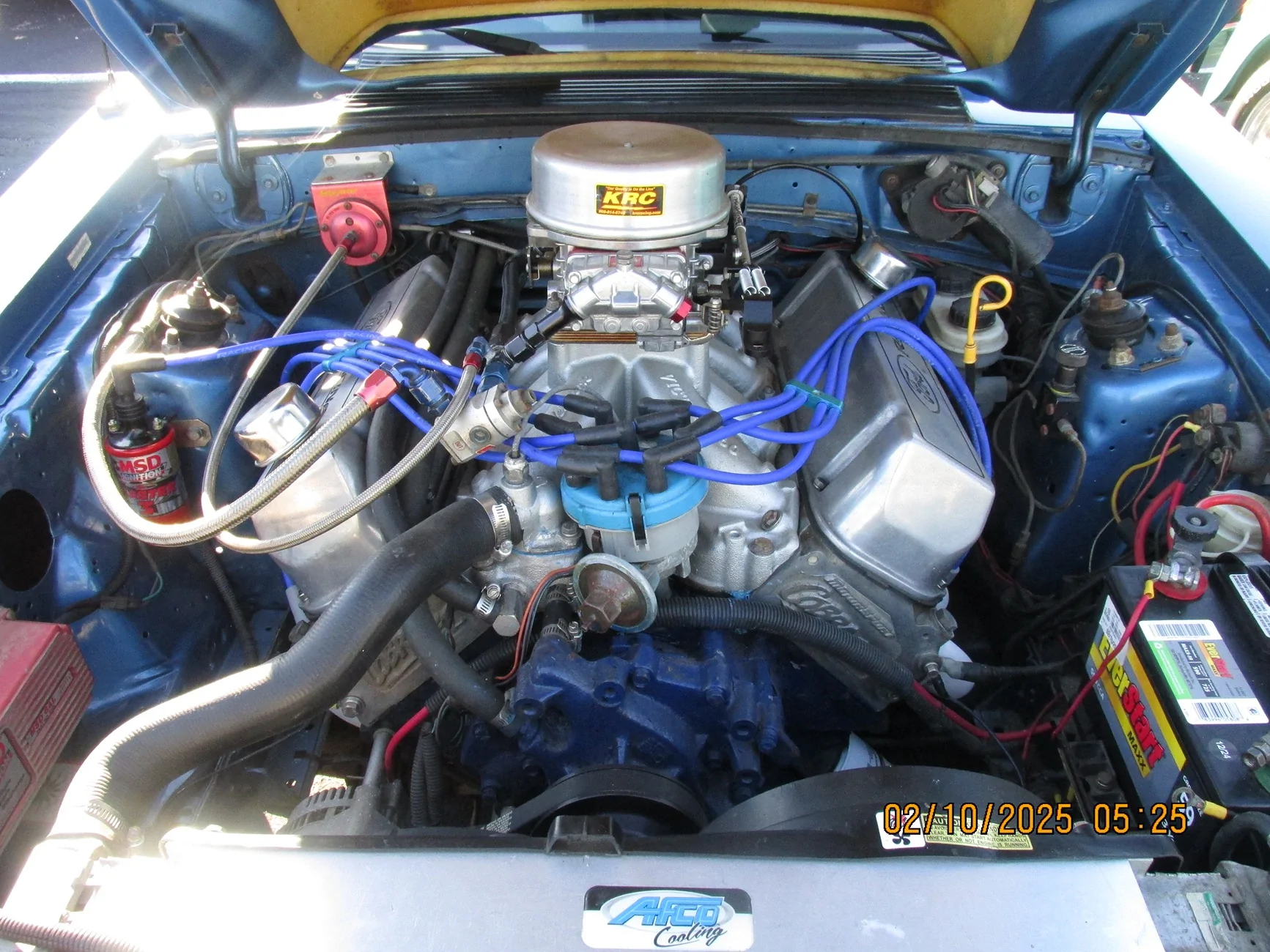

To much electronic crap on these newer vehicles and it sucks IMO you have to use a charger to keep the battery charged if you don't drive them often. I keep My Mustang in the garage that has a 466 BBF engine and just started it December 17th the last time I had it started was November 4th .I have a quick disconnect on the Positive Battery Cable and It's been real cold here In late November and early December and it cranked over and started fine on Dec 17th with no charger on it in between November 4th and December 17th..

Nice!
Those are some huge/tall valve covers. I'm used to Chevy big blocks.
It's not surprising that it started easily. Batteries do self-discharge when disconnected, but it's a low rate, especially when cold. From Google:
"At 30°F (-1°C), a 12V lead-acid battery's self-discharge rate is significantly lower than at room temperature (e.g., 68°F), slowing to roughly 1-2% per month, but its usable capacity also drops, potentially losing 20-30% of its power in the cold, so while it self-discharges slowly, it also performs poorly, requiring charging if stored long-term to prevent sulfation."
So if the battery has more than enough CCA, it could sit for quite a while and still start the engine.

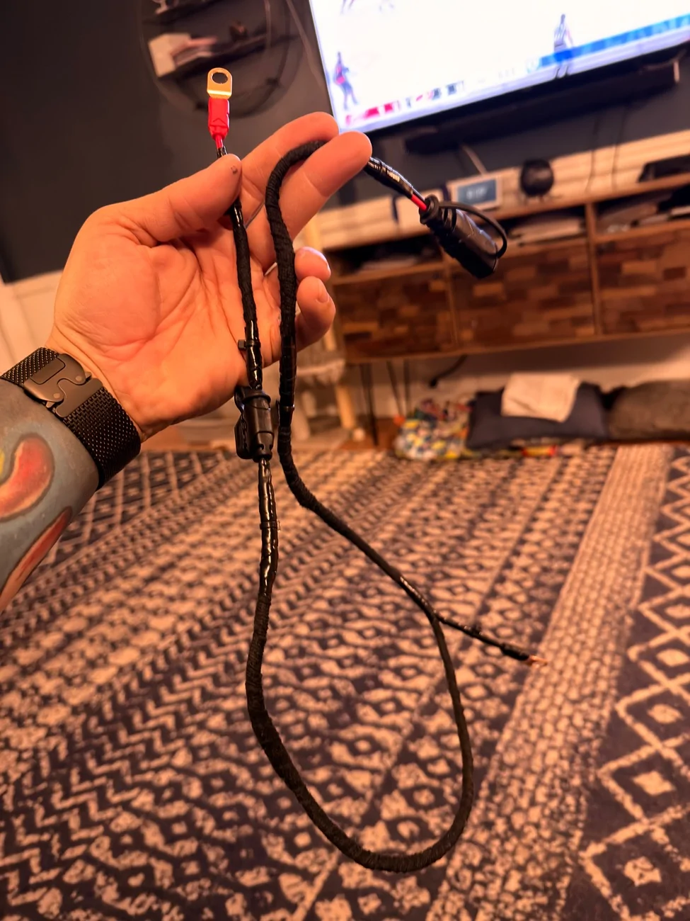

I actually bought a tender a month or so ago, and just got around to installing it tonight.
I took the side that connects to the battery, modified the positive wire length, so it’s a direct, hidden fit, wrapped the whole thing in cloth tape and electric tape on the ends, and then installed it.

It’s the perfect spot. When not in use, it goes behind the fender where the excess wiring for my ditch lights is hiding. It has stayed nice and dry in there so far in the snowy weather we’ve had, so, it should be the perfect spot for when not in use.
