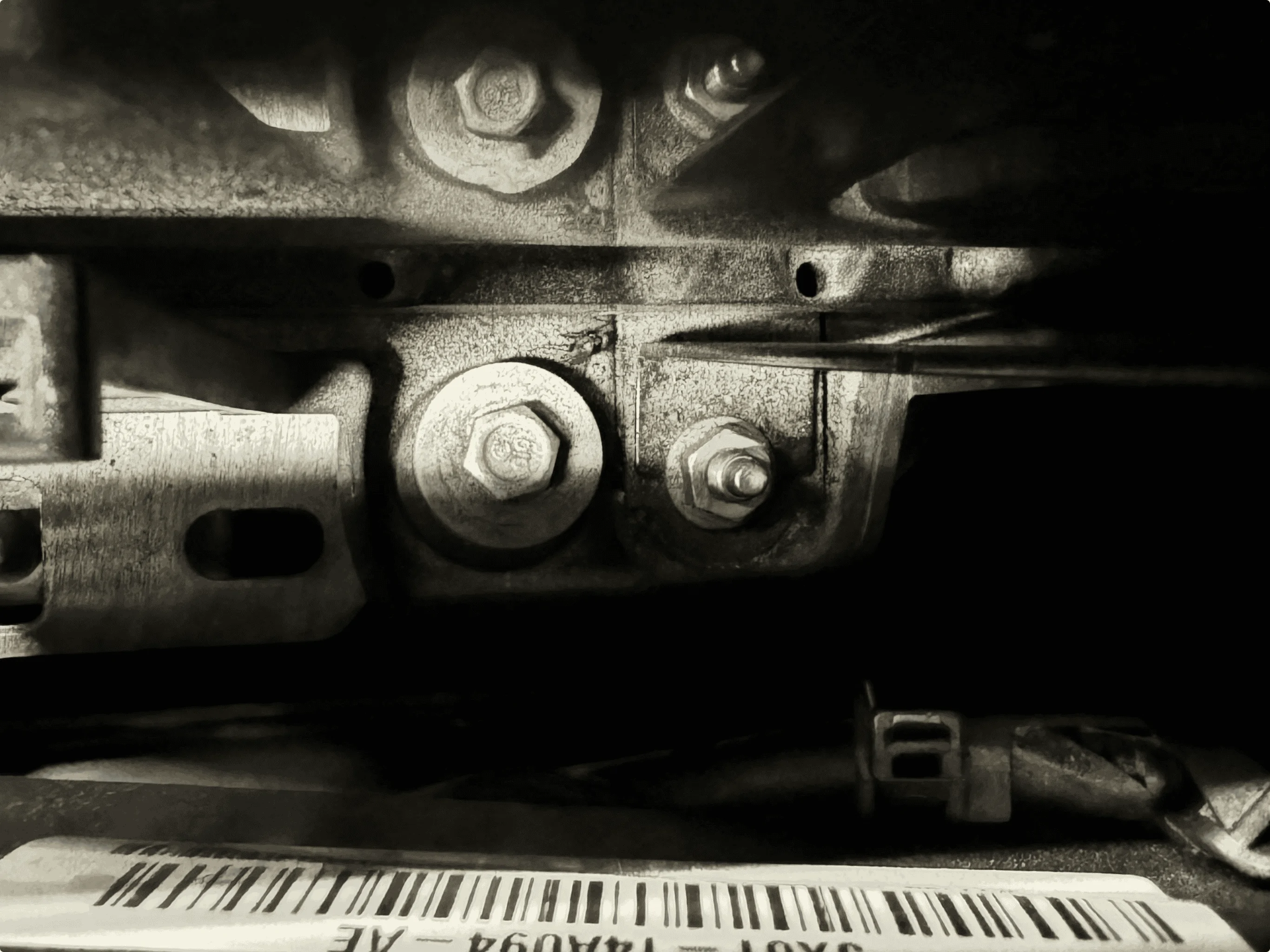

As a reference, we are both in CO, so maybe relevant. My BS has just under 15k miles and 2 winters, though not a lot of snow driving.
Ford Bronco Sport Battery hold down bolts corrosion 1710200349554
A little dirt there but I don’t see any corrosion.

I'm at a little over 13k and two winters also. I think I'm lucky to get a bad install or bad hardware. Probably bad hardware.
