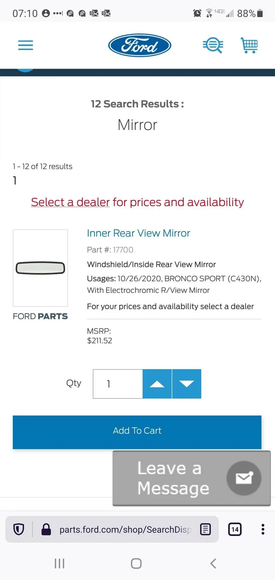

$210 for the auto dim mirror from ford. That doesn't seem to bad. I thought it was in the BB package, but I don't see it in the order guide.
There are many standard features in outer banks trim and not available on badlands w/o BL package.
Ford Bronco Sport Auto Dimming Rear View Mirror Screenshot_20210508-071012_Firefox
