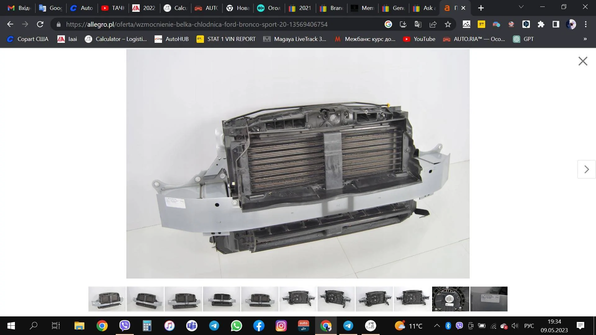

this internet store claims the radiator and the intercooler fit 1.5L and 2.0L bronco sports but you could be correct that parts for Escape are interchangeable ( I don’t know that )
Ford Bronco Sport Are the 1.5 vs. 2.0 radiators the same? 1686330315481
Ford Bronco Sport Are the 1.5 vs. 2.0 radiators the same? 1686330339111
Ford Bronco Sport Are the 1.5 vs. 2.0 radiators the same? 1686330358065
