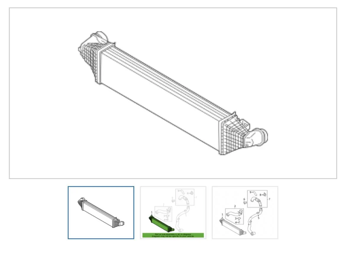

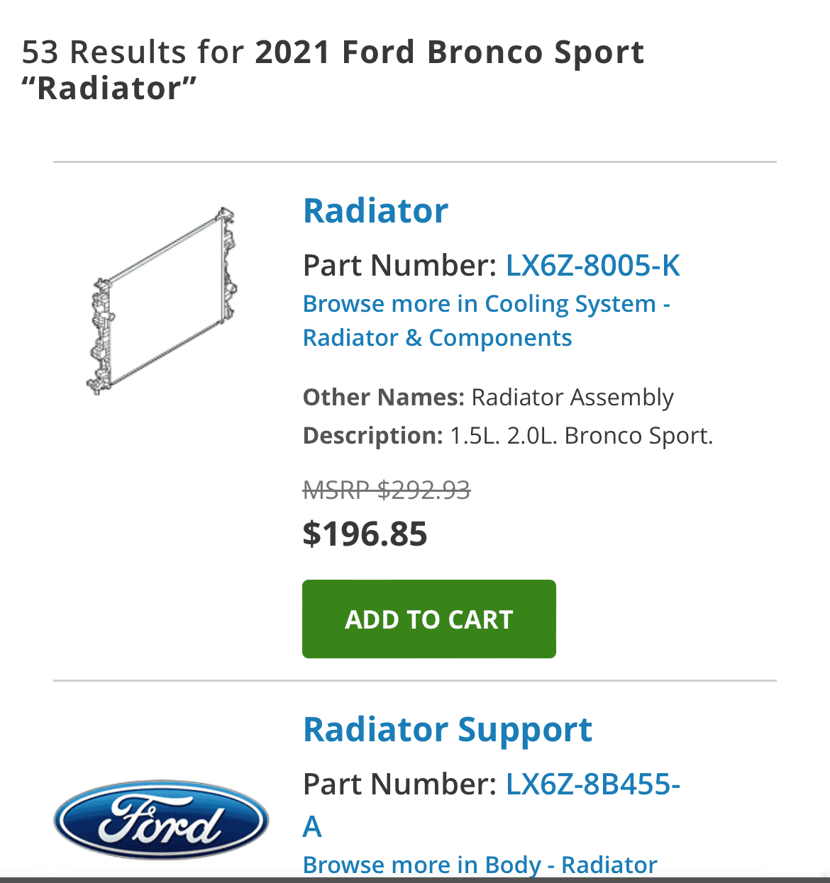

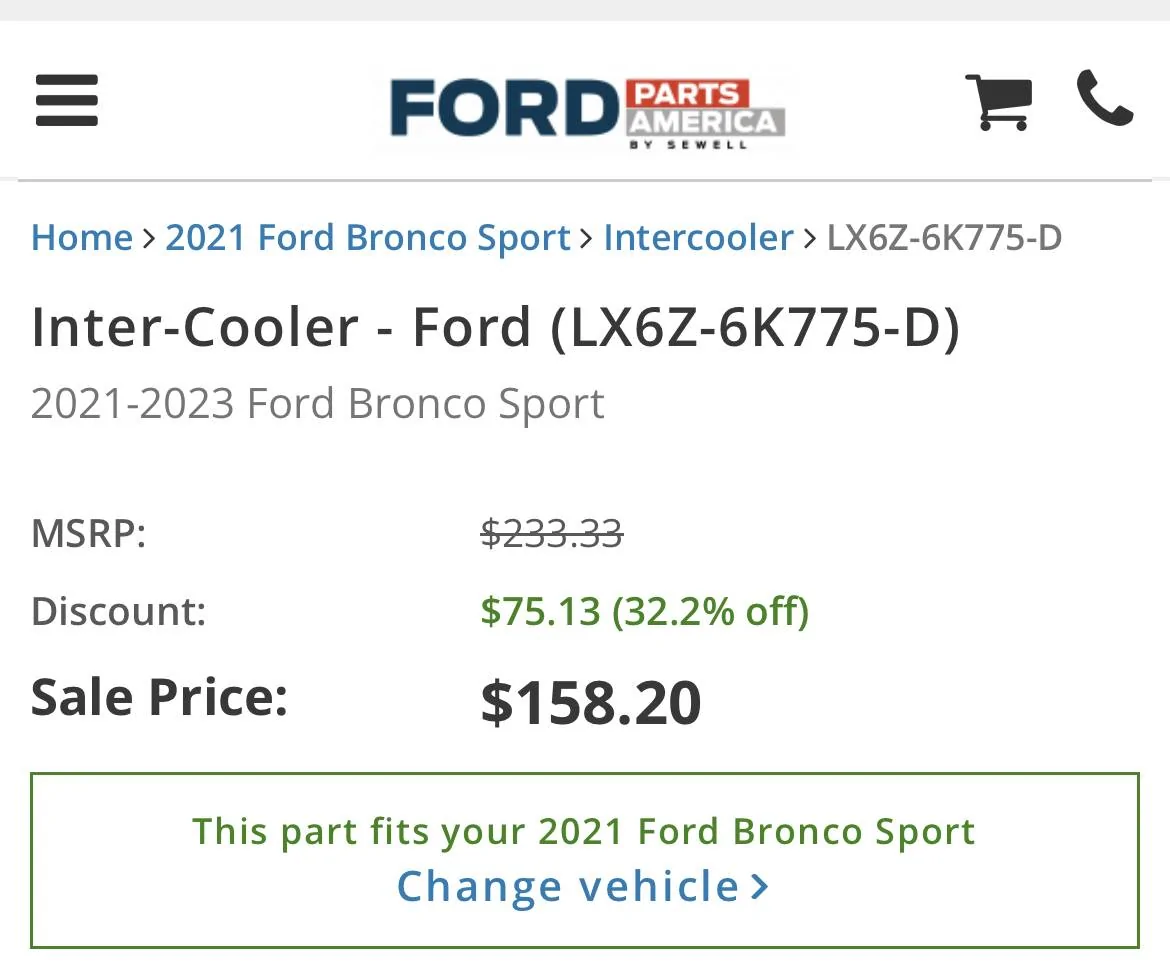

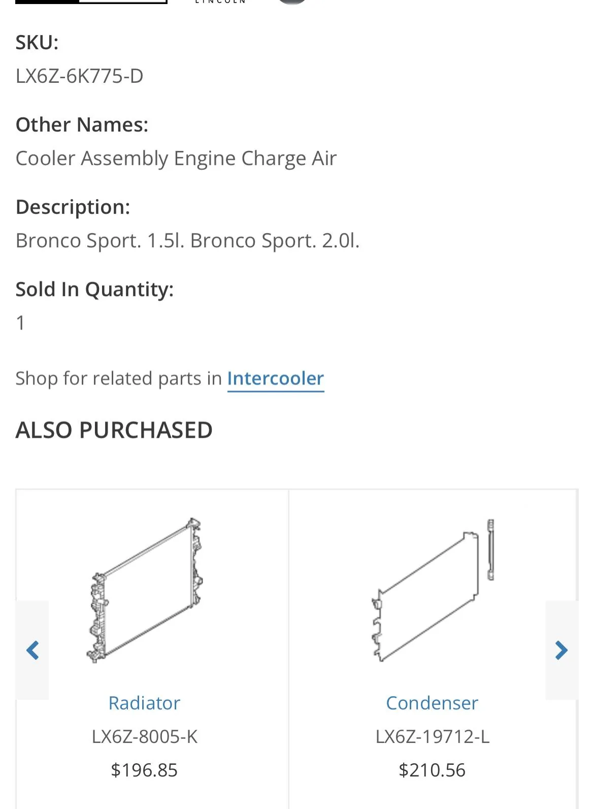

this internet store claims the radiator and the intercooler fit 1.5L and 2.0L bronco sports but you could be correct that parts for Escape are interchangeable ( I don’t know that )
